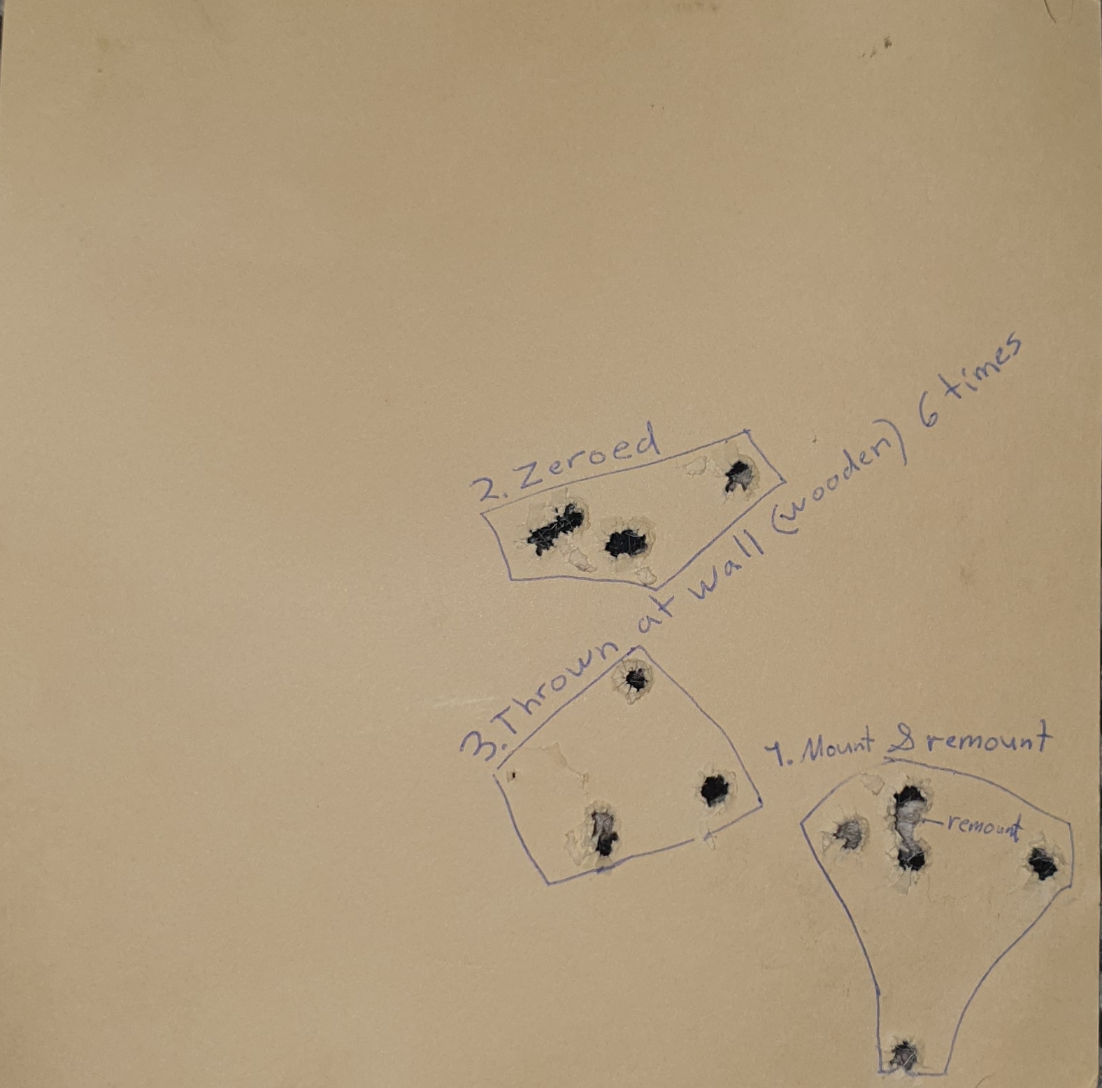

    Hi fellas.
    I noticed that my Aimpoint had lost zero. I had not used it for a while but figured that it had dropped few times since last use. At least once rolled onto concrete. It also attaches by QD made by ADM.
    So I decided to test and conclude what is behind the zero change.
    1. Zero test and remount test. Zero was offset 2.4"/6cm in elevation and 1.2"/3cm in windage.)
    2. Then I remounted the T2 and shot once. It landed next to a bullethole from the previous group.
    3. I rezeroed T2 and shot 4. Nice group, well centered.
    4. I threw the optic lightly at a wooden wall of the range hut maybe 6 times, first 2 times it dropped to snowy gravel, the rest of times it bounced back to my hands.
    5. I tested zero. It had changed by 1.6"/4cm in elevation.
    Below the target with short group identifications.
    I am slightly disappointed with the T2 losing zero with few bumbs, I really did not use much force on it. And I know my glass optic takes some beating.
    That's it.

    Yes! For practical use it fulfills its purpose even with slight offset, but I'd like to be able to trust it 100%, since it is a quality piece. But I get it, some other sights would not even work after being thrown around.
    It is just that I very much value being able to make cold bore shots. I do not think a regular visit at the range should include a rezero. I go go range many times a week, I rather not do some menial task to start the actual training.
    Also, when comparing training session data; a changing zero makes it a little harder.

    100m.
    The average groups with this ammo lot (PMC Bronze FMJ) are usually around 1.2-1.5moa. I think the groups are distinct enough to clearly tell a story that something changed inside the T2.
    Remounting it changed nothing, the 1 shot done after it landed to the same group. I only did 1 shot merely to confirm what I know as usually I have not had my zero change upon remounting, so I have practically tested it already.
    I will ofc mount it pressing forward in the future, but it seems it clamps well enough that so far it has not moved during firing.

    My premise is that if mounted correctly and with enough torque, there really should not be enough zero change to notice it.
    I know my fundamentals are not to blame, my match ammo targets (bought 500 rnds of Sako ammo and had to test and chrono it) that day got 0.65 and 0.89moa. So throwing a group 1.4moa away from POA would require my fundamentals to be completely gone.
    I shot this test with bulk but the groups still were 1.06moa (pre-zero), 1.43moa(remount test) and 0.9moa(after throwing it to a wall), resulting in 1.13moa average.
