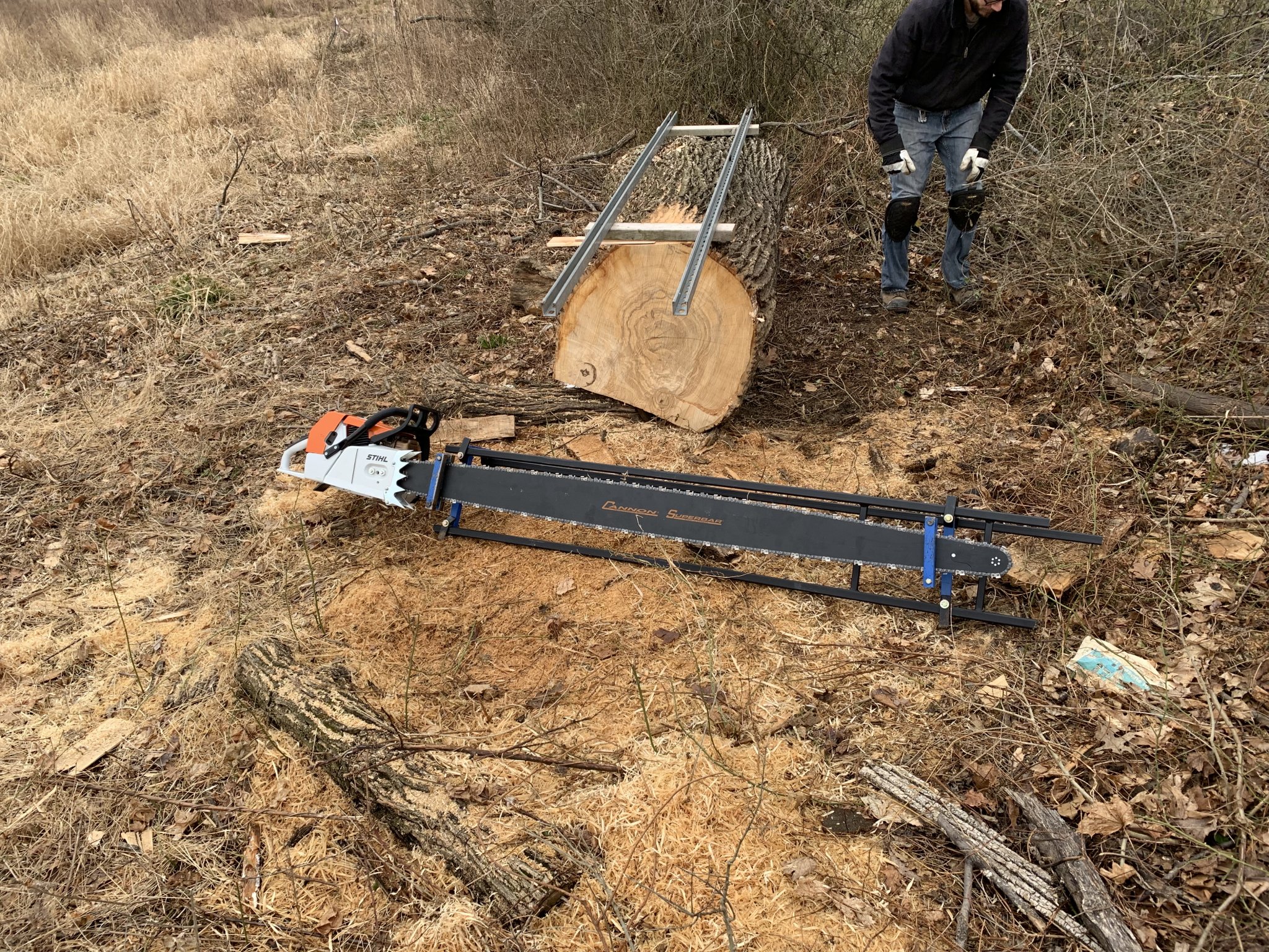

    I have an Alaskan Chain Saw mill and like it for my uses. I am turning white pine trees that fall in storms into usable lumber for a variety of projects. The more accurate the dimensions you require will increase your level of effort. I cut these very large pines into 8' sections and they are a beast for me (55) to move around in the littered woods.
    To run it correctly you need a powerful chainsaw, longer bar than you might think, and multiple ripping chains.
    The mill "eats up" a couple inches of the bar at each end due to how you attach it. So you need a longer bar. In order to run the saw fast enough around that longer bar you need a powerful motor.
    • Also you will need a sharpener of some sort. I sharpen my chains everyday after I am done so I keep 3 or 4 chains ready at all times.
    • I use an old ladder section as the guide for my first cut and it works very well.
    • I bought some bright orange wedges to keep the cut open as I move along
    • I use a garden cart or my truck as my mobile workbench for all the tools I use.
    • Bring a square and get a few magic markers to aid in scribing the ends
    If I have more thoughts I will come back and add them or feel free to ask away. the mill works very well for what I needed and has already paid for itself AND the new saw I told the wife I needed.... lol

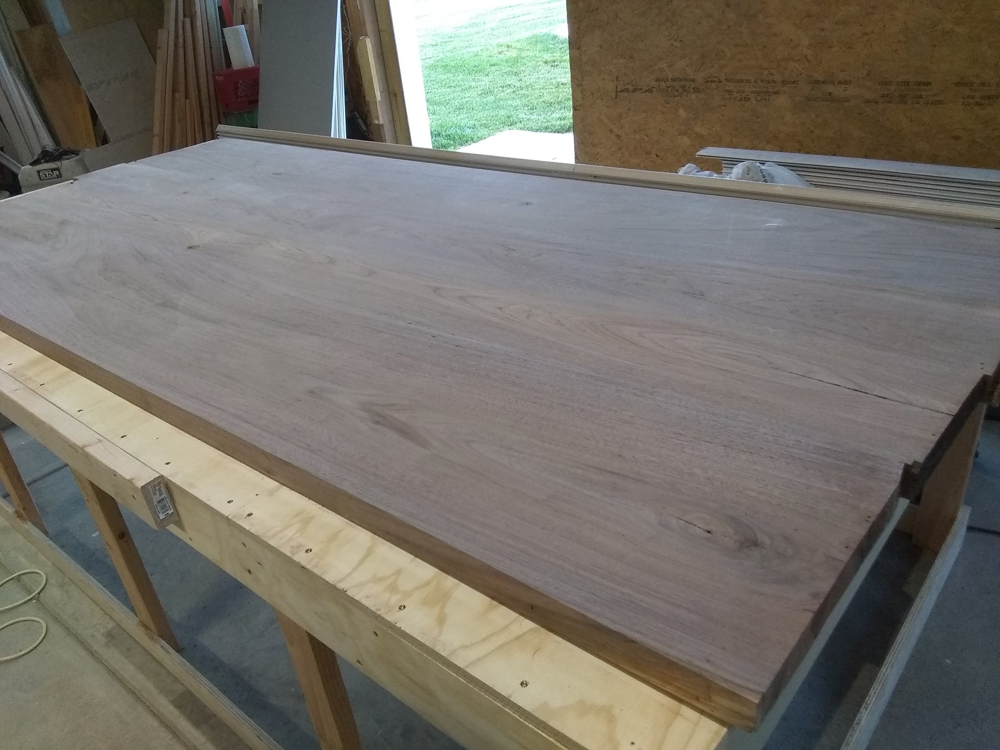

    If it were me, I would have them kiln dried. I just did a walnut table top this summer, about 55"x114" (finished), seats 10. It was kiln dried, still flat, no checks. Kiln drying not that expensive.
    The walnut 6x6 (not shown) that's underneath in the steel frame is checked and has a slight twist. It's air dried.+
    I used a Woodpecker's extended slab flattening mill pro and a router to flatten it. Flattening this monster was easy, about 2 hours.
    While you don't need a planer, I have a 20" w/spiral cutterhead one for most surfacing tasks.

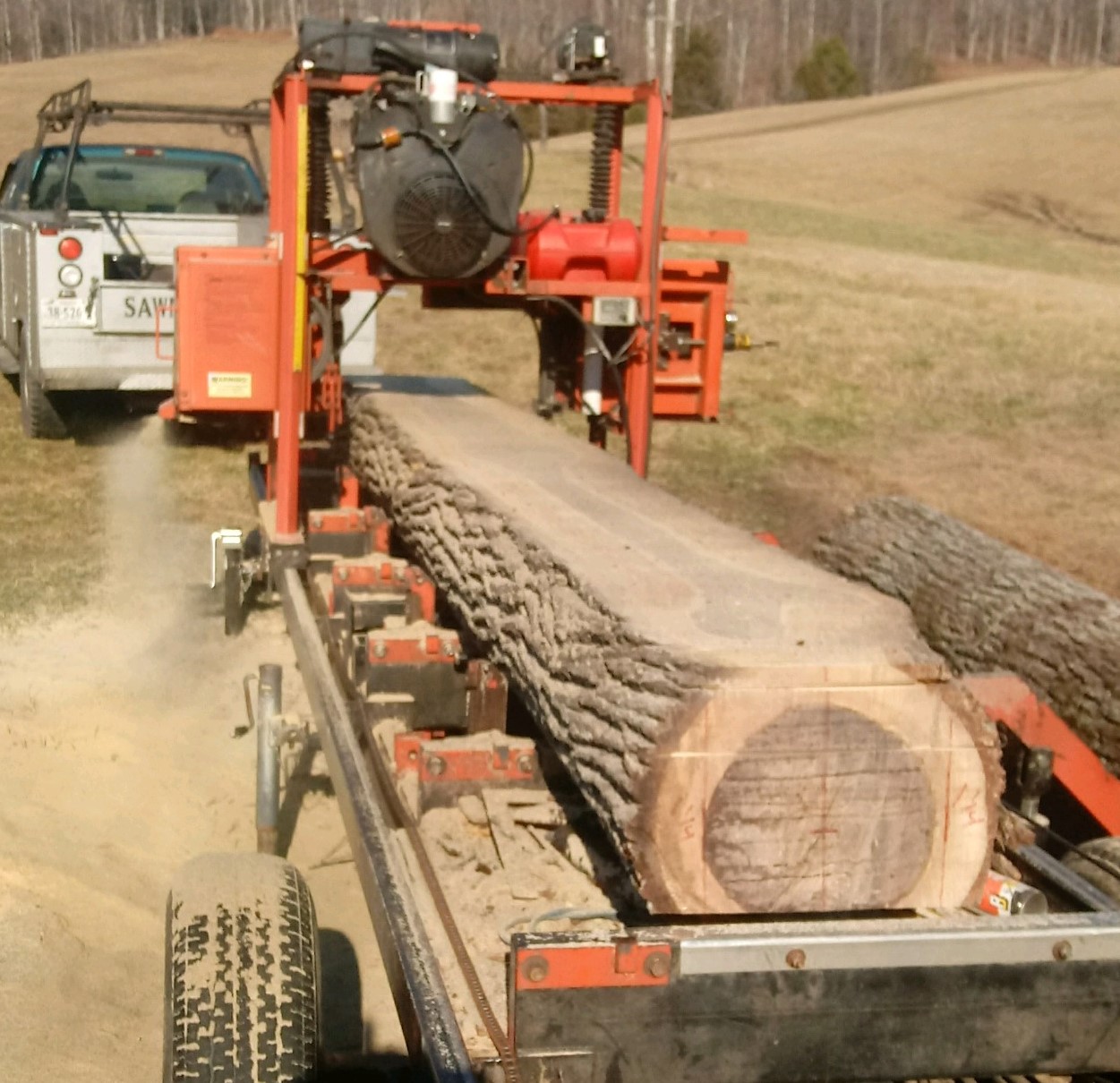

    I’ve milled my fair share of logs... a few above ^^^
    What diameter logs are they? Anything bigger than 30” diameter I’d recommend an ms880 or 3120xp.
    Someone above posted that buying a mill and saw is cheaper than having them cut... that’s absolutely wrong, I have well over $4k in saw, bar, mill, chains, cant hooks etc...
    Id say if you have interest in milling lumber more than just this once, buy a mill... if not... hire it out.

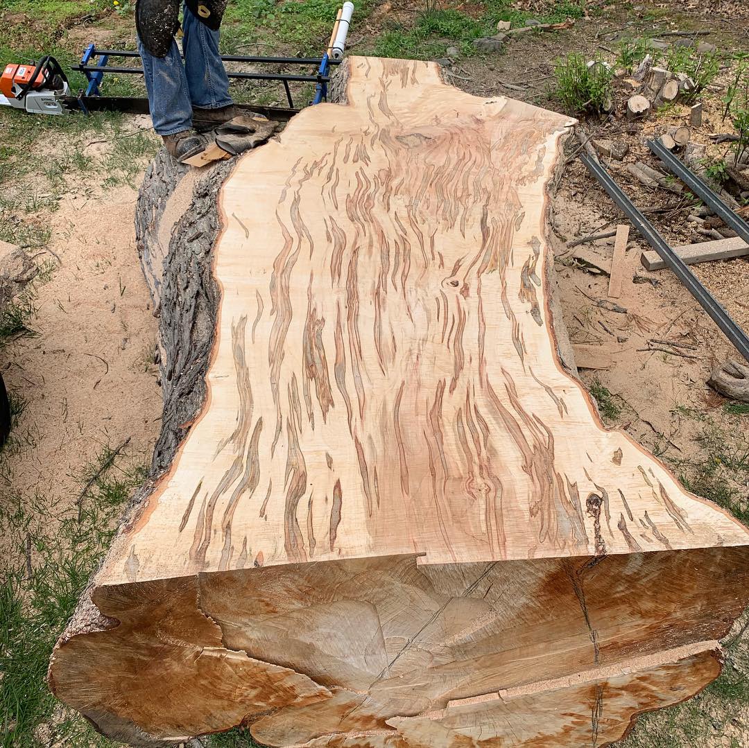

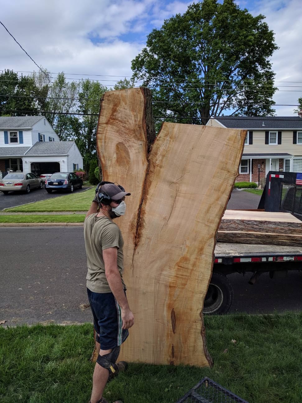

    Is that what we used to call 'Swamp Maple'? Beautiful figuring and color once it dries if you can keep it from cracking.

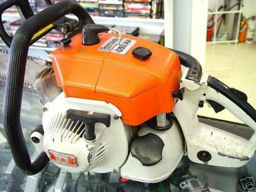

    Whats the chain saw in the photo. First Stihl I ever ran was an .090 but I dont think they make them any longer. It was about like picking up a small motorcycle.
    We call it Ambrosia Maple in PA.

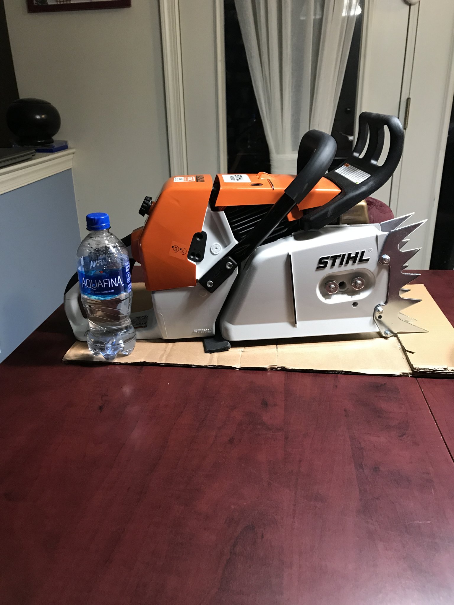

    Saw in the first pic is an ms880. 122cc of 2 stroke power... it’s like holding a Honda cr125 in your hands... people don’t realize how big it really is until I show them this picture...

    Theyre beasts alright. LOL. The .090 had a decompression valve so you wouldnt break your wrist starting it.
    Reactions: 300zx_tt
    This is the one we used to run, you can see the decompression button in the front left. I never re member dogging it no matter how big the tree. That might change cutting slabs in a mill set up.
