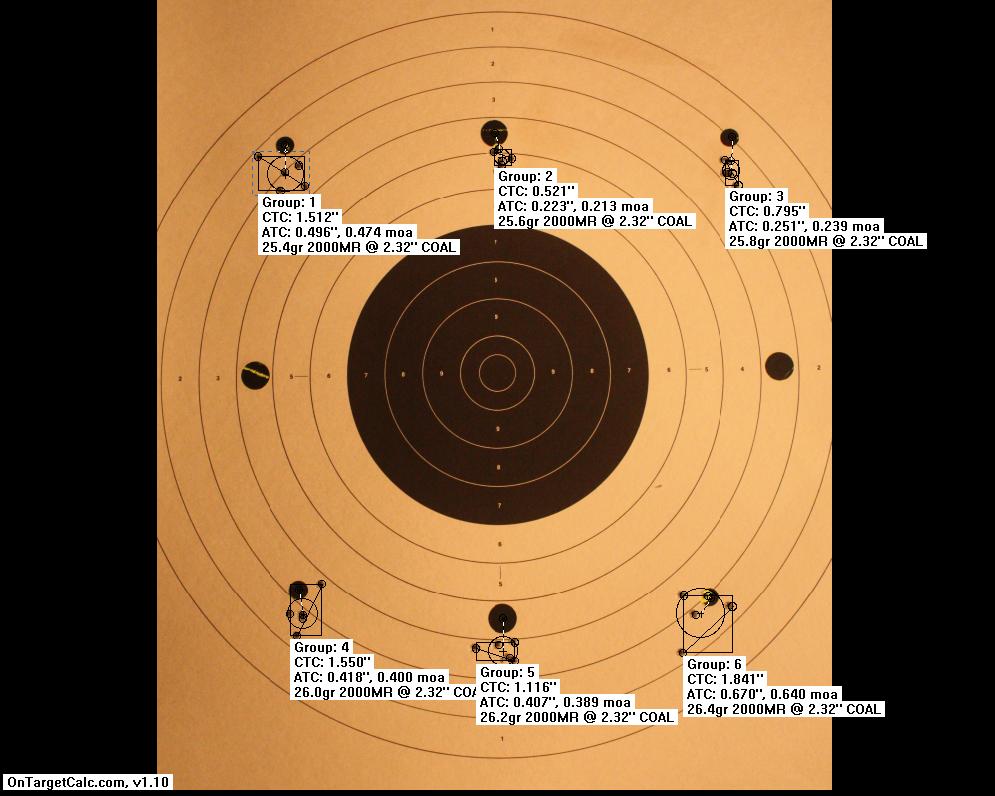

    I did a little load testing today with 2000mr and 77 smks, trying to get an idea of how it does in the ar15.
    Turns out it works very well, and I was actually able to get lower es/sd than my current varget load, and put some very decent groups together. Im still at the low end of pressure and velocity (2600 fps) but plan on working up to 2800+ soon.
    These are the last two groups at 200 yards at top and center. Prone / sling / iron sights. Just a basic woa uppered ar with a geissele nm trigger.
    Anyone else shooting 2000mr in their semi autos?

    Here's my OCW using 75gr Hornady HPBT, CCI Small Rifle Primers, and Speer Brass out of a 22" Wylde 1:8 Twist AR15.
    Group #1
    Shot Speed
    1 2680 ft/sec
    2 2656 ft/sec
    3 2660 ft/sec
    4 2634 ft/sec
    5 2679 ft/sec
    Min 2634 ft/sec
    Avg 2662 ft/sec
    ES 28 ft/sec
    Max 2680 ft/sec
    S-D 19 ft/sec
    Group #2
    Shot Speed
    1 2682 ft/sec
    2 2651 ft/sec
    3 2698 ft/sec
    4 2678 ft/sec
    5 2701 ft/sec
    Min 2651 ft/sec
    Avg 2682 ft/sec
    ES 31 ft/sec
    Max 2701 ft/sec
    S-D 20 ft/sec
    Group #3
    Shot Speed
    1 2699 ft/sec
    2 2711 ft/sec
    3 2710 ft/sec
    4 2702 ft/sec
    5 2729 ft/sec
    Min 2699 ft/sec
    Avg 2710 ft/sec
    ES 11 ft/sec
    Max 2729 ft/sec
    S-D 12 ft/sec
    Group #4
    Shot Speed
    1 2711 ft/sec
    2 2759 ft/sec
    3 2720 ft/sec
    4 2739 ft/sec
    5 2718 ft/sec
    Min 2711 ft/sec
    Avg 2729 ft/sec
    ES 18 ft/sec
    Max 2759 ft/sec
    S-D 20 ft/sec
    Group #5
    Shot Speed
    1 2754 ft/sec
    2 2754 ft/sec
    3 2739 ft/sec
    4 2753 ft/sec
    5 2754 ft/sec
    Min 2739 ft/sec
    Avg 2751 ft/sec
    ES 12 ft/sec
    Max 2754 ft/sec
    S-D 7 ft/sec
    Group #6
    Shot Speed
    1 2779 ft/sec
    2 2779 ft/sec
    3 2793 ft/sec
    4 2756 ft/sec
    5 2801 ft/sec
    Min 2756 ft/sec
    Avg 2782 ft/sec
    ES 26 ft/sec
    Max 2801 ft/sec
    S-D 17 ft/sec
