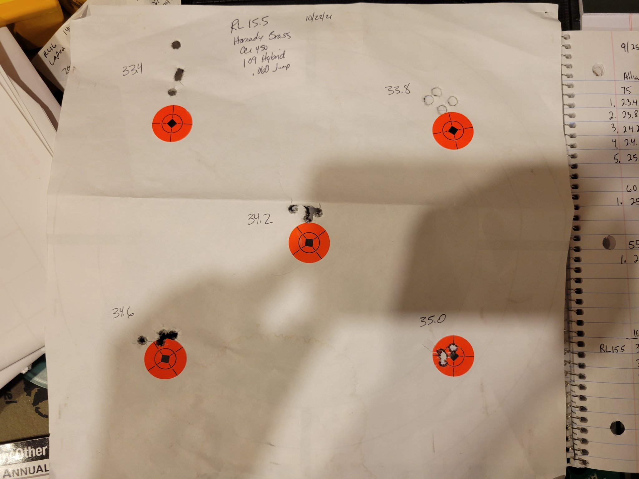

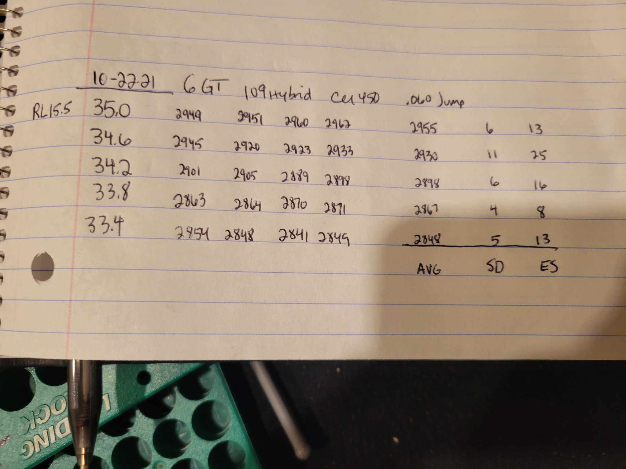

@briang7511 Did you ever get a chance to try it in 6gt? Im working some loads up today for my 6gt and RL15.5
After you get some data, please add it to the 6GT reloading thread, 15.5 certainly looks like it would be about perfect for the GT
