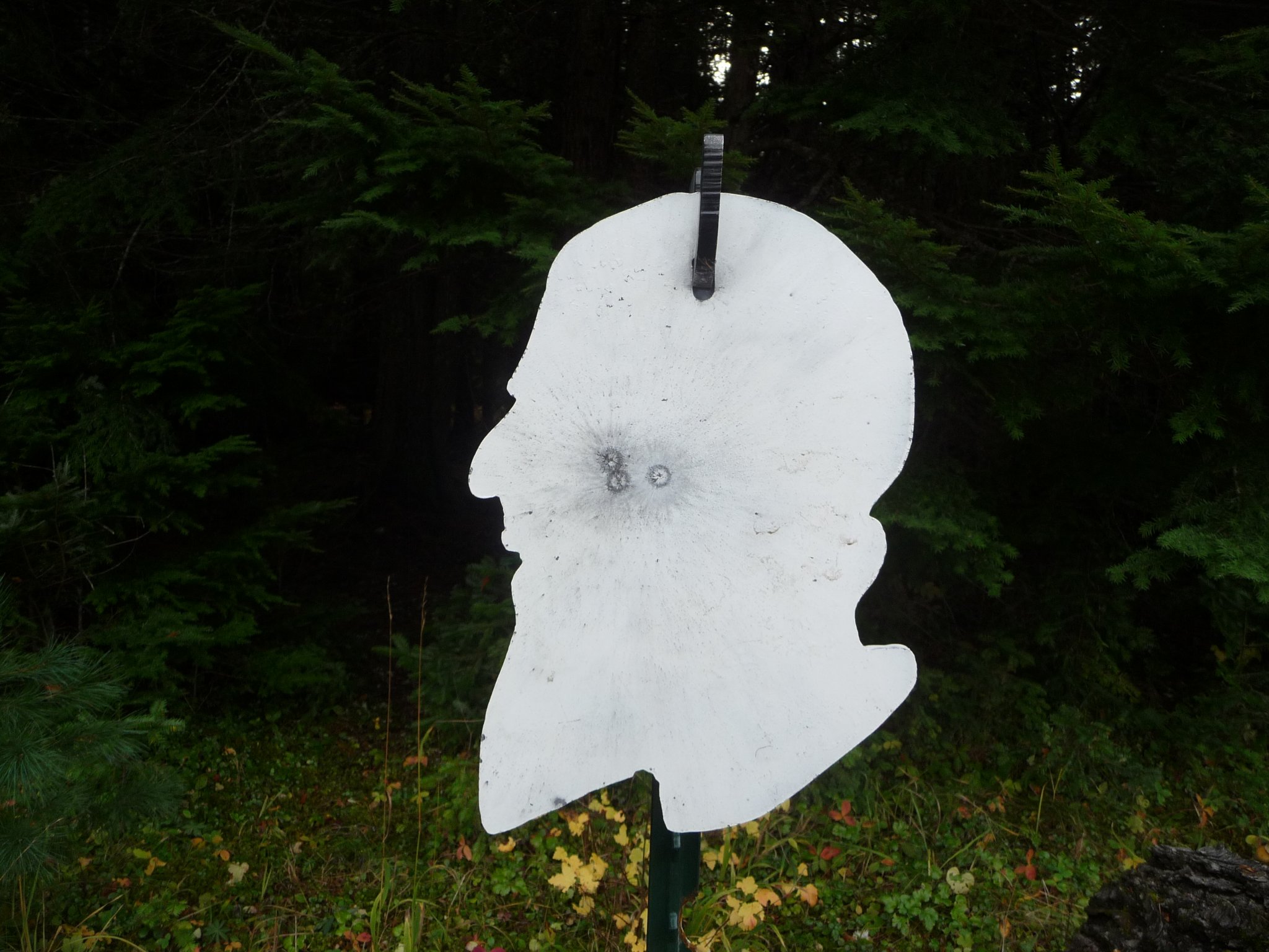

Three shots prone @ 377 yards today (bare barrel i.e. no brake, or can.)
