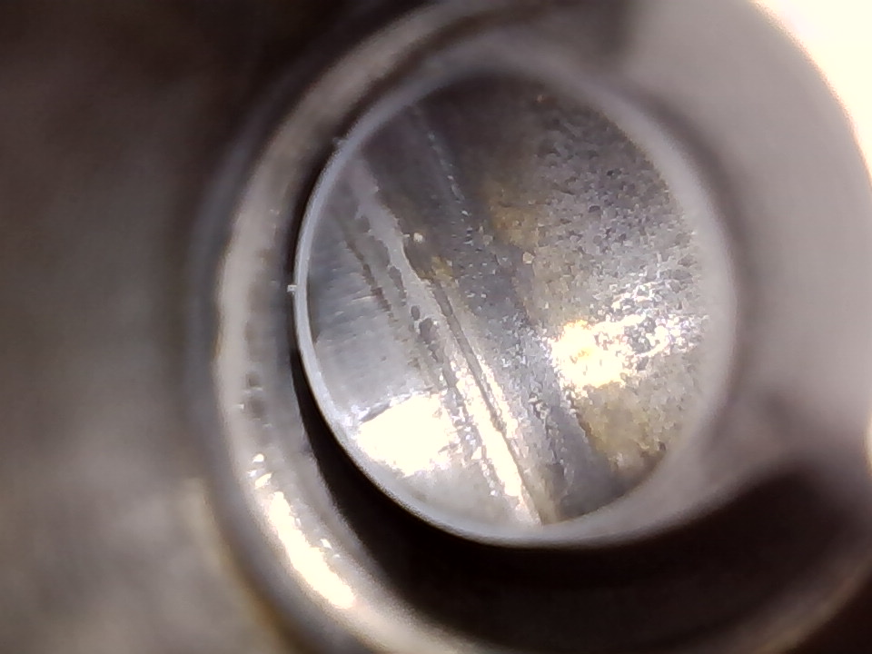

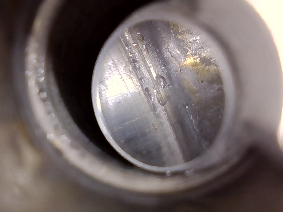

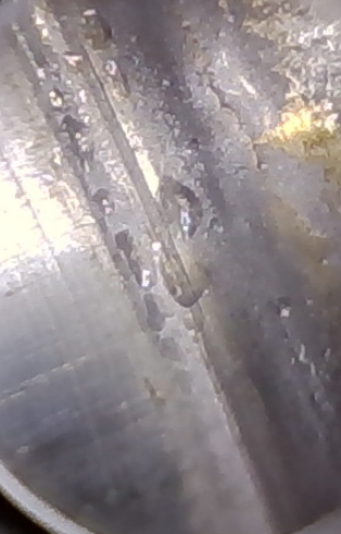

Rifle initially shot great, multiple groups around .2 moa. I noticed heavy bolt lift intermittently, primarily shooting the 39.0 h4350 and eldm combo listed above, but didn’t know what to make of it and it kept shooting well. I scoped it and noticed what I thought was carbon ring initially, cleaned it out, and the rifle kept shooting well. Only had about 30 rounds through it after a good cleaning and scope to make sure the ring was gone, when I had very heavy lift shooting 14 rounds of the 40.0gr eldx load above, which seemed to be getting worse the longer I shot.

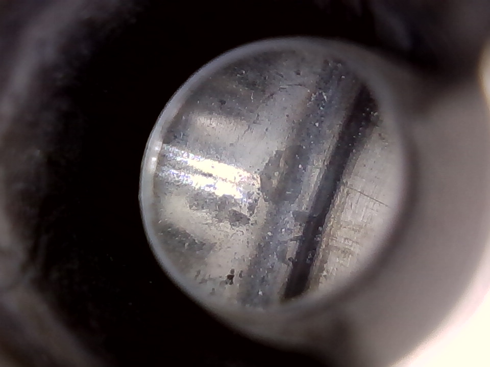

I scoped it again after I got home and included pictures of that in this post. It looks like a lot of carbon ring to me, which I don’t understand for only about 30 rounds of 6.5cm.

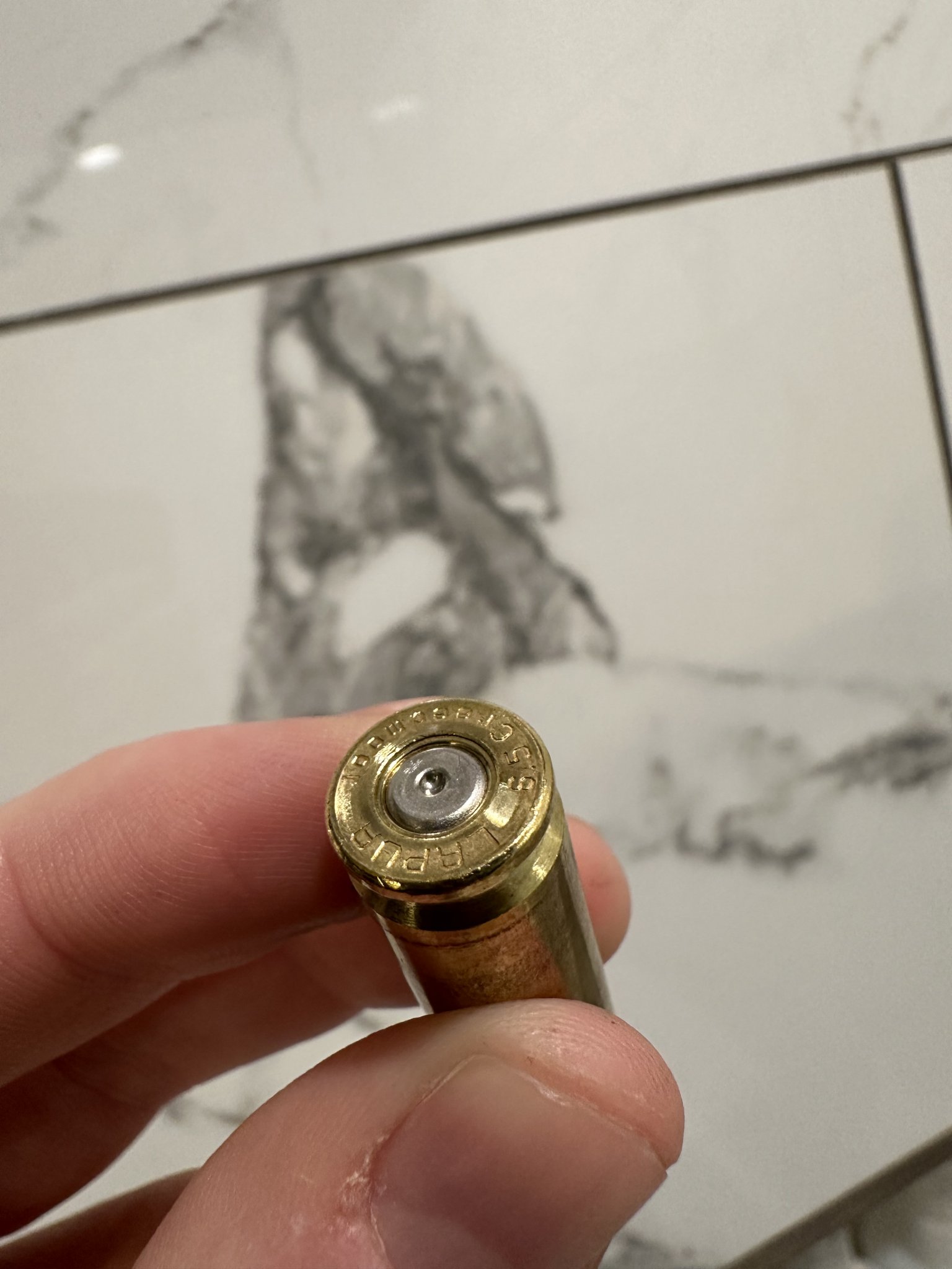

Is that lead deposits in the second picture?

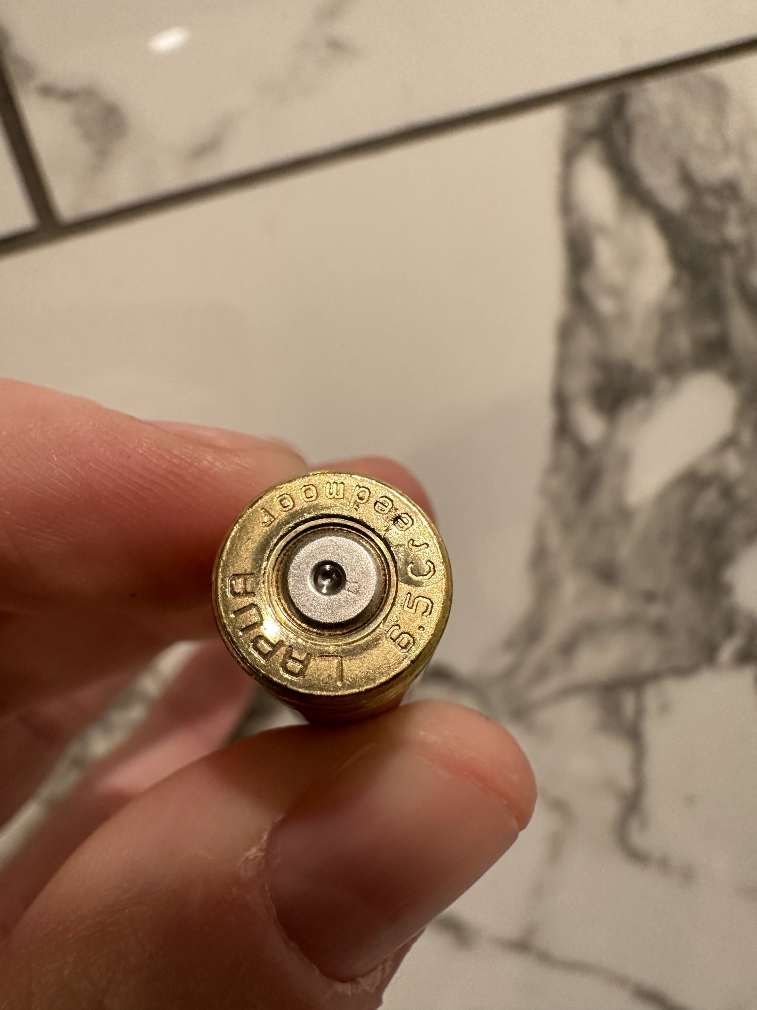

Not sure if those loads are hot but could be virgin brass expanding. The ejector mark is mainly from the ejector spring so heavy.
Seems like false pressure since the primers look ok.

I would guess that this is lead deposits accumulating at the mouth of the chamber and as you shoot more and more the build up may not be allowing the brass to expand at the case mouth and causing the heavy bolt lift. Or it could be the lead at the mouth of the brass that is not allowing the case to come out freely which cause the heavy bolt lift. Of course this is just a major assumption. Are you getting any copper shavings as you seat the bullet? Are all the case mouths chamfered smoothly before seating the bullet? Is the chamber smooth and no tiny burrs scrapping the bullet?

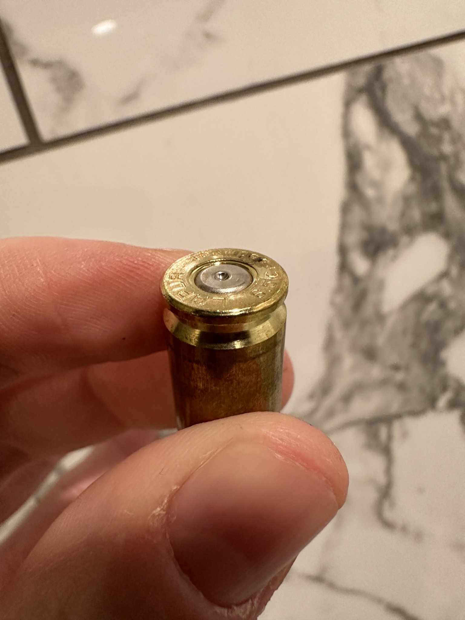

Nothing like that, brass looks good besides the ejector marks which I can feel with a fingernail.
As per your primers, you do not appear to have high chamber/case pressure (and the loads are not hot), but the fired cases do appear to be backing harder into the boltface than is normal (or else your headspacing of the bolt is off - do you have a hard bolt on closing before firing?). Cases can back hard into the boltface if the cases have even a thin layer of lube and there is no adhesion of brass to the sidewalls of the chamber and pressure is fully directed backwards. (Lubing cases to move them back and blow the shoulders out forward is a technique often used to properly fireform some wildcat cases from the parent cases.) As has been suggested, thoroughly dry out/clean the chamber and fully remove any lube from the cases. Also, as has been suggested, make sure that subsequent to trimming (new Lapua cases do not need trimming) that careful chamfering of the inside and outside of the case mouth is performed, with complete removal of small bits of removed brass (I use compressed air). Hopefully this might help. Your images show poor focus - can you adjust your borescope to get improved images?

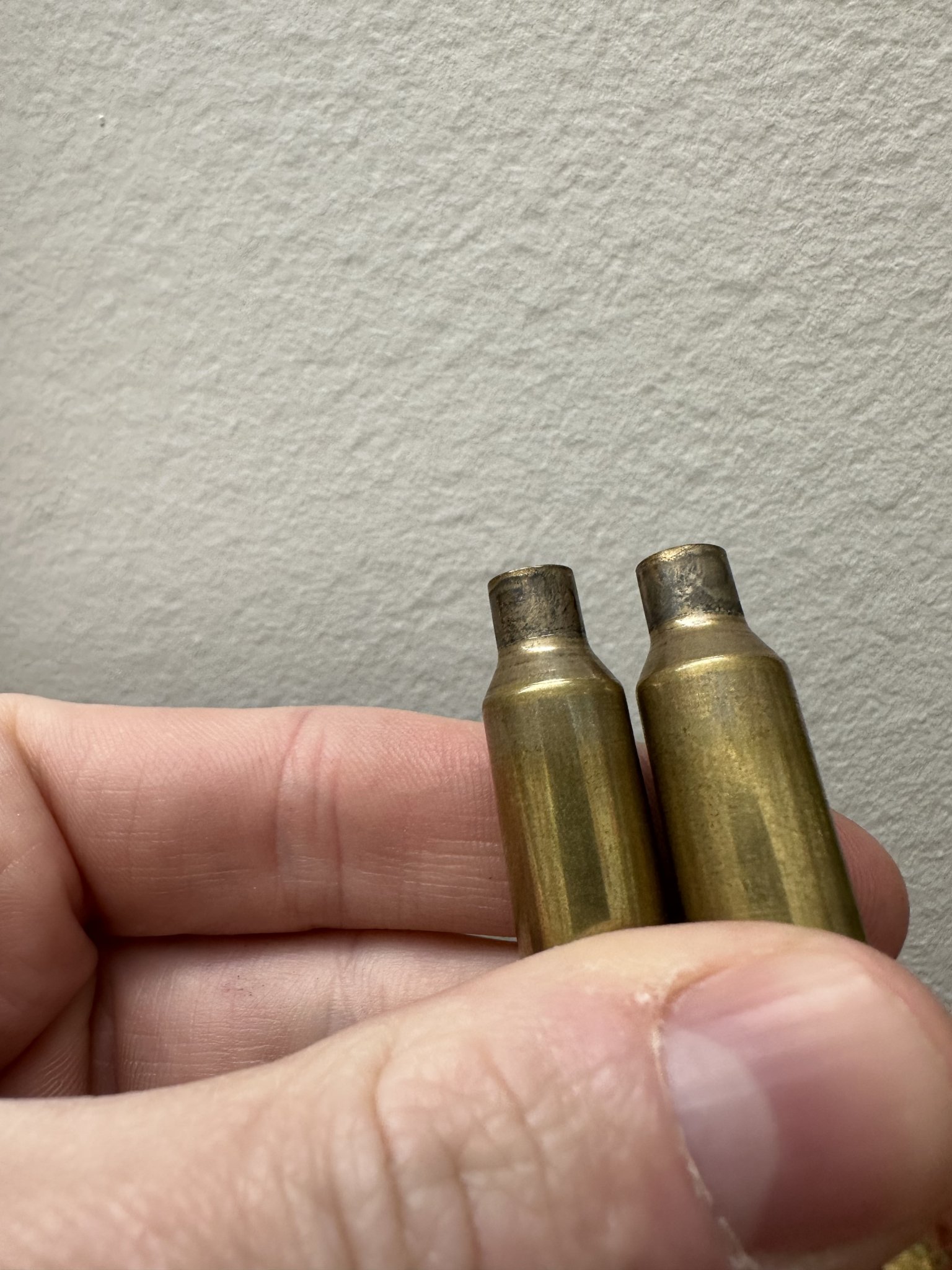

Are the outside of your case necks showing a lot of carbon? To me it looks like you are building carbon in the chamber where the neck should be sealing. If so you are losing the space needed for the neck to expand and release the bullet as you shoot more rounds.

Here’s a close up of a couple necks where I saw the issue. It does look like there’s a fair bit of carbon to me
Reactions: mettee
Necks lool fine to me.

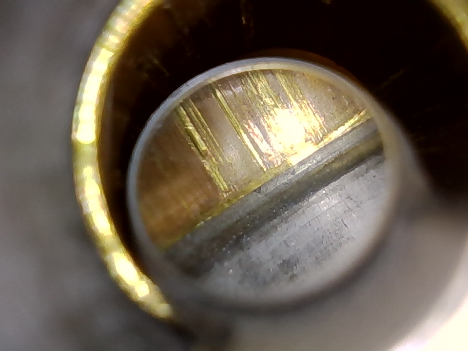

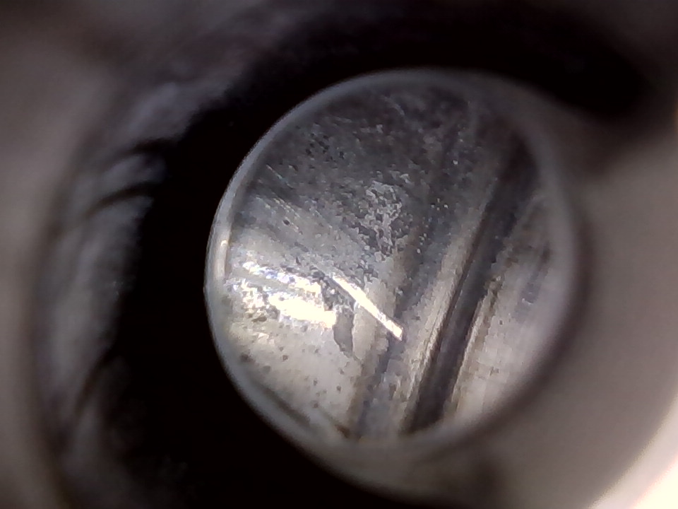

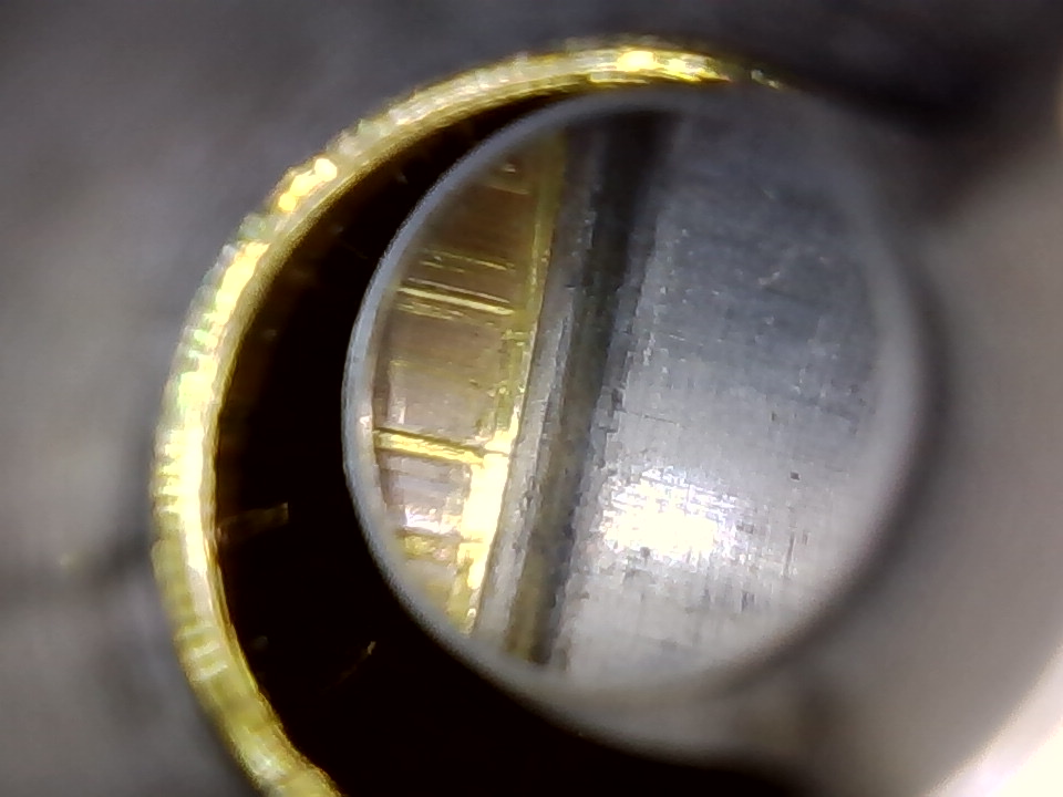

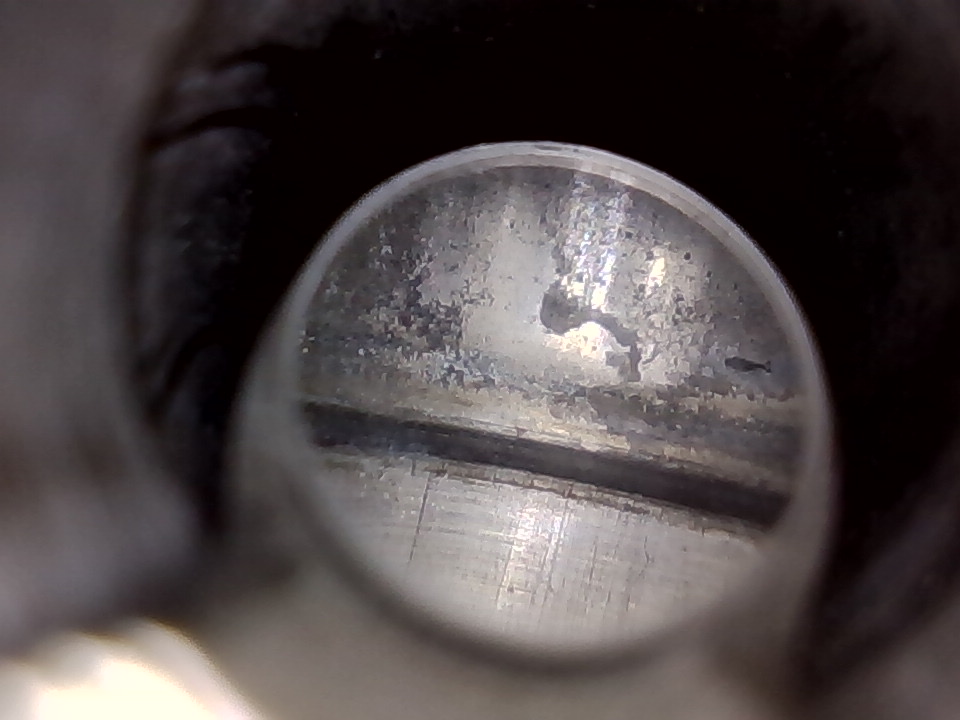

I appreciate the replies. I’ll attach some hopefully better board scope pictures. I adjusted the lighting to try to get better quality images. I also disassembled one of these same rounds that I was having trouble with, inserted the brass into the chamber with a closed bolt, and took some images from the muzzle end.
Bolt close might be a little more difficult than it should be, I’m not 100% certain on that. I did just notice that using the same comparator, my headspace measurement was 1.481-1.482 on the new Lapua brass, and was consistently 1.4845 after one firing. I just measured some of the pieces that showed ejector marks and heavy bolt left and found measurements from 1.4865-1.4875, and the first shot which did not show any of these signs measured 1.4845 like a lot of the previous rounds which did not have heavy bolt lift. So there seems to be some variance in headspace, but I’m not sure how that would be possible. They aren’t consistently getting longer like the barrel is backing off. Also, I just checked it with go and no-go gauges again and it checks out.

Primers are not great for pressure signs when loading to minimal or zero headspace. It is usually more accurate to use brass expansion. In your case the brass gets slightly extruded into the ejector hole and you have heavy bolt lift. So, unless you have very soft brass, those are very good indicators of over-pressure.

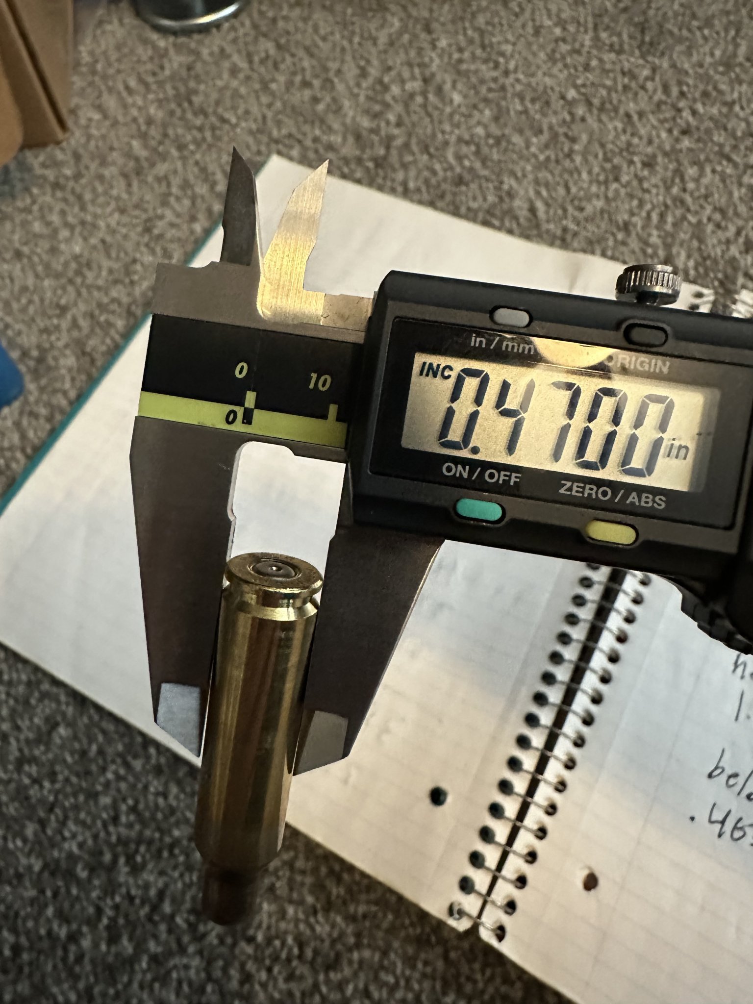

Two observations:
1) The "carbon" around the top only of the fired necks, combined with the non-carboned rest of the necks and case indicate a very tight fit of your cases at the shoulder and bottom of the neck, with this fit likely before firing. This indicates you are likely not knocking back the shoulders enough for your chamber (which may be somewhat short?) or at least has a tight/narrow spot partway up the neck. Discoloration from powder burn (not "carbon buildup") is stopped partway down the neck - somewhat odd. You seem to have a tight spot in the case to chamber area partway up the neck. Is the base of your bullet seated below this discolored area? Perhaps this area of the cases are not getting resized enough for your chamber? It is almost like you have the "dreaded doughnut" at the bottom of the case neck/shoulder junction.
2) Your shoulder measurements show a clear difference between ejector issue cases (longer) and non-issue cases (shorter). Again, another issue that your issue cases are indexing HARD against the boltface upon firing and expanding the shoulder forward, whereas not so much on those cases that do not show the ejector marks as much.
Test: I would suggest you get a thick black magic marker and completely blacken several rounds. First try to chamber and extract them without firing and observe/photograph/post them. Then the same after firing.
Lapua brass is relatively soft and is likely showing an issue where harder cases might not.
I do not believe this issue has anything to do with a "carbon ring" or "lead buildup" in the barrel.

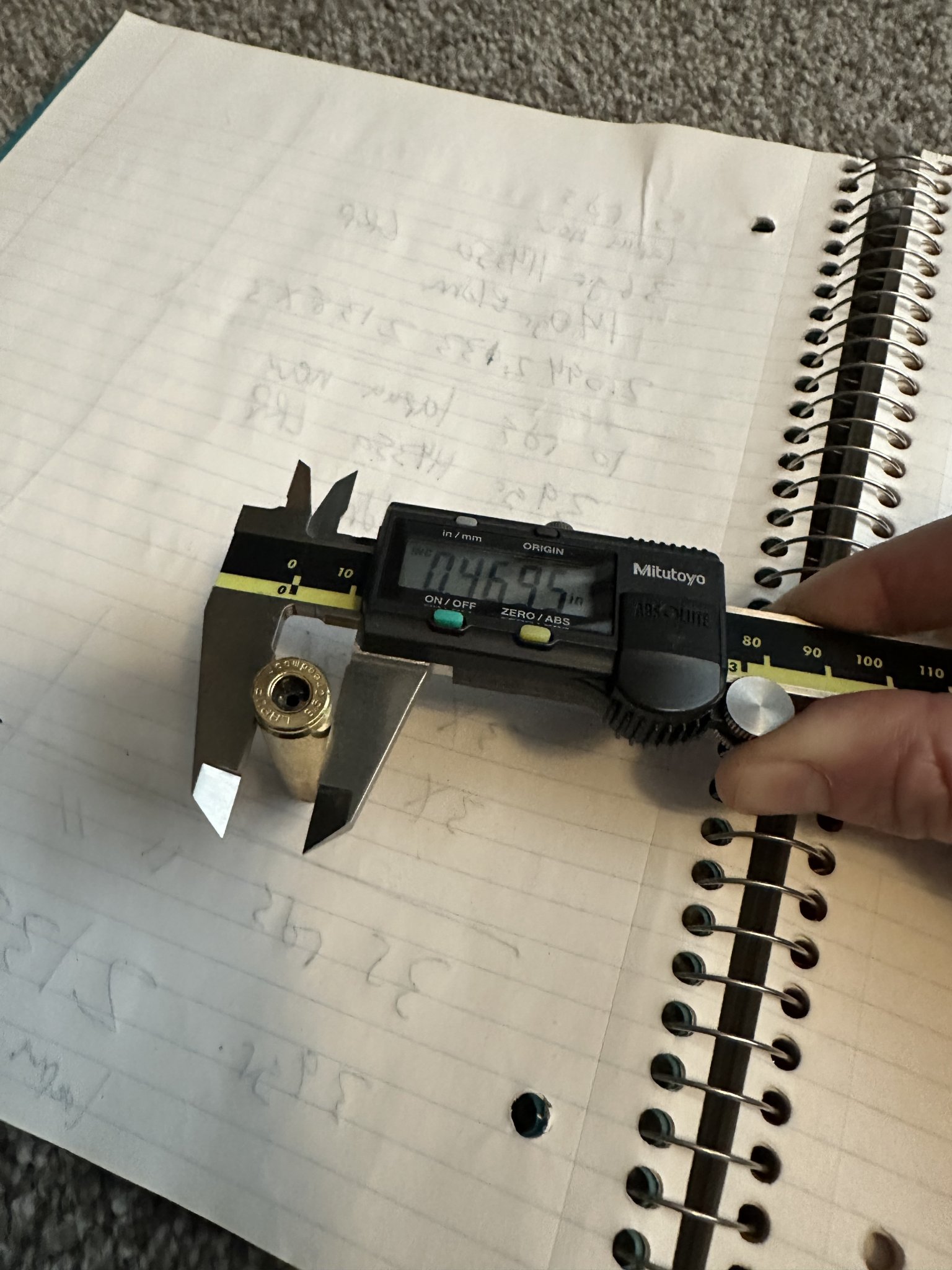

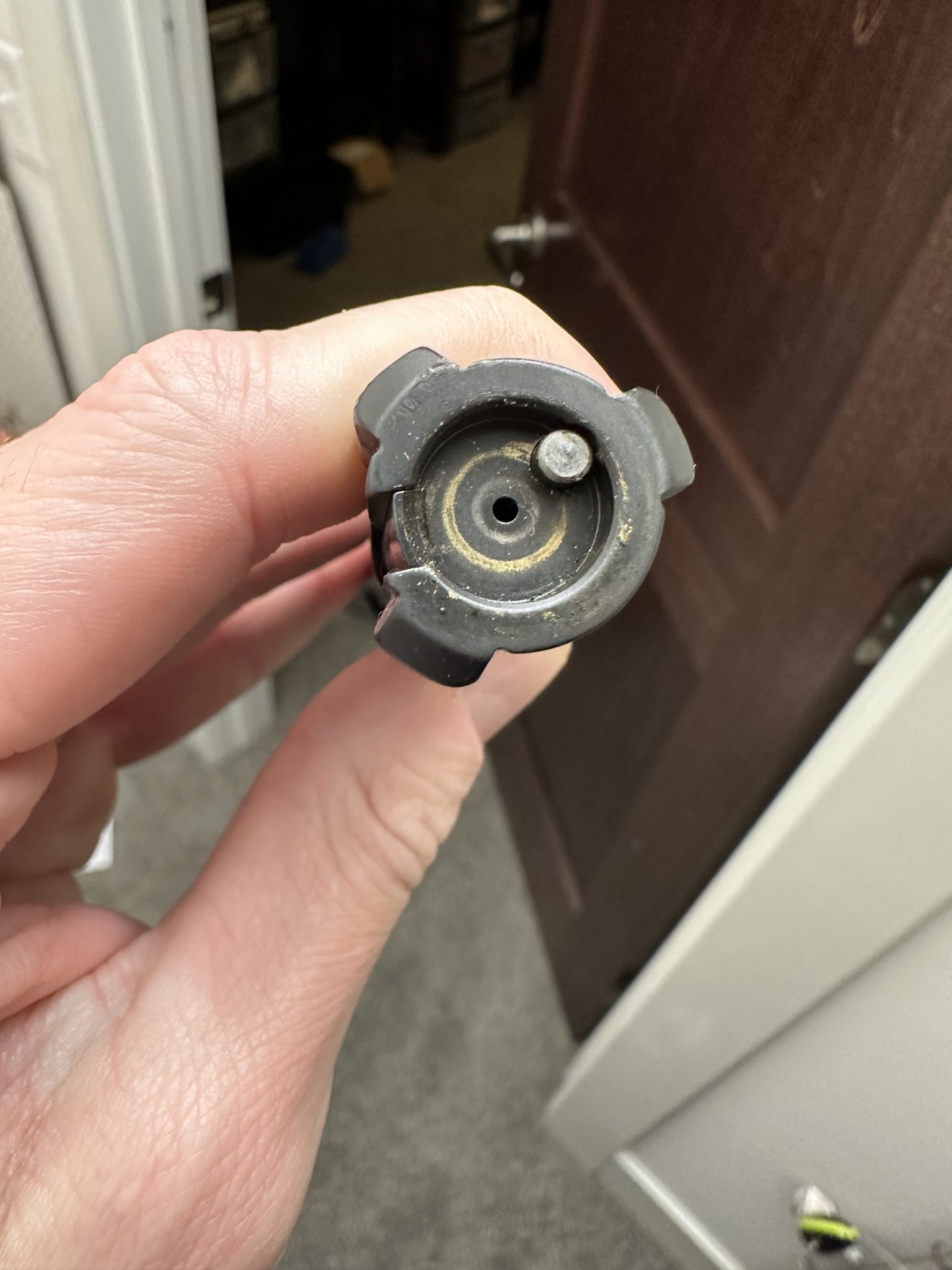

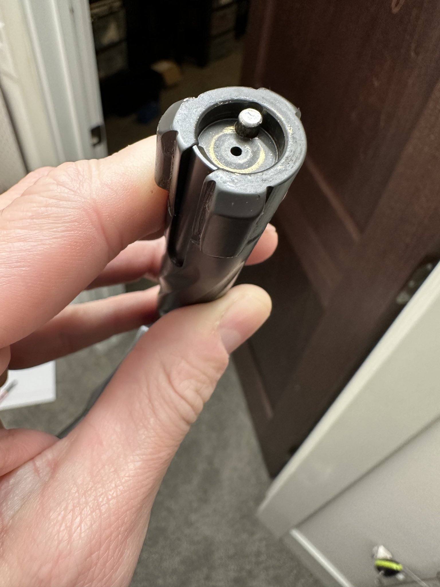

Really appreciate the reply. I also attached a couple pictures of the bolt face. After preparing the bolt like you mentioned except that I wasn’t able to get the extractor out. This was all done without cleaning, barrel is still as seen in pics.
Unsized fired brass that did NOT have heavy bolt lift at the time of firing - very little resistance
Unsized fired brass that DID HAVE heavy bolt lift at the time of firing - there is clearly much more resistance
Virgin case - unfortunately I don’t have any of these as I thought I had my load figured out after not initially having issues and loaded up everything I had. I disassembled one of the unfired rounds and it falls with minimal resistance on that, case has been trimmed, champhered, and expanded mandrel .262
Unfired case with bullet loaded to the length I’m shooting - minimal resistance
I have never fired a sized round through this rifle, only new Lapua that I trimmed, champhered, and expander mandrel .262. Actually even even set up dies for this rifle. Would it be helpful if I did that and tried to chamber them as you describe or is that not necessary because I’m not having issues with sized brass?
- Neck diameter of loaded round - .2915
- Neck, diameter of fired and empty case - .2945 (there is no difference in this measurement between the cases that had heavy bolt lift and the ones that did not)
- .200 line with fired unsized brass - there seems to be some variance here. I measured a bunch of them and .4695 is what I’m getting on most of the rounds that DIDN’T have heavy bolt lift, but the ones that DID have heavy bolts lift seem to be .4685. (hopefully I’m taking this measurement accurately, included a picture of what I did). If I measure with the case parallel to and between the end of the caliper like in the second picture they all measure .470.
- headspace using SAC comparator, unfired brass is 1.4810 - 1.4820
- headspace fired brass with NO heavy bolt lift - 1.484 - 1.485
- headspace fired brass that DID have heavy bolt lift - 1.4870 - 1.4875
- internal diameter of neck after firing without sizing - .265 (all brass is the same whether there was heavy bolt lift or not)
Did you remove the ejector plunger when you tested the cases for bolt resistance?
Reactions: Rover31
That's not my or most other experience with it.
I can tell you from actual hardness testing, that's not the way it is. Not just coming to conclusions from feel in sizing or measurements. But from actual hardness testing.
Lapua isn't softer than any of those on average.
Couldn’t get it at first, had to go pick up a different punch. Here’s what I found after removing the ejector, plunger and firing pin
Fired brass that had no heavy bolt lift at the time - bolt drops freely
Fired brass that did have heavy bolt lift and ejector mark at the time of firing - does not drop freely at all, feels like there is a ton of resistance
Unfired case with bullet loaded to same length as what i was shooting when having issues - falls freely all the way
I don’t have any more of this virgin brass, but I disassembled one of my rounds. I know this isn’t exactly the same because I trimmed champhered and used a .262 mandrel but it’s all I have. It falls freely on this
I’ve never sized any brass for this rifle, only virgin brass prepped with trim to 1.906 - 1.908, champher inside and out, expanded mandrel with dry media and .262 mandrel.
Ok, now we have an idea what's going on. All your measurements are fine as far as chamber fit. Base, neck, etc. So, that's all fine. Your base measurements don't indicate a clicker issue.Your loaded ammo is falling free with gravity. So you're not touching lands with bullet.
The rounds that have heavy bolt lift are expanding more and are basically oversized in the chamber after firing.
Take the brass that had the heavy bolt lift (and longer shoulder), and size them down until the stripped bolt falls free. Just size down enough the bolt falls free. You'll get a little resistance when you're close, then size another .001 or so and the bolt will fall free.
Then load and shoot that same brass and report back if it has heavy lift.
