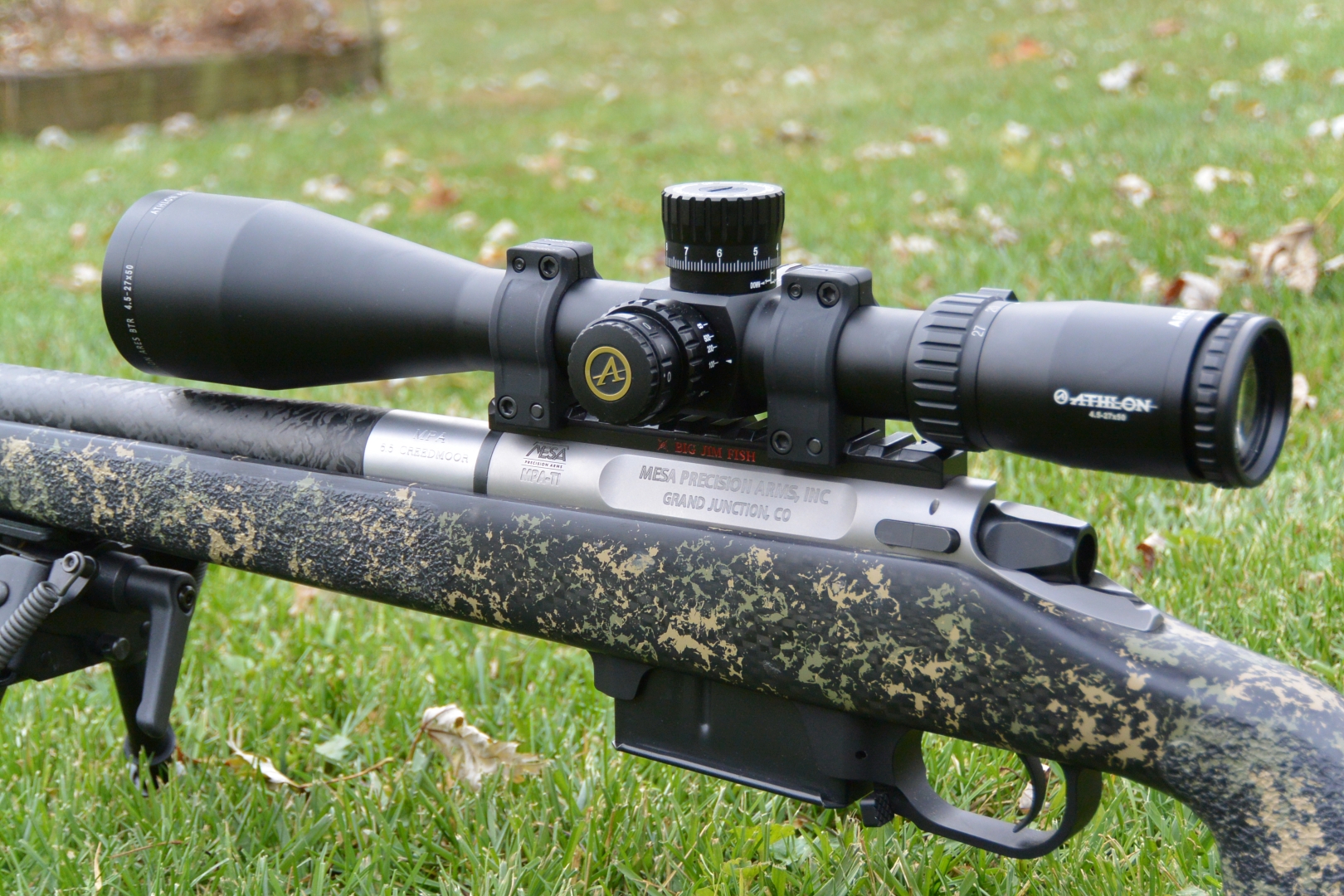

5 rd AICS factory mag for a hunting look in my Mesa Precision Arms crux rifle with McMillan Game Warden stock.

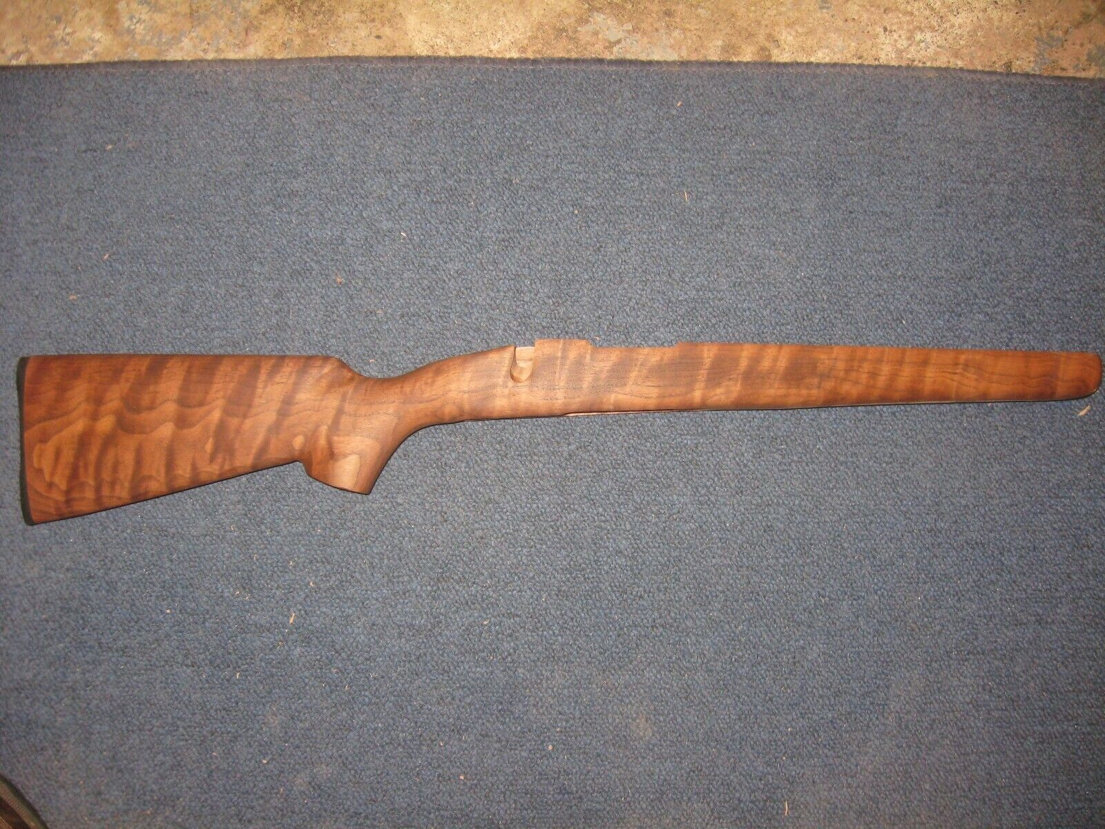

I just got a stock cheap. Its pretty.....
Im going to put a DBM on it.

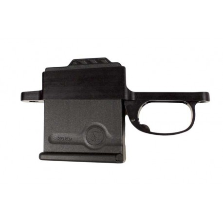

Either Badger M5....
or PTG flushmount....
I see at lot of attraction for the convenience of loading the mag on the side and than pushing the whole thing into the rifle. At classes DBM is a lot less cumbersome than thumbing the internal mag full.
If anyone has any thoughts concerning Badger vs PTG please pass it on.

My only experience is with Badger-manufactured Gen 2 mini chassis in my Manners stock. It’s been perfect
Just an anecdotal story regarding PTG bottom metal fit: My dad purchased a Manners stock from Altus that was inlet for an M5 dbm and a PTG M5 patterned bottom metal from PTG directly. They didn’t fit; it wasn’t even close. I’m not sure which part was out of spec. Some additional time opening up the stock inlet and no worries.
His Magpul AICS mags feed well from it but do not drop free. We got him a steel mag from MDT as a gift and that one works perfectly.

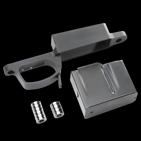

Just want to try one?
I've used a few of these and they actually work flawlessly. They're the perfect thing to try, before you go spending $300+ on metal and $80/mag.
For what it's worth they feed 6brx and 280ai flawlessly. More than can be said for many aics setups.
