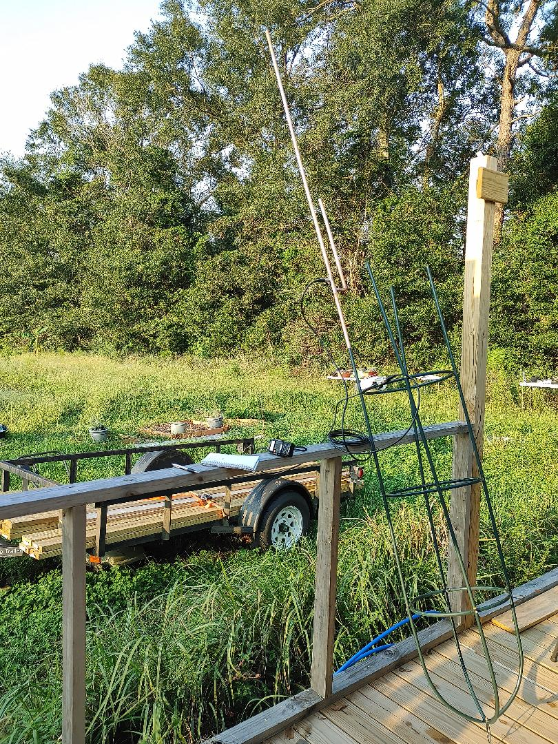

I've ordered this 2-meter break-a-way J-pole antenna, 15 ft of RG-8x coax and a SMA-to-PL259 adapter to connect the UV-5R to the coax. I've got a lightweight camera (cheap) tripod that I want to try and adapt to hold the antenna for remote/mobile use.
Once I get it in I plan on hooking it up and trying to connect to the repeater.

I received my new antenna for the UV-5R today and I was able to hear traffic on the Jackson County repeater. They could hear me key but no audio. That repeater is supposedly about 10 miles from my residence.
I was also able to hear traffic from the Biloxi repeater but didn't try to make contact.
I was able to make contact with my local repeater and an operator in Gulfport said could hear me clearly. I could hear him key, but not his audio. This repeater is supposed to be about 12 miles from my residence. Tomorrow night this repeater is supposed to be active for the weekly net meeting, so I'll try again.
All of this with a Baofeng UV-5R with Nagoya NA-771 standing outside.

I was able to hit three repeaters today and carry on conversations; Biloxi, Vancleave and Lucedale. Was not able to talk through the Wiggins repeater.
Temporary set-up today: Baofeng UV-5R hooked up to a KB9VBR 2-meter J-pole antenna. Base of antenna is slipped over my wife's upside trellis planter rack, propped against porch rail. Base of antenna is probably 8 ft off the ground.

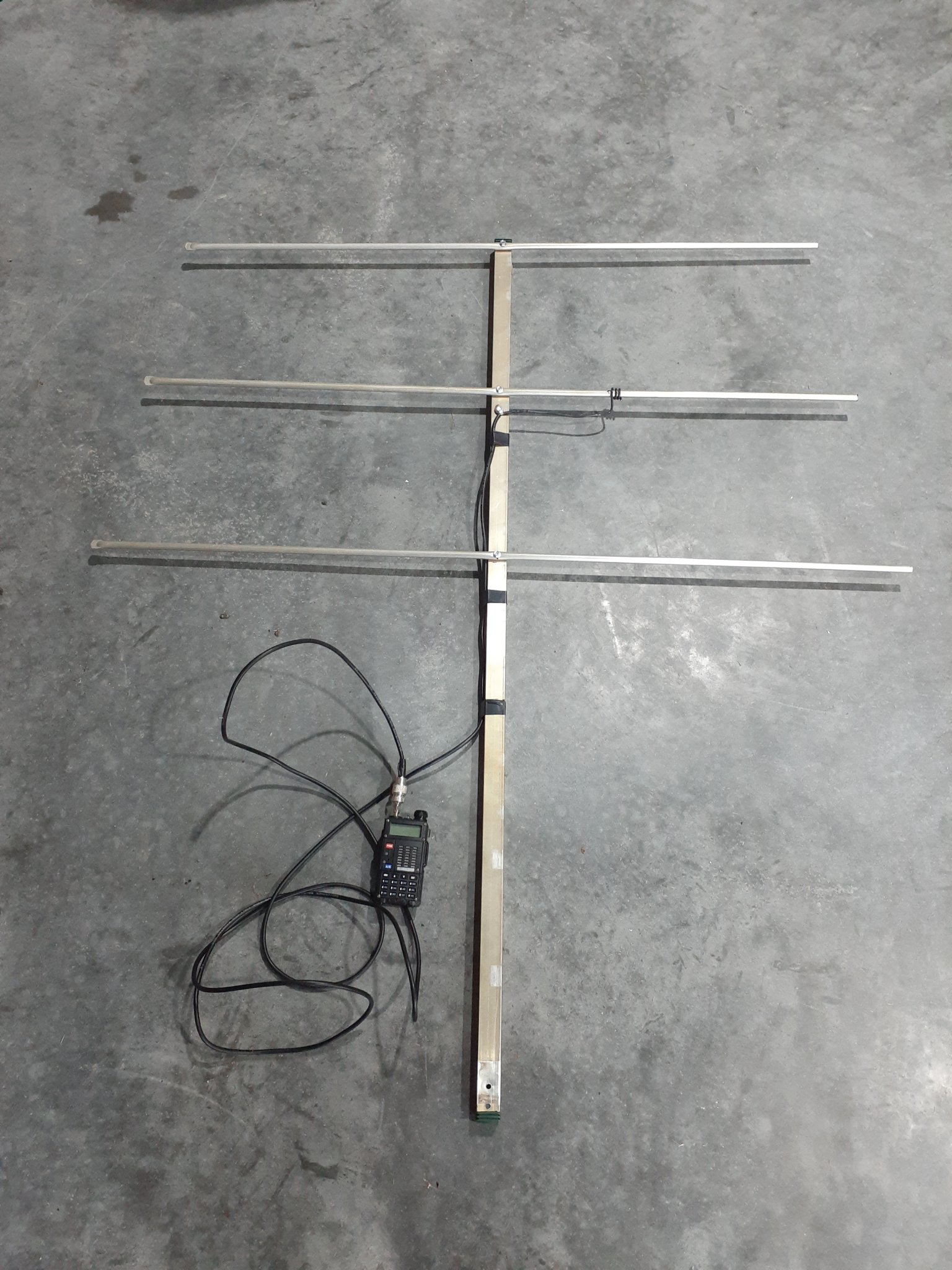

Sorry for replying to an old thread but I’ll go ahead to share the info with hams who are trying.
I live in very mountainous north central Idaho. We have talked over 70 miles away with baofeng Uv-5r and a mag mount antenna on top of vehicle. Of course from ridge tops not in a valley (antenna height). And quality mobile radios set up properly are several times better than handhelds. Aftermarket antennas help handhelds but they are still lousy for getting out very far. We set up a repeater that is central to all our handheld users. That is all 2meter analog, digital isn’t much of an option for our needs and environment. And baofeng is what we give our kids, which have their ham license also, because they are cheap, aka disposable.
Also, one member of our group talks around the world with basic HF rig and 100 watts.
