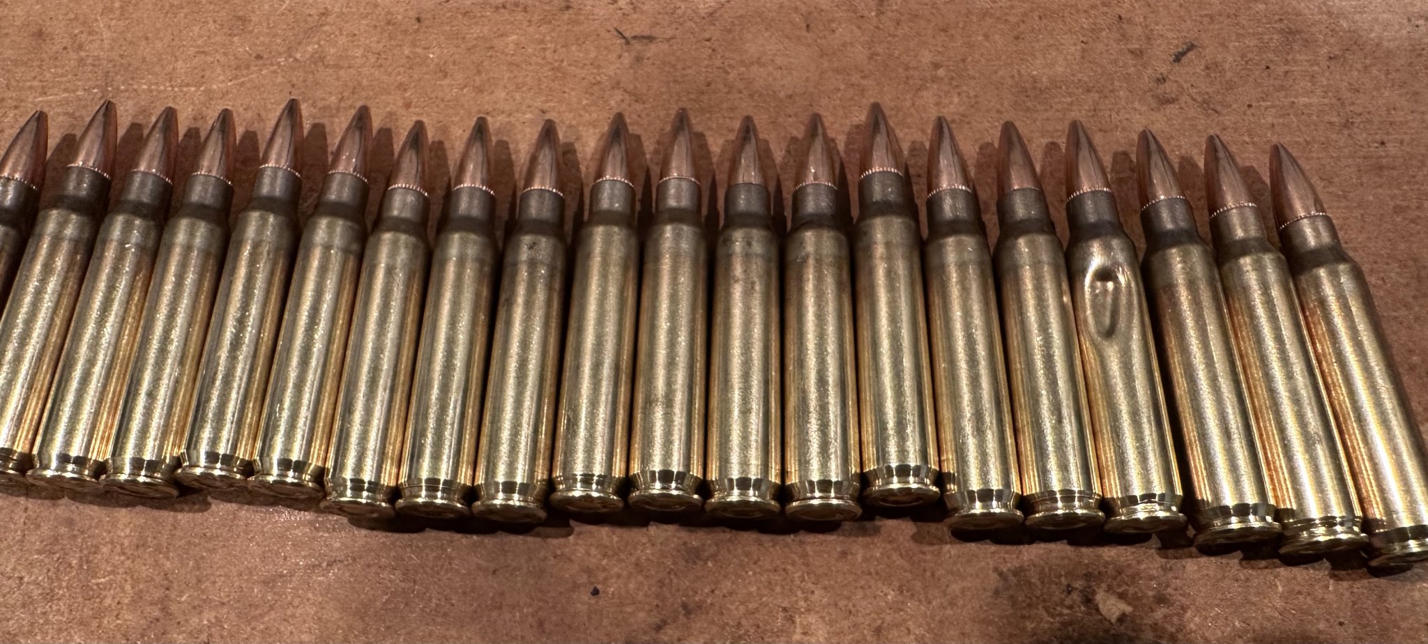

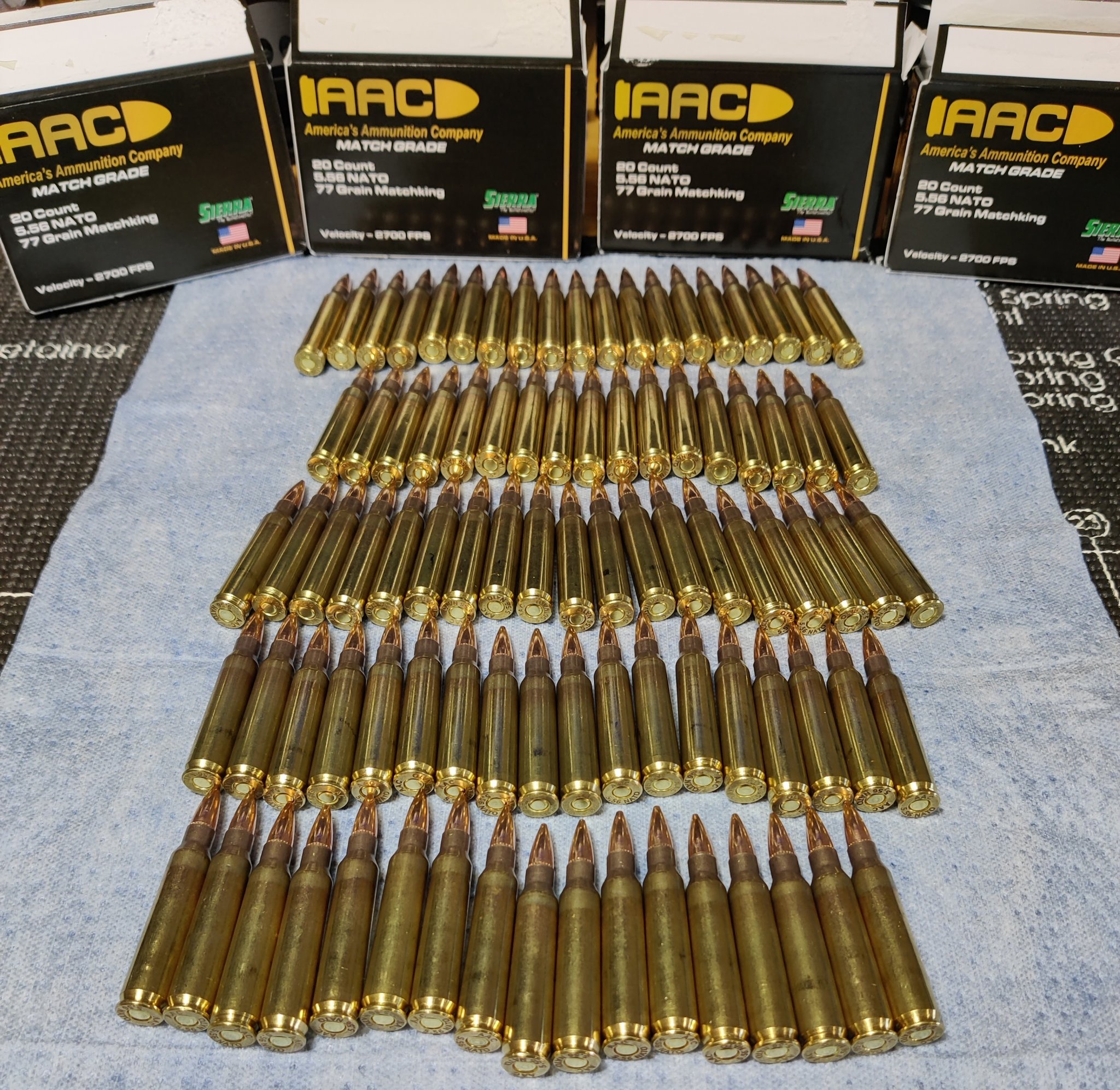

Alrighty...my shipment came in. It might be a while before I can shoot it, but here are my physical observations. And full on respect to Molon...this is a PITA.
Rounds are packaged in the boxes without any separators. Guess they are saving every cent they can. Annealing looks great on the cases and very even from what I see. Stated velocity is 2700 fps (we shall see about that) and Sierra is proudly named on the box:

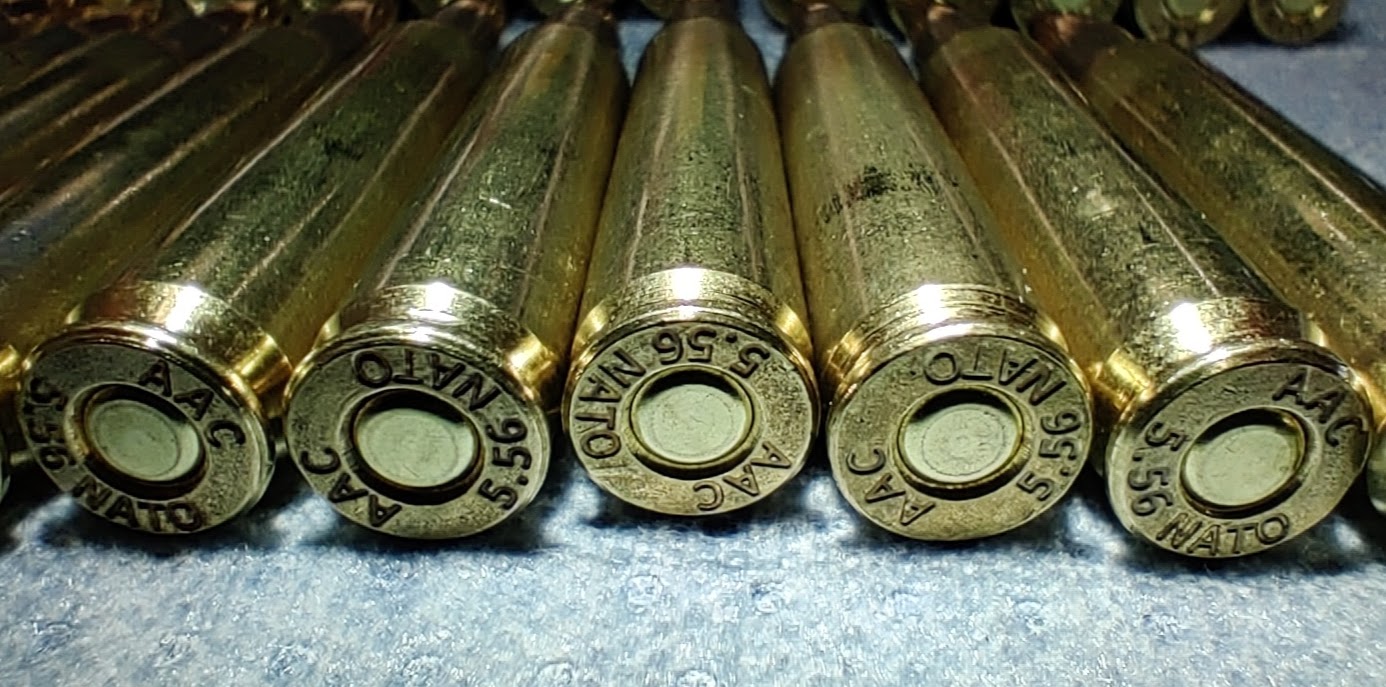

Brass is head stamped "AAC 5.56 NATO". Primers are gold/brass colored:

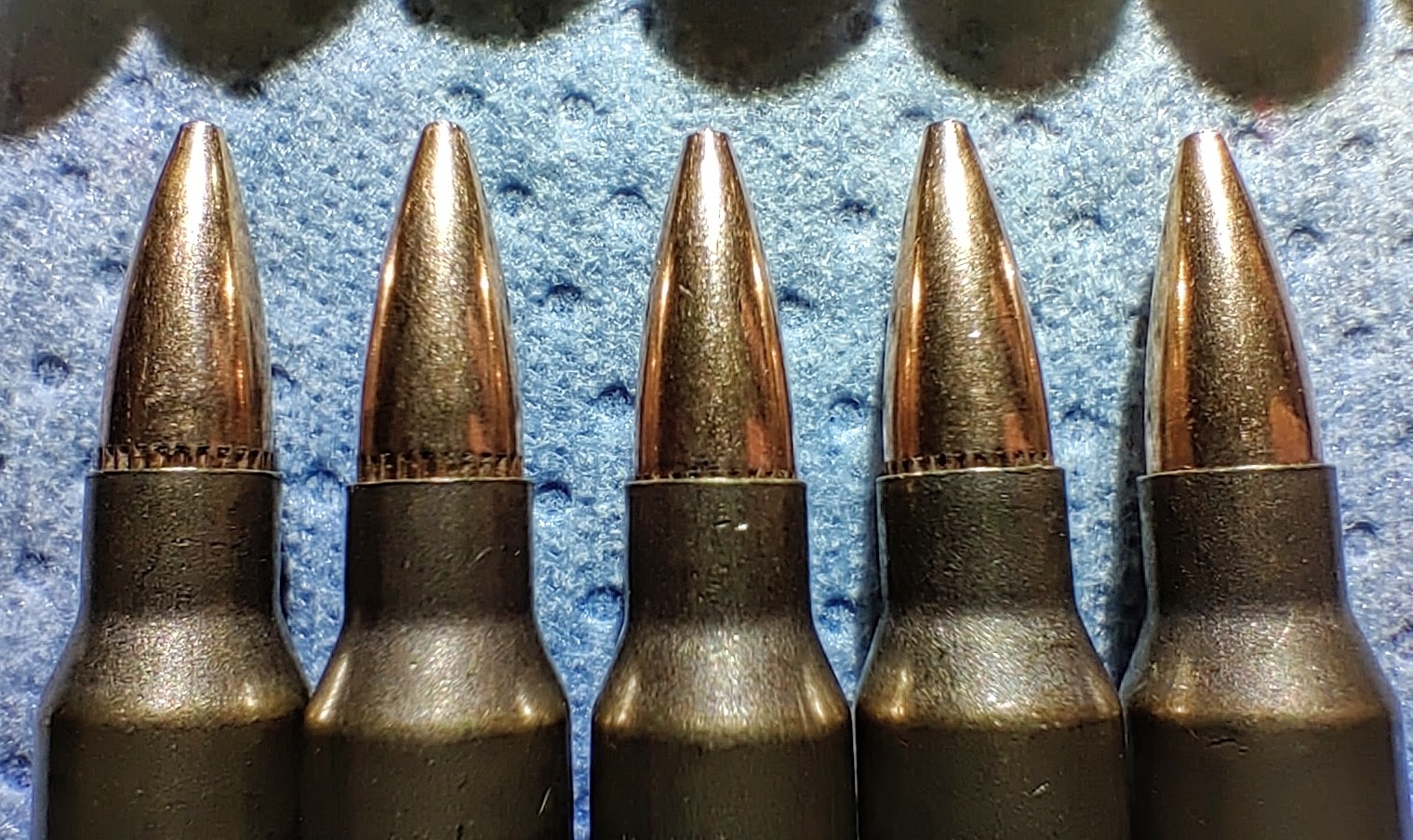

And now the bad... Not sure what machine they are using to seat these but it sucks. OAL was all over the place. With the bullet cannelure it's easy to spot just how off the rounds are from each other. I measured BTO to be anywhere from 1.826" to 1.853". Now granted the super short ones were 1-2 per box, but to be labeled as MATCH GRADE I would expect better:

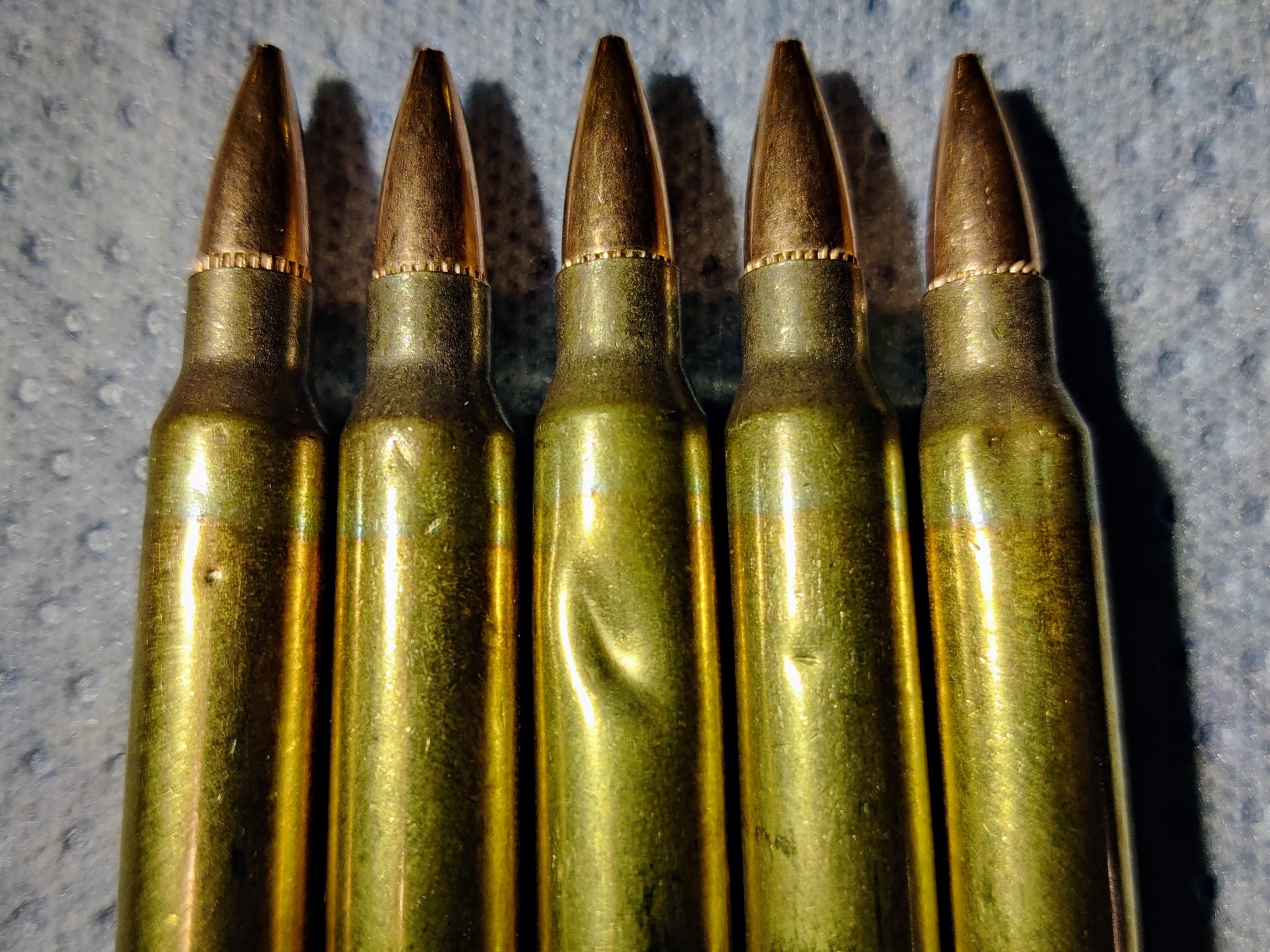

And then we have the damaged rounds. Several per box had small dents that I would not worry about, but at least 2 rounds out of the 100 I opened had some pretty good dings:

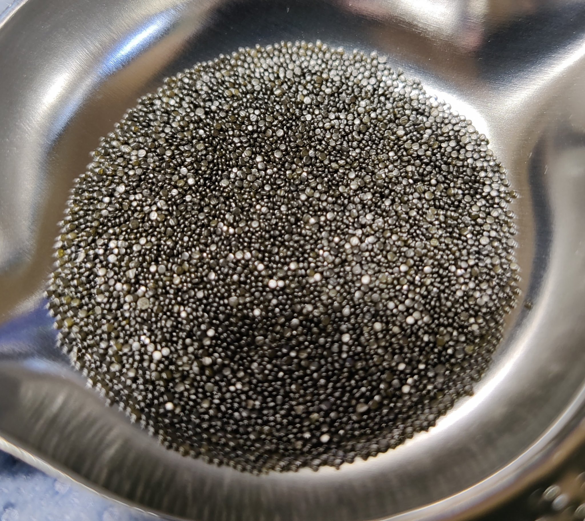

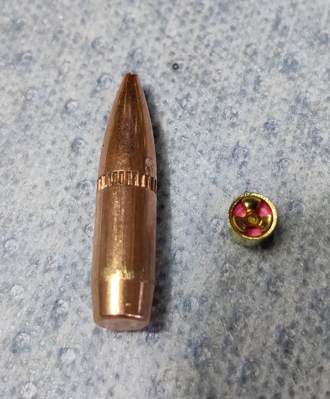

I picked 5 rounds at random and tore them down. Power was a smashed ball type and to my surprise all weighed out at 24.5 gr. Case weights were 95.2 to 96.7 gr. Case capacity with water was 29.66 to 29.78 gr. Primers had a red/pink mix in them:
Can't say I have high hopes for how they shoot but we will see....they really need to tighten up on their quality control.

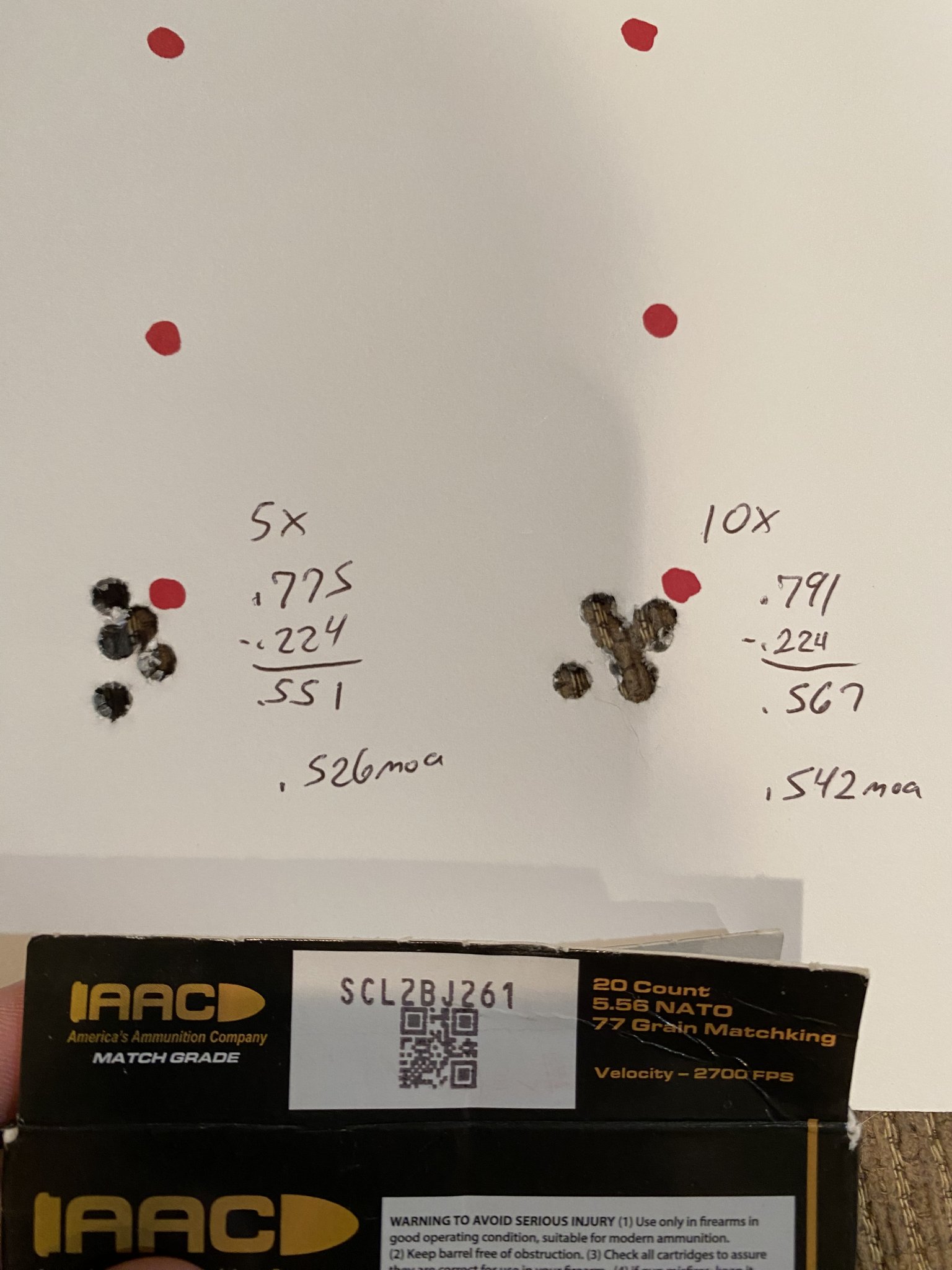

39F, 8-14mph winds
77gr AAC
26” Bolt gun, 5 shot and 10 shot group. There was a bit of mirage after the first 5 shots when shooting the 10 shot group, and shot 8 is the one to the left that opened things up a bit. Overall, not bad for as quick as I was shooting (<4 minutes for all 15shots). I fired the 10x group first, then the second 5x group.

Previous testing from a week or two ago…
Forgot my magnetospeed at the house, so no velocity data.
Tested using 3 of my Rainier Arms barrels. All 18”.
RA Match- Around 1-1.3moa (I mic’d the groups but didn’t bother measuring since it obviously didn’t like this ammo.)
RA, Rock Creek blank
RA Ultramatch (Shilen blank)
After the second group with the Rock Creek barrel, I adjusted down 0.2mil. Wind was 3-8 mph, which may have had some effect, but overall, it seemed like only 1 of these three truly liked the ammo. It’s good for the price, but I’ll need to review my notes to see how it compares against the IMI 77razorcore in these barrels.

Ran this some last week.
At 100, between 1.1-1.5 with my centurion recce barreled rifle. Not ideal conditions and a 2-12 optic. Friend shot more like 1.0
He ran some through his 20 inch Douglas SPR barrel with an 3-18 and was .8-1.2.
It was in the teens with lots of wind. Not usual down here.
Was not able to chrony. Both rigs suppressed.
