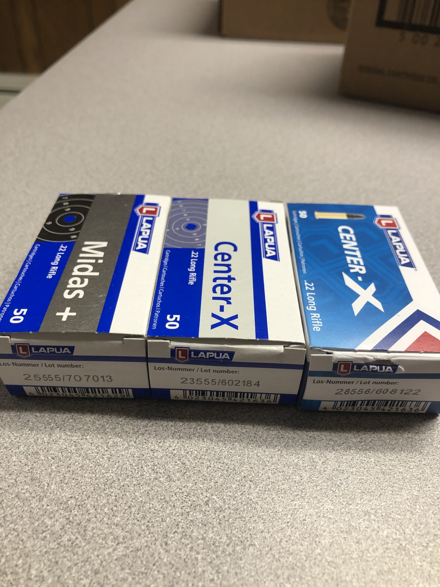

We took 3 Tikka T1x into the Lapua rimfire test facility on the same day and tested them 1 after the other. Conditions in the tunnel stayed the same during testing all 3
all 3 are set up identical
all 3 were tested with the same lots of Lapua
All 3 came away with a different lot of ammo that worked best
None favored the Xact best
Rifle 1 came away with a lot of CenterX as best
Rifle 2 came away as Midas best
Rifle 3 came away with another lot of Midas best.
it was quite an eye opener to have seen this in person.
I’ve learned that testing is crucial to finding best for our rifles as they all performed differently from each other

They did not provide that detailed info but I do still have the group pics from testing. I have seen those reports with the extra info but I think those are given to the folks who mail their rifles in. Since all 3 of us were there with our rifles Luke just rolled on thru the lots seeing what worked the best in each rifle. Best I can do is show the lot # we used prior and then ended up with. The velocities of the lots are different between our 2 rifles. Rifle 3 info will have to wait till I get a response on the lot specifics of that Midas.
My wife and I had been sharing a lot of Lapua Centerx that we bought off the shelf prior to testing. Lot # 23555. This lot has been pretty good for use.
Her rifle shot it a little bit better than mine did.
in the lot testing her rifle worked best with Midas lot # 25555 but the Centerx above was close in performance.
my rifle tested best with Centerx lot 28556 and showed that the Centerx we had been shooting was worse for sure in my rifle than in hers.

Hey 545, I'm back....;)
So I checked and the first 2 digits of the SK/Lapua lot number,
are the average muzzle velocity of that batch.
That pic you posted, shows 23, 25 and 28, put a 3 in front
it gives you the rated mv...323, 325 and 328 meters per second.
Might be that variable that makes the difference to the barrel harmonics.
