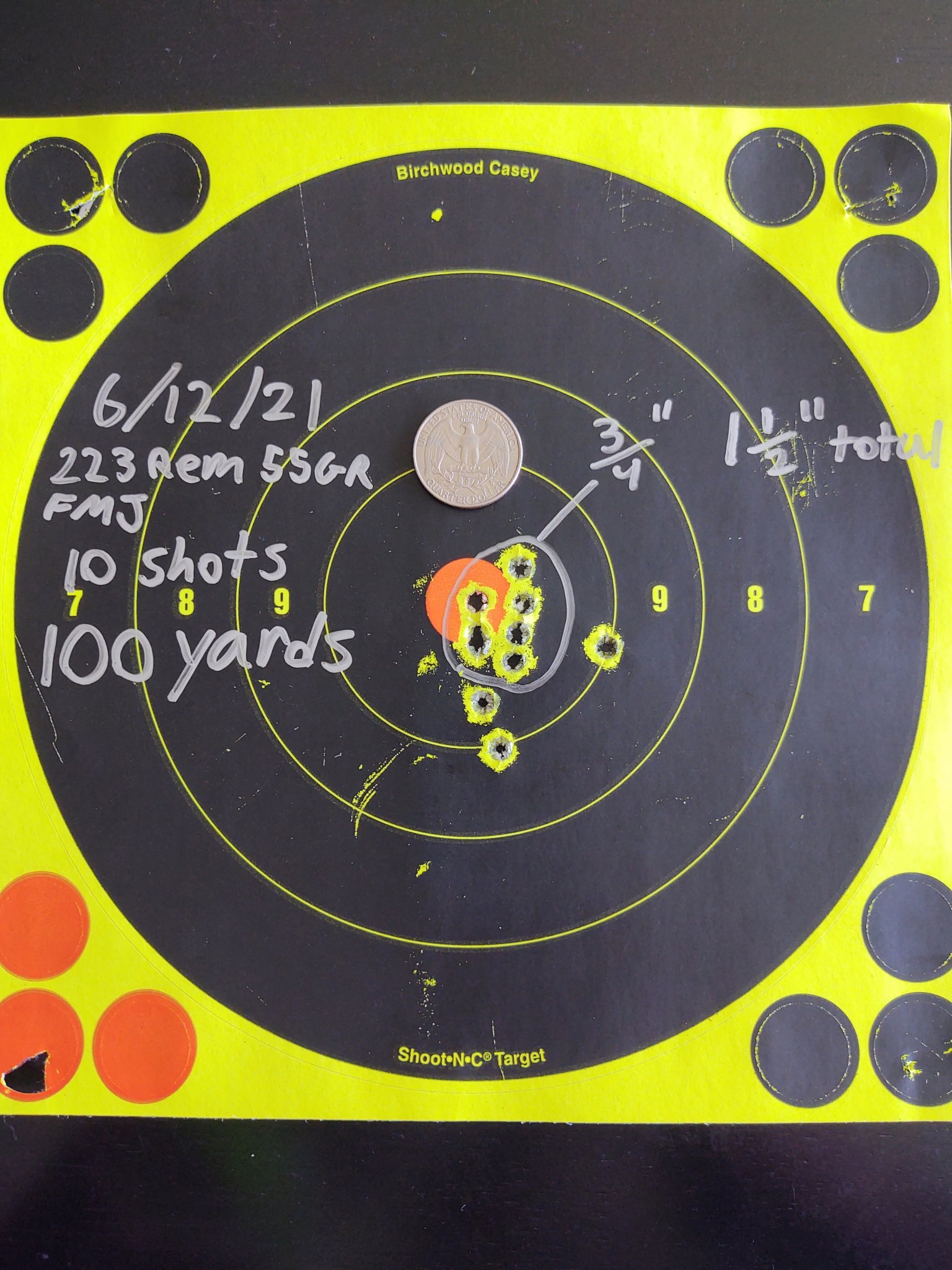

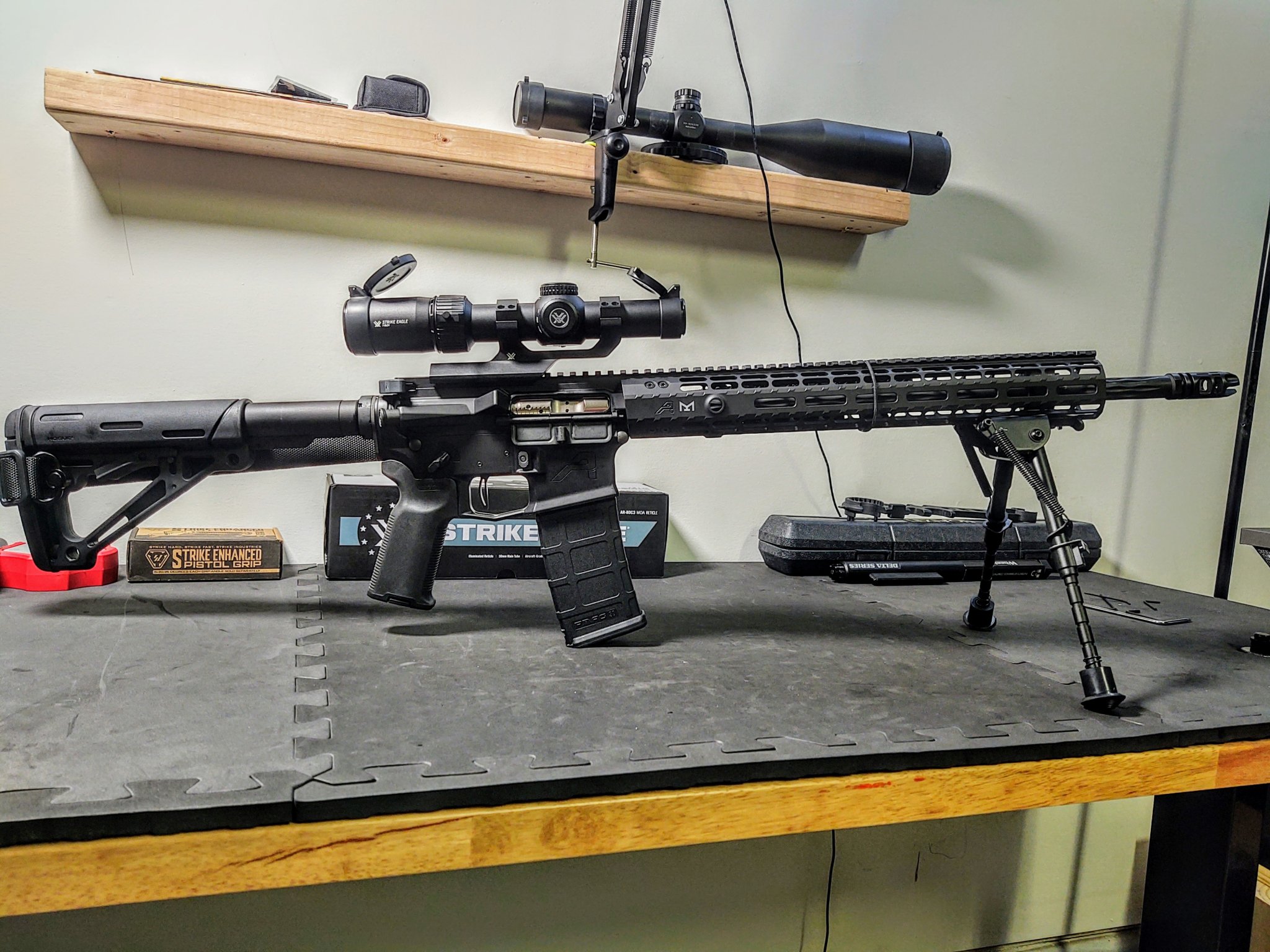

I recently built my first ar15, mostly Aero parts with an 18 inch 223 Wylde Faxon match grade barrel. I'm a new shooter and want to slowly get into some long range shooting.
I'm currently shooting 223 55g frontier FMJ since it's cheap but I got good enough to definitely know that I'm outshooting my ammo at 100 yards, especially since I've installed a 6-24x vortex.
At my local range I have to qualify at 300 to shoot beyond so that will be my next step on my journey.
Can I please get some recommendations for some affordable ammo that may match well with my setup. I would love to practice at a 100 with ammo I know I can't outshoot.

Depending on what exactly the standard is to qualify at 300 yards, the shit you're shooting now could be more than sufficient.
