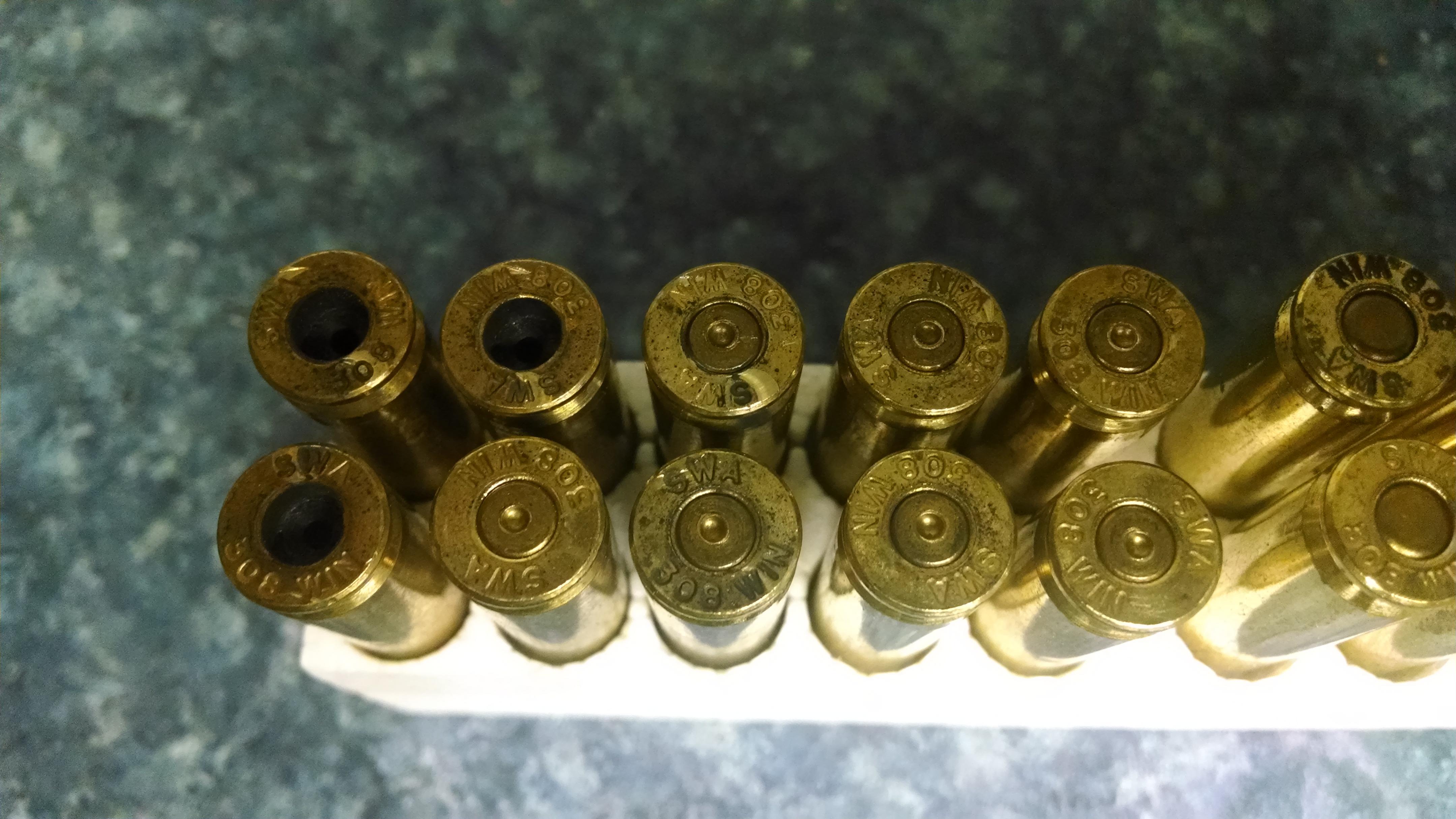

I put a box through my M1A and didnt notice any problems, but these were the first ones through this particular gun. Even if it was loaded hot, how could it blow the primer completely out of the case if the bolt was seated all the way? Thats what makes me think its a headspace issue. The primers on the other rounds were a little flat but the firing pin didnt pierce any of them. Ill take some pictures this afternoon after work and put them up. Thanks for the help
ammo pics
Friend, you have pressure issues, blown primers are a classic example of too high pressure. Plus looking at your photo the other fired primers are cratered around the firing pin indentation, not good. You're not doing your rifle nor your face any favors using this ammo in your rig.

Those are classic pressure signs. See the shiny scratch mark on the case head going from the primer to the rim? That is where it leaked and a bunch of hot gas came out @ 60k PSI. Also it doesn't blow the primer out with the bolt seated all the way what happens is the primer pocket gets loose and then when it cycles it tosses the primer out too. It can land in the extension or in your magazine or go out the ejection port.
What is probably happening is that those rounds are loaded hot and you have a very tight chamber on your 308 AR so you're hitting pressure sooner.
First impression is the loads are just plain too hot. Another contributing factor could be the short barrel. With the 175s and a powder like RL-15 or slower, gas pressure is likely pretty high at the gas port causing the bolt to open while chamber pressure is still high. That can cause all sorts of weird stuff. You might want to check hardspacing too, it could be too much to begin with and really hot loads could stretch things too.
Inspect your bolt and carrier very carefully for flame cutting of the bolt face or any deformation of any component. Dump the match loads. Lot of things that work in a bolt gun won't work in a semi, and somee things that work in a long barrel semi won't work in a short barrel semi.

The ammo is too hot, headspace wrong OR the gun is overgassed and unlocks the bolt too soon while the pressure still has the case welded to the chamber. Are any of the case rims bent due to the extractor? I'm leaning toward overgassed since it has a 16" bbl. The adjustable gas block sounds like the cure to me but by all means get the headspace verified. Try that ammo in another gun or try different ammo in yours.
