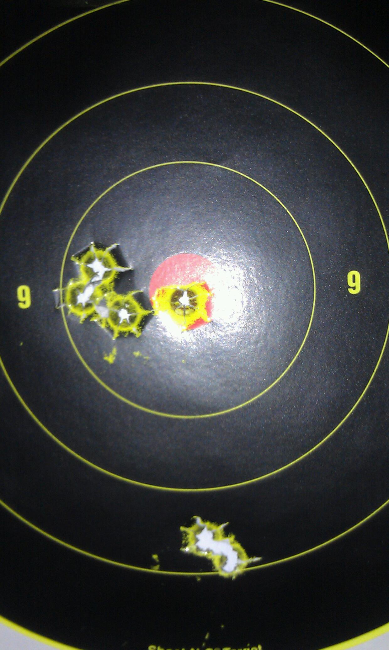

The top 3 left of center are Hornady Superformance Match 168gr @ 200yds. Made slight adjustment which is the 4th round center. The bottom 2 are Federal Gold Medal Match 168. same rifle, same distance, But 3in low. Both are excellent rounds for the 308 but I like the flatter round for longer distances to help cover my mistakes in distances. IMAG0968-1.jpg
