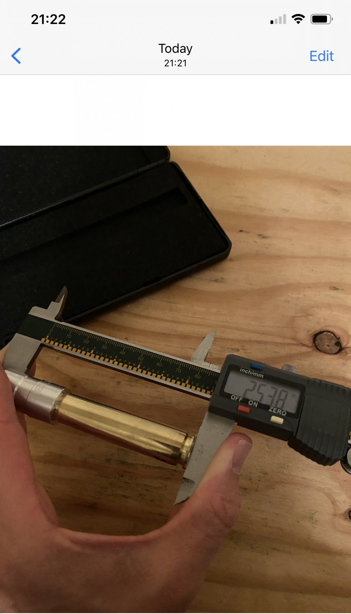

I annealed some more once fired Peterson .375 Cheytac Brass this weekend. On my desert tech the distance from base to shoulder is 2.538” for once fired brass. After Annealing it was 2.546”. And the base of the case is so wide that I have to hammer the bolt open to get an unfired piece of brass to extract. The code that AZTEC generated was 0156.
Anyone ever hear of this happening or had it happen?

Then you have an error in measurement.
I checked it multiple times. And the unsized annealed cases won’t chamber. Bolt won’t close.
It never does anything like this with the other calibers I anneal.
What else could stretch the brass like that?
What happens if you perform all the exact same procedures for brass prep and loading, but just skip annealing.
I set the shoulders back .002 and everything works fine, bolt closes fine and no extraction issues, with my .408. This is the first time I annealed .375 brass. Tomorrow I will try .375 without annealing and post results.

Just to confirm, you are using pilot #56 with 056 A pilot settings when running AZTEC analysis?
I did that and it still barely chambers and extracts. I’ve set the shoulder back .004 under the fired length and it’s still no luck. Even when I set the die to cam over the base is still to large to get into the chamber with out muscling it.
Some things else is going on. Annealing cases doesn't make them bigger in any sort of way. You just notices this after annealing
Yes and it did not just stretch the length the body/ base is expanded too.

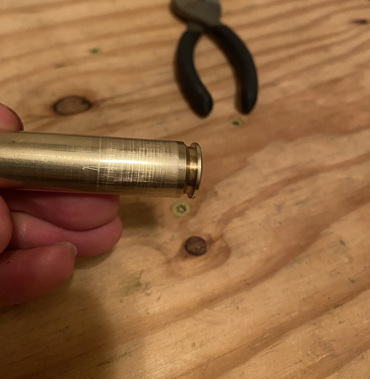

Have a look at these scoring marks. They only showed up on the part you see here but they are on most of the case body.

I measured several once fired non annealed cases and this is what I get. When I get home tomorrow I will have to sort the other lot, find the median case, anneal a couple of them and post results.
Thats what your chamber looks like on the inside. When you fire the round the case seals the chamber and whatever imperfections are on the chamber walls get imprinted onto the case. The case tarnishes. When you run the case in your sizer, the die takes the tops off the peaks and what you see are the tarnished valleys.

It looks like you might have a burr in the chamber from the looks of those scratches
Oh great, another issue with this barrel. Once I get this brass thing figured out I’ll have to get that addressed too.
The longitudinal marks are most likely from either a burr in the chamber, or a speck of brass galled in your die. That happens from insufficient lube. You can fix it by spinning a tightly fitted jag wrapped in fine steel wool in the die, with plenty of Kroil, but it does take some effort.
Those rings on the case are a bigger concern though. That's from a roughly cut chamber, and they will cause difficult extraction with hotter loads. It can be fixed by gently lapping the chamber with a fired case (careful not to get compound on the shoulder, or to lap the chamber off-center; this is best done by someone who knows what they're doing and has some talent with tools) and then burnishing with a steel wool jag. But it depends on the application, whether that's an acceptable fix or if the barrel should be replaced instead.
The good news is your oversized case body issue will most likely be eliminated once those rings are lapped out.
