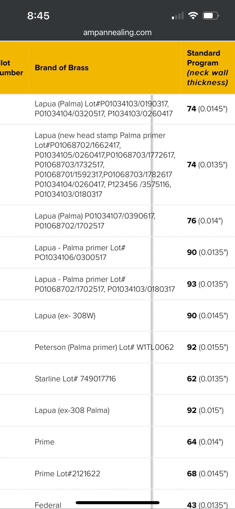

I recently got an Amp Mark I (without Aztec) and I’m looking for input on the standard program code I should be running.
I tried annealing 2 pieces at 90 but both melted. Am I misinterpreting this chart? My brass doesn’t match any of these lot numbers so I picked 90 which seems to be a “default” Lapua number for 6.5CM although I don’t know what “ex-308w” means.
Ex 308 means that the 6.5 case was made from a 308 case. That means it will have thicker case walls and require more annealing time.
If I were you I’d get a 650 degree Tempilstik (a temperature sensitive crayon) and find your own setting.
I would try emailing AMP. They normally respond quickly and are usually very helpful.
I know you use to be able to mail a few cases in and they would give you the correct setting.
Reactions: Simonsza1
Ah ok, that’s makes more sense as to why that time is higher than the others and why it melted those cases.
Are you using the #17 Pilot? It does look like the Standard Program setting should be 90 with "un-turned" brass.
If that isn't working a call or email to Amp is probably your quickest solution.
Interesting chart as it seems to be jumping all over the place. I switched from Starline to Lapua and my code was within 2 of each other. Range was 60-62 BUT I'm using a machine with Aztec. Just odd that they are showing a large difference between the Starline & Lapua IMO.
