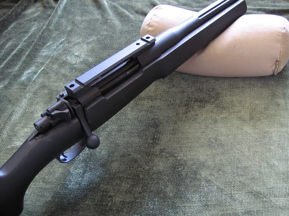

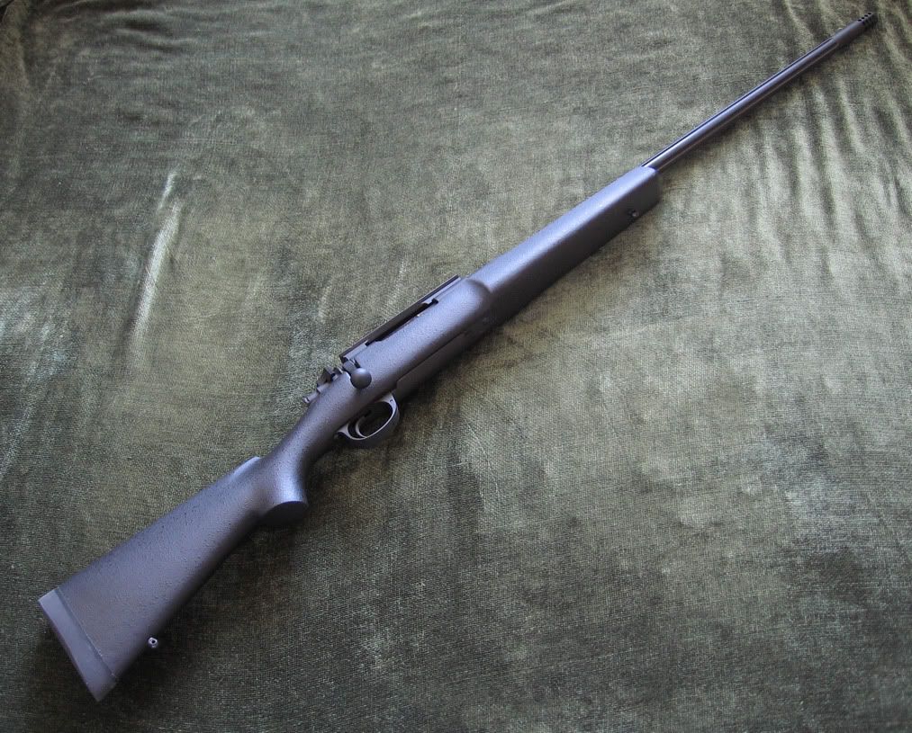

Some Mauser builds; just for inspiration...
.30-338 WinMag, Turk receiver
6.5x55 Swede, Yugo 24/47 receiver

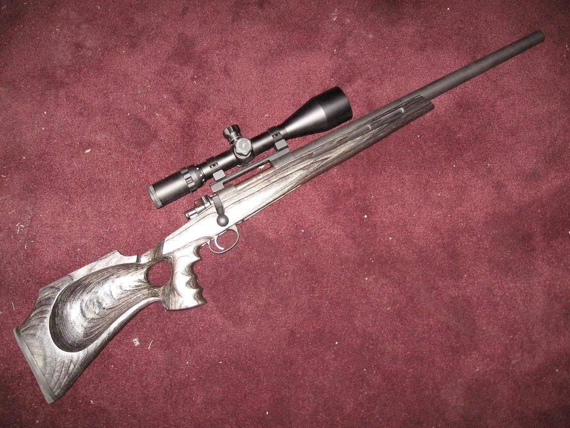

I know this next one is hideous, blame the customer, not me!
Re: An uncommon rifle build
It's not the thumbhole that bugs me on that stock; it's just too thin behind the "wrist" where the thumbhole is. That and it's ugly :p
Doesn't help that that particular stock was designed for a 10/22 originally; customer just happened to see it and want it... I really did try to tone it down a bit. It originally had a huge palmswell on the forend, and was significantly fatter from the ejection port foward. He ended up thanking me for the thinning.
