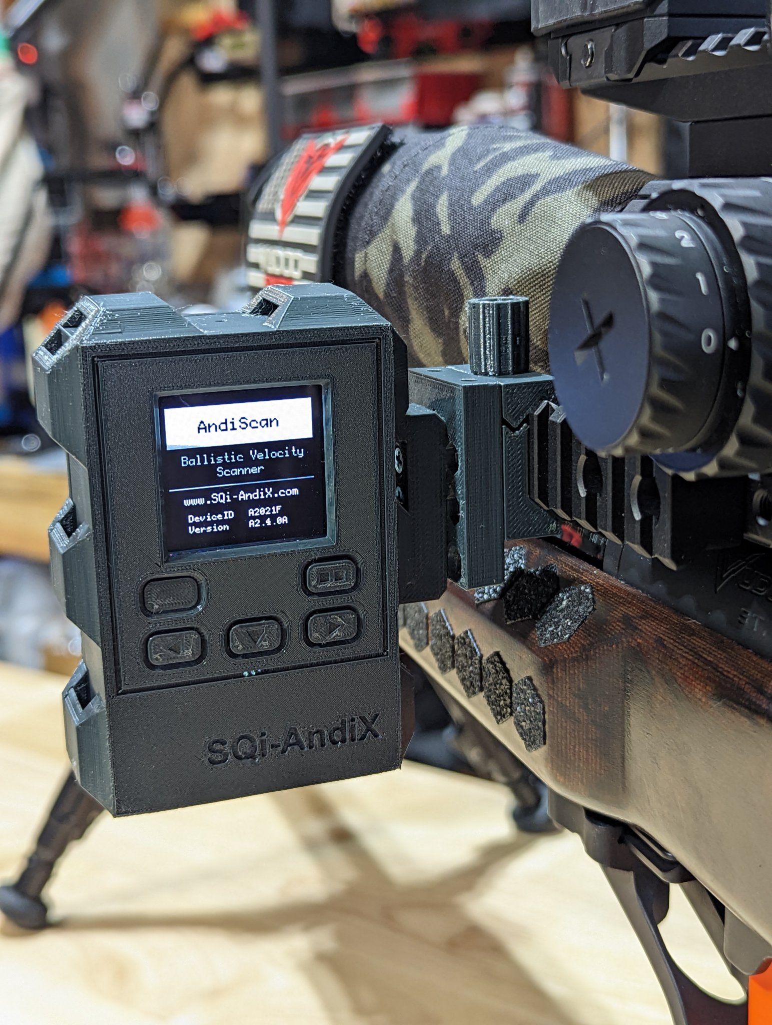

I received an AndiScan yesterday. It's like a tiny labradar. There's a little bit of a learning curve to the different menus and settings. I tested it in the yard with a 22 rimfire using the pic adapter on the action rail. I changed the firmware to expert mode I could change the velocity range to wide so it would read the 22 but it wouldn't read. The SNR is was 7-9 db. I drilled/tapped an arca adapter in the mill to let me screw the supplied printed adapters to it. Once I moved the AS near the end of the chassis it read no problem. I didn't have to change any other setting other than changing to wide mode.
<edit> I already learned something. I changed the trigger from 9 to 1 which is the lowest setting possible. It read no problem when mounted back by the scope. The theory is that, with the higher setting, it triggered while the bullet was still in the barrel.
I'll update more as I play with it a bit. My hope for this is to have a fully enclosed unit (not needing a smartphone) that can quickly be moved to gun to gun. I need my reading glasses to see the fonts but being able to remove it, read info and put it back without realigning (like a labradar) is fantastic. Even with a battery life of one hour I think it will easily work. It fully charges in an hour as well and can be run while attached to a battery back.

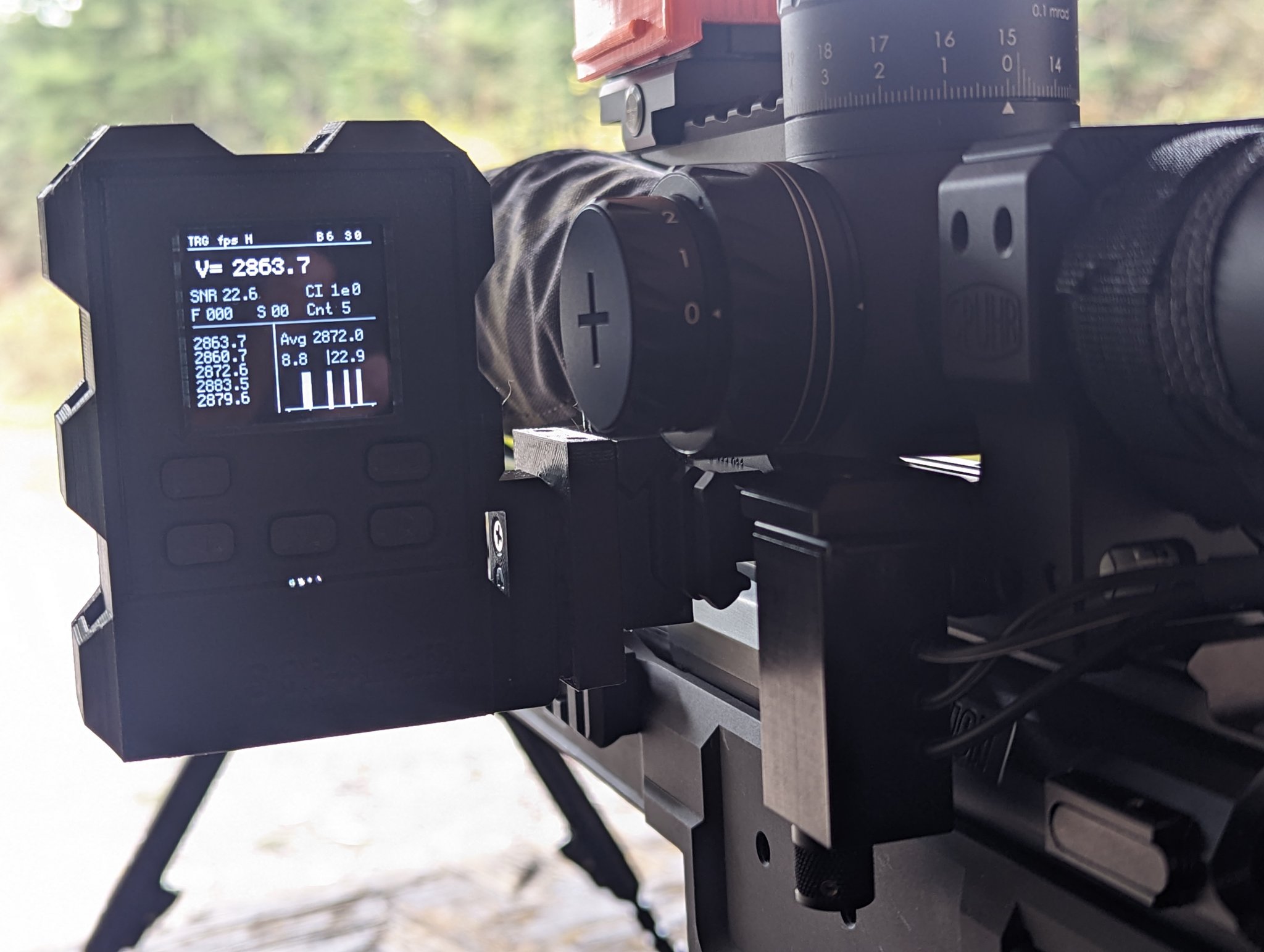

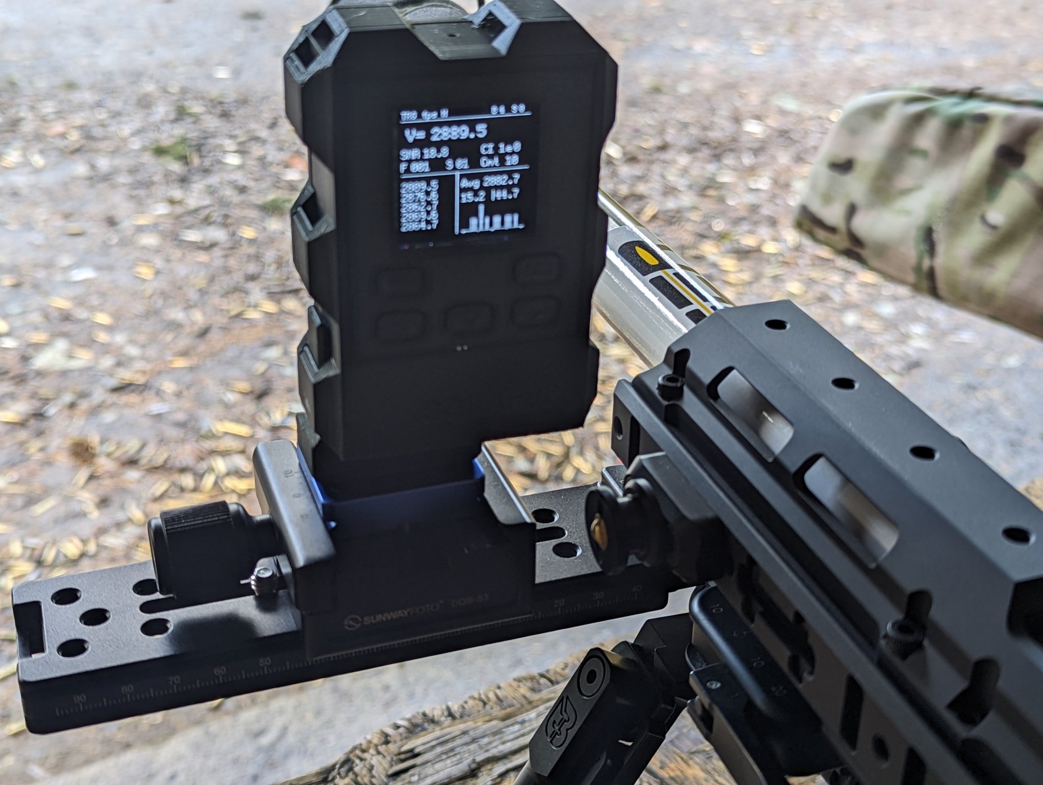

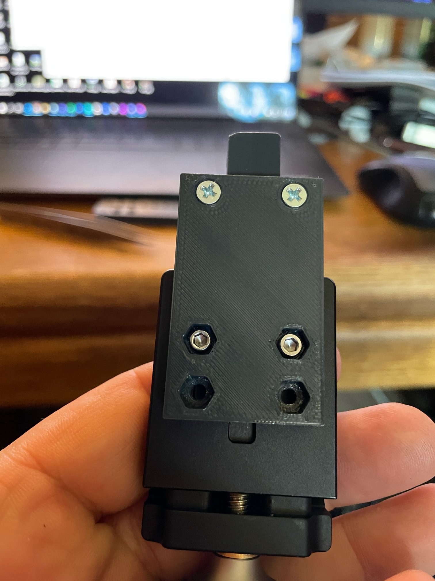

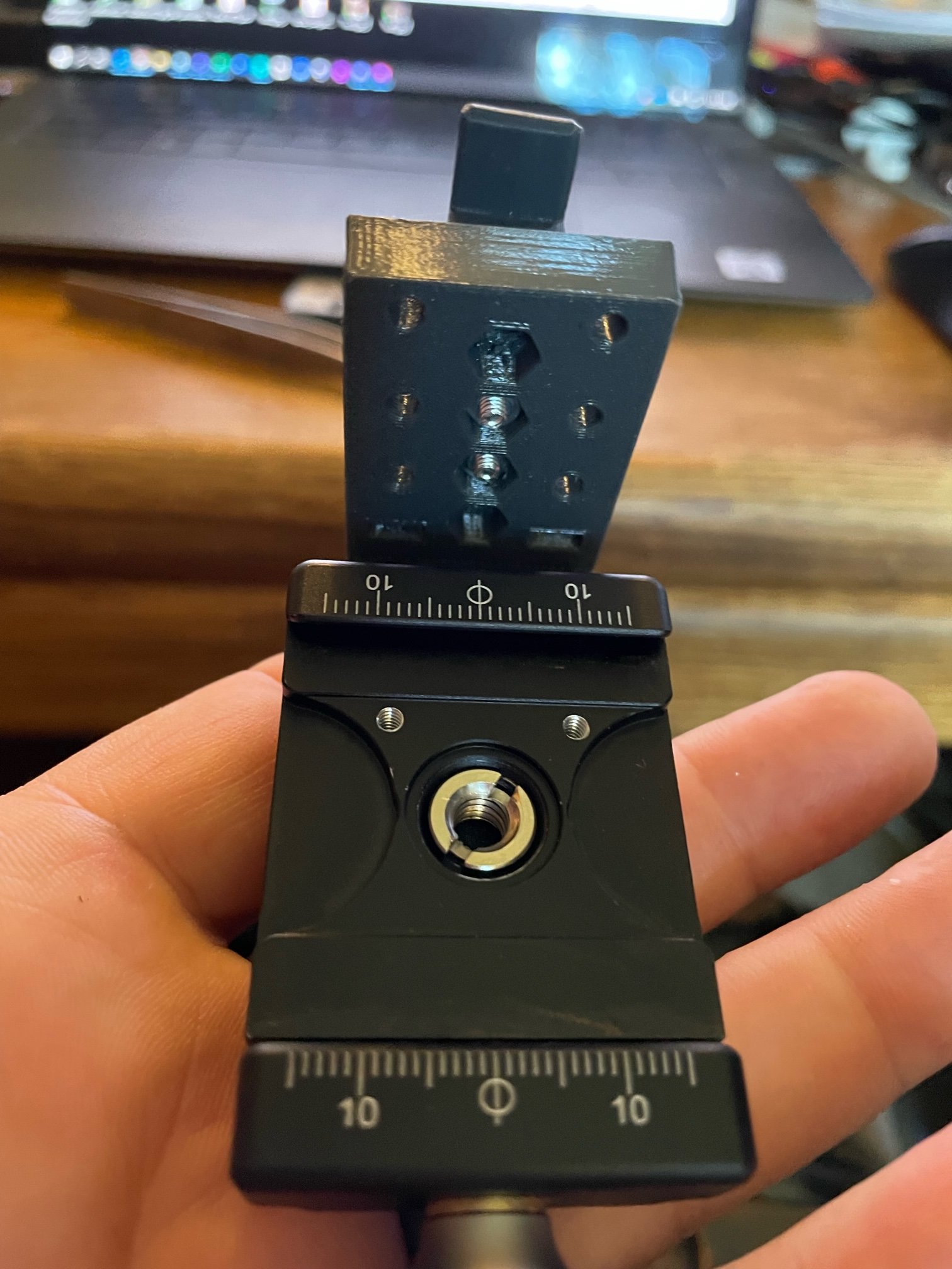

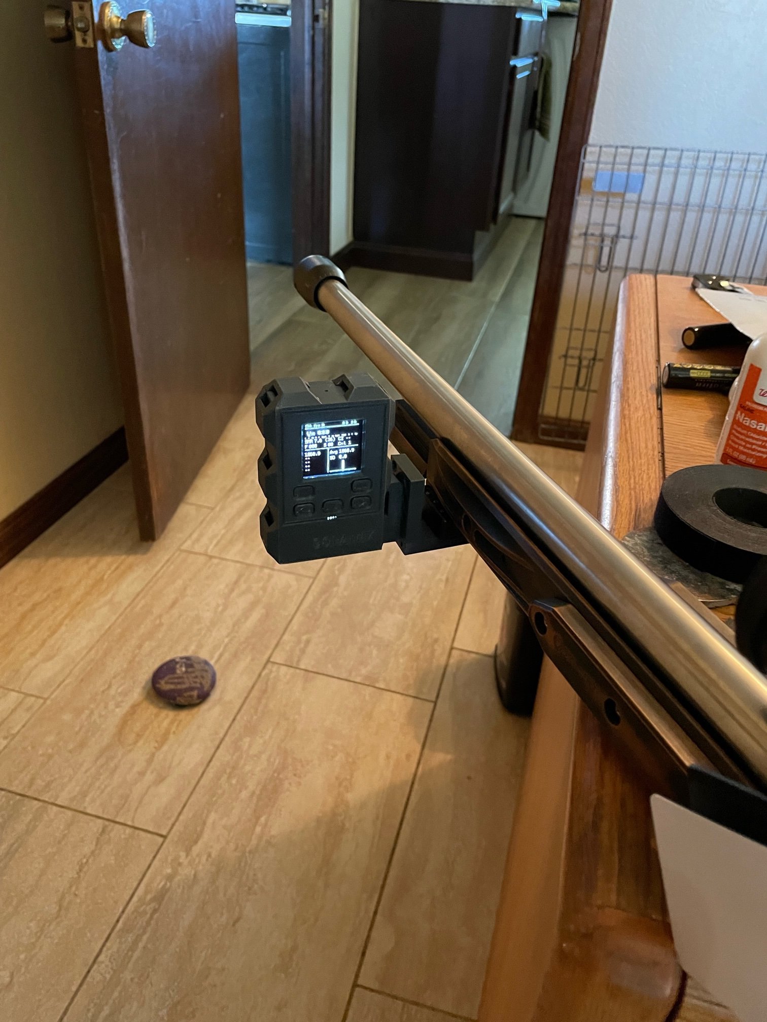

Here's the adapter I built.
If you connect the AS to action's pic rail you need to set the trigger to 1. It wouldn't read on my 22 LR unless I moved it to the end of the chassis when left at the default of 9. Once I changed the trigger to 1 it reads every time no matter where it's attached.
I asked the seller about the 3D printed body versus injection molded that f-class john mentioned and he said he would most likely be keeping the 3D print. He said something about it being as tough as injection molded. I've been playing with a 3D printer and am shocked at the strength of printed parts so I have no reason to doubt him. It may look cheap but it doesn't change functionality.

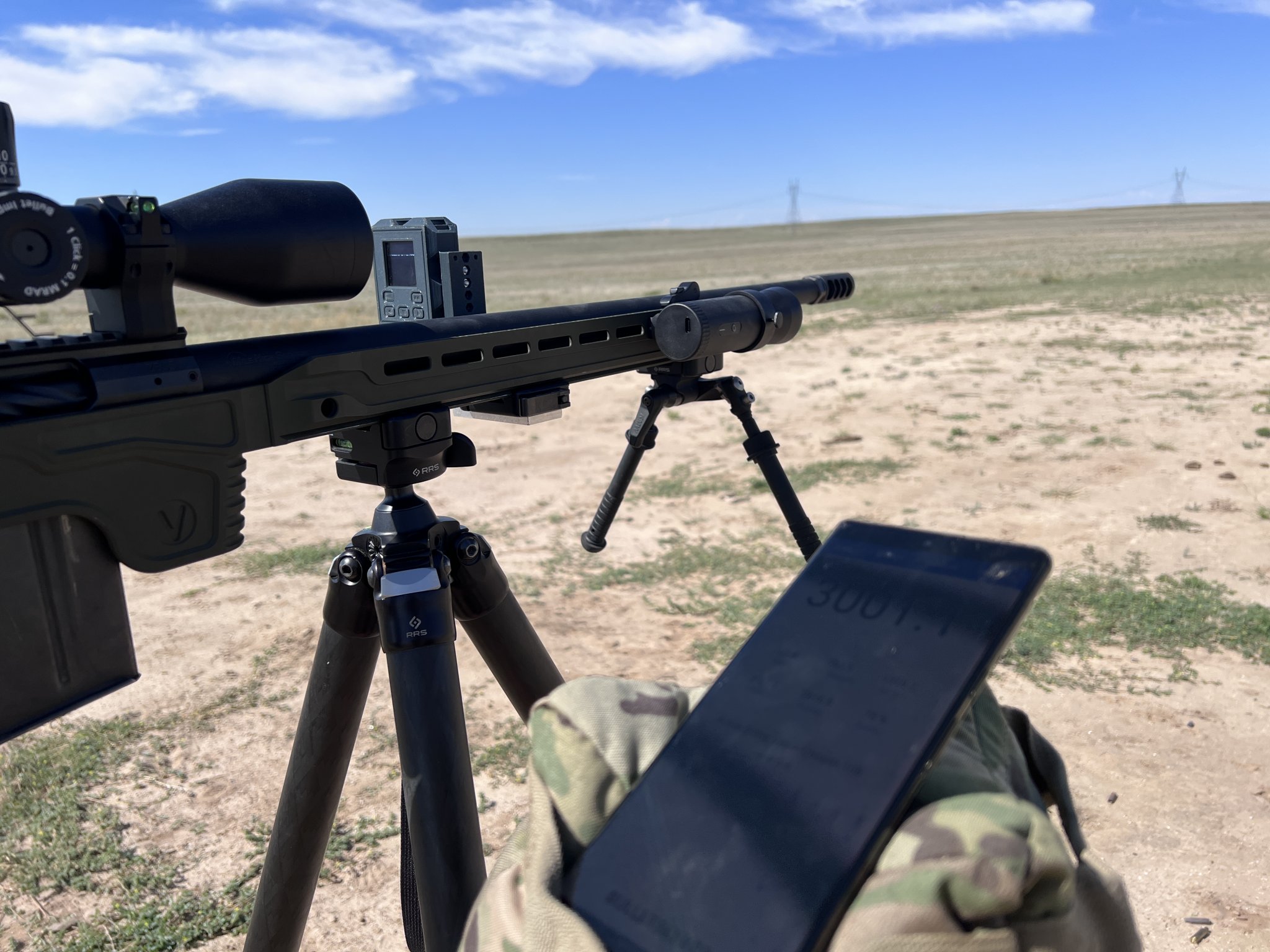

I went for a BulletSeeker in the end. So far, happy with it. Initial assessment:
- Very compact unit, can keep it in the range bag (versus the extra bag and bulk of the Labradar)
- Picked up every shot without fail. No triggering complications. The unit doesn't rely upon an acoustic or kinetic (recoil) trigger like the LR.
- iOS app is still in beta, but seems to work reliably. Lots of potential for adding features via the app.
- Excellent support from the manufacturer. Both sales and technical support responded within hours.
- More convinced about how MV is measured with the BulletSeeker which collects hundreds of tracks from within a few feet of the muzzle. The Labradar doesn't track until much further down range, then performs a linear regression to calculate the MV (which I've proven to be less than completely reliable as it's sensitive to signal-to-noise drop-off in the LR track data).
- Very expensive, but there's a lot of value in the product, with future potential.
- The unit seems very well engineered, both electronically and mechanical. The LR by comparison is a bit of joke, big plastic box with an unnecessarily large circuit board and clunky layout inside.
- Durability, particularly susceptibility to recoil to be determined.

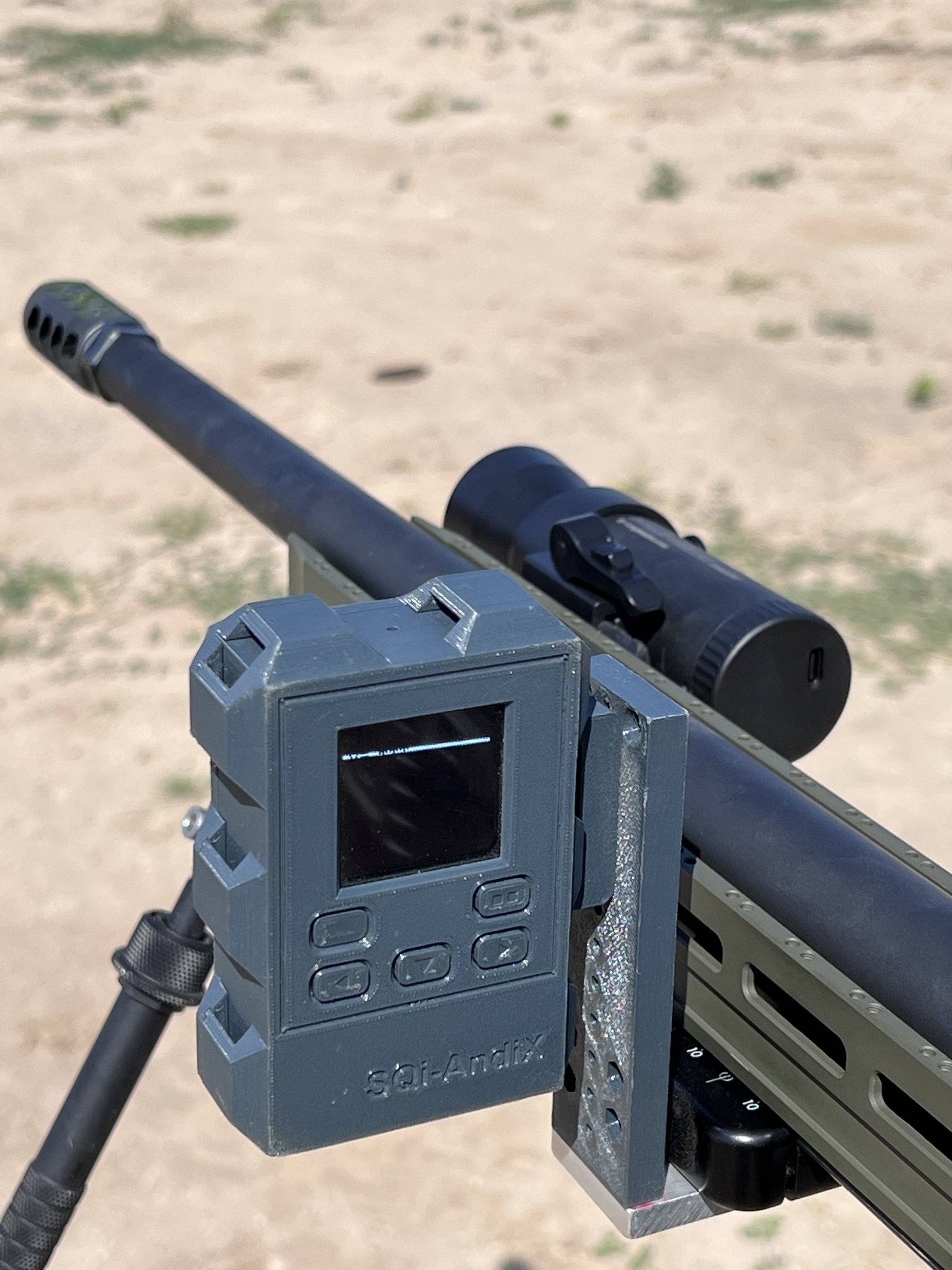

Received the Andiscan today.
So far, pretty tiny! I mounted it onto my Spuhr using a spare A-0032 mount
Edit: you add... It took 7 days from CZ to Left Coast via UPS Expedited Worldwide.

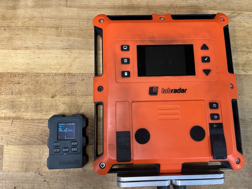

I was looking to replace my Optical with a lab radar unit. Fortunately, they were OOS and I stumbled upon F-Class John's video of the Andi-Scan. I put my name on the list and when they were in stock snagged one in October. Mine has been very reliable and the menu's take some getting used to, but make sense after you play with it a bit.
The size is the selling factor for me. I didn't need another large piece of kit to drag to the range.
