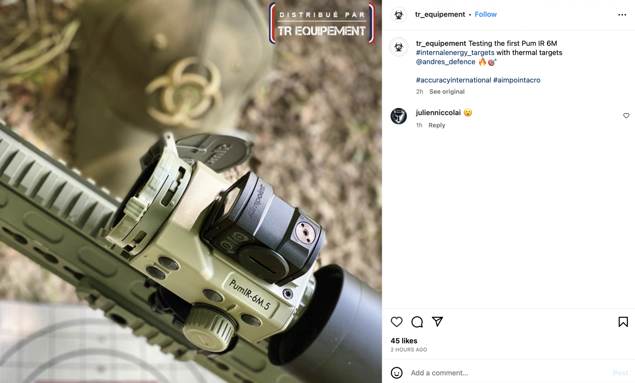

    I know they were at some european industry show last month, any word on these? @pmarkov have you heard anything else from them?
    They posted this today, so the product is not dead...
