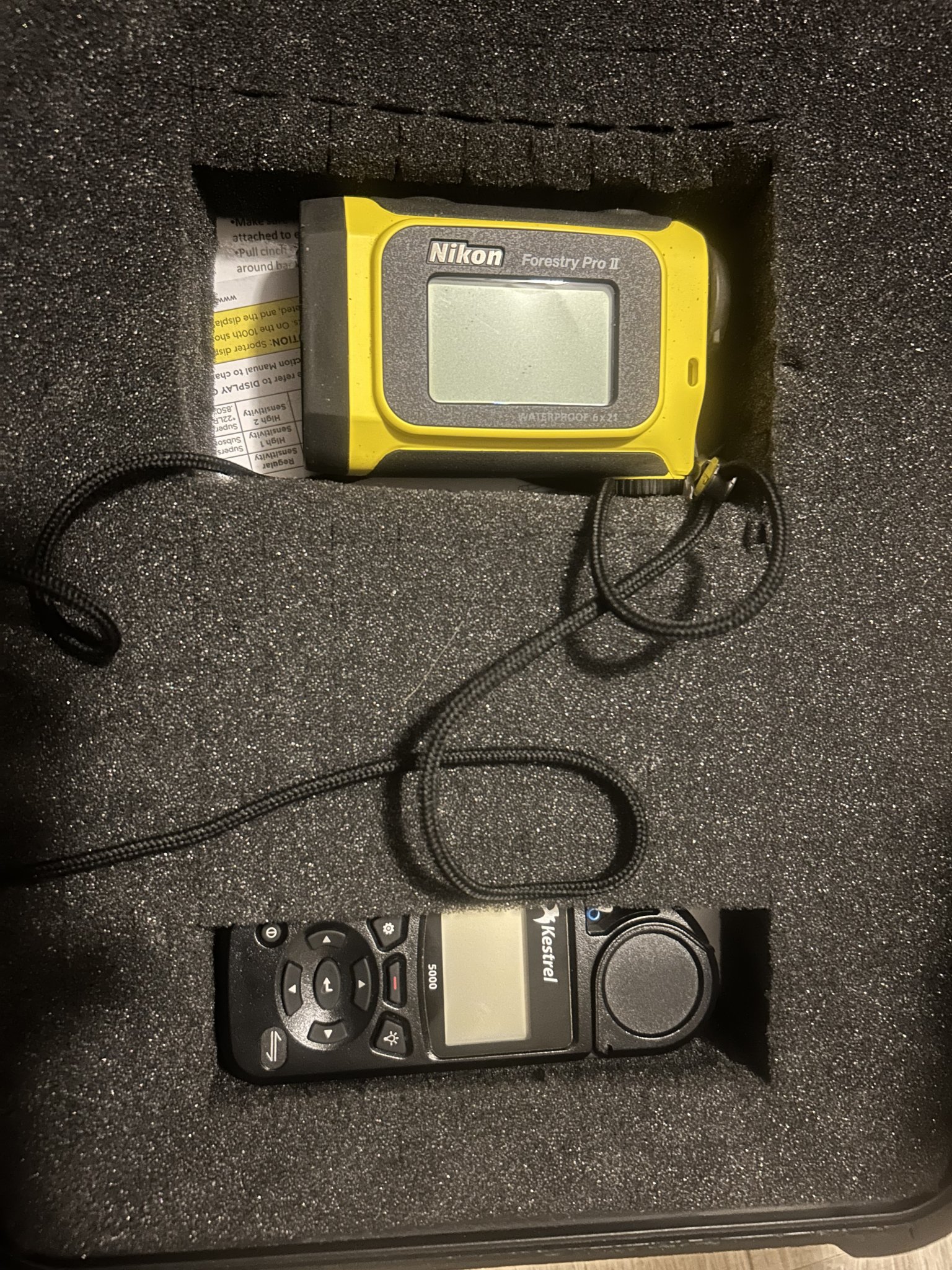

You dont have to buy a ballistic kestrel. Almost all kestrels collect almost the same data. Most environmental factors used in shooting are used in prescribed burning and pesticide spraying. You can get an industry model for 200.00. If you know a registered forester you can get them to order it for you for 7-10% off
Buy one and plug stuff in manually to your own calculator.
Just get a 2500 or 5000 series and you het the same data as the balistic models. They just dont connect to an app.
Mine goes from spraying during the week to the range.
Reactions: KYAggie
