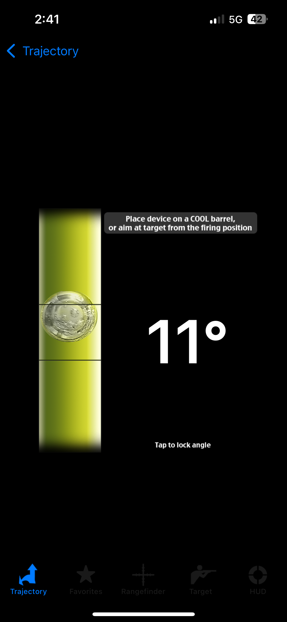

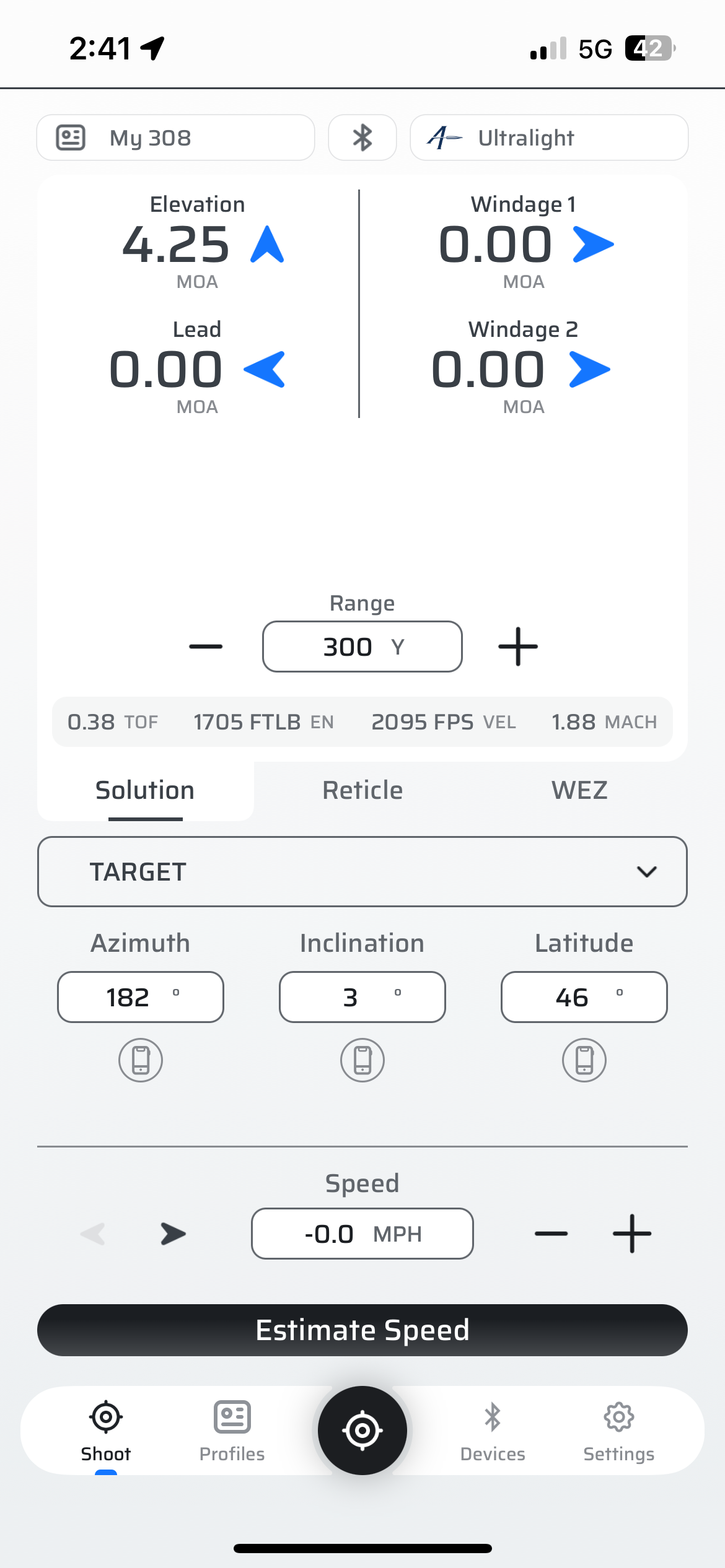

Are there any apps that can "feel" the angle of the phone?
Some large cliffs - yes. I came up on a moose while elk hunting. 254 yds away but perhaps a 70* down angle shot. While moose are tall, from that angle they aren't fat. All I need to do now is draw a moose tag.
There are apps. Also ABQ can pull inclination angle from the phone,
So can Ballistic AE

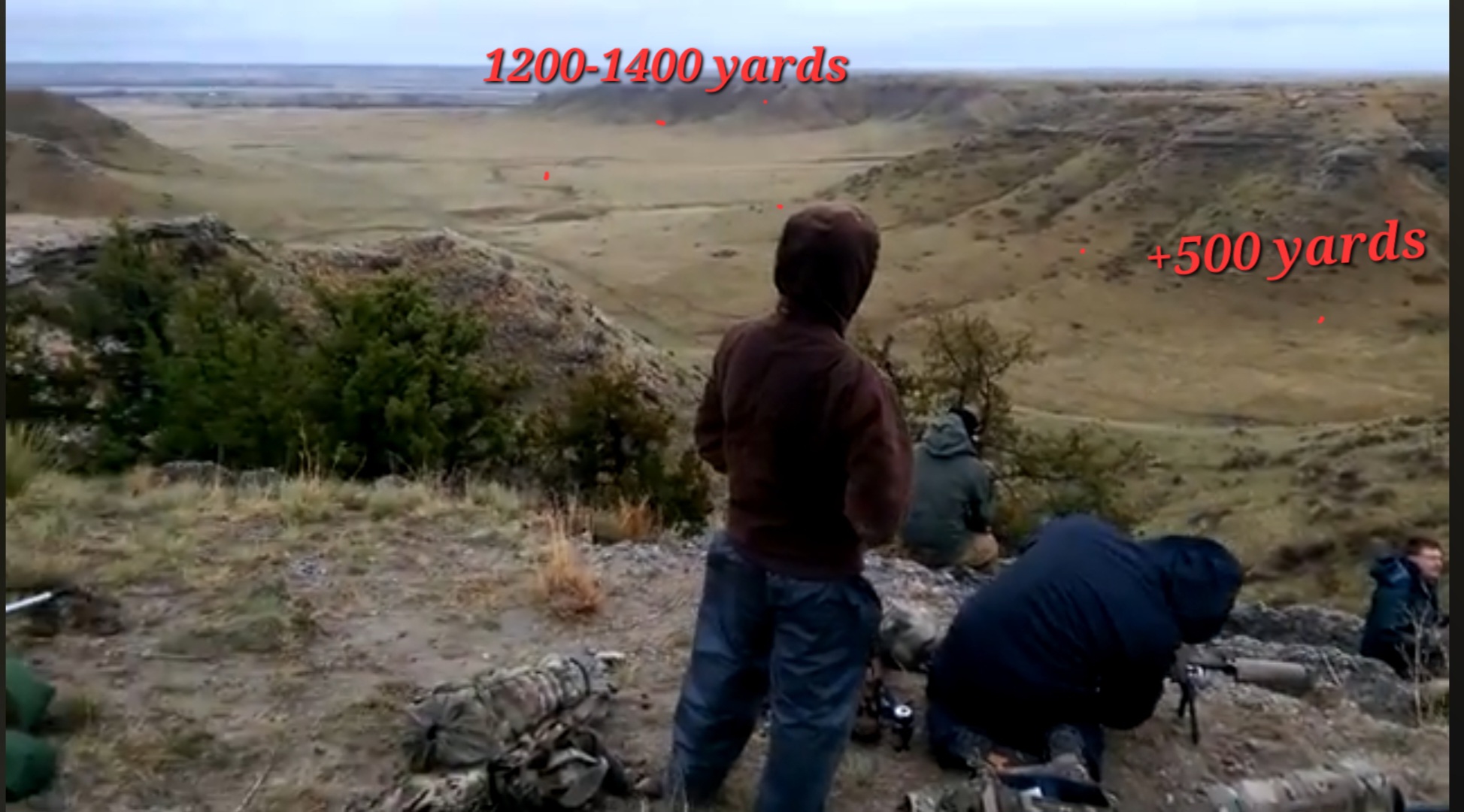

Just run both of the numbers. Sure....most people will never get a 1250yd 45° down angle shot and some instances might be minor error. But it's the really long shots or really windy days you're gonna be happy you knew to reference both.
This match had somewhat mild angles but long shots in ridiculous wind.
