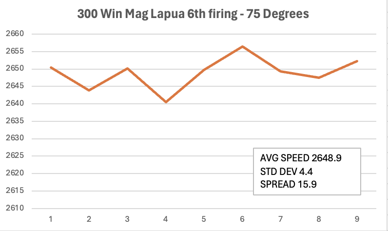

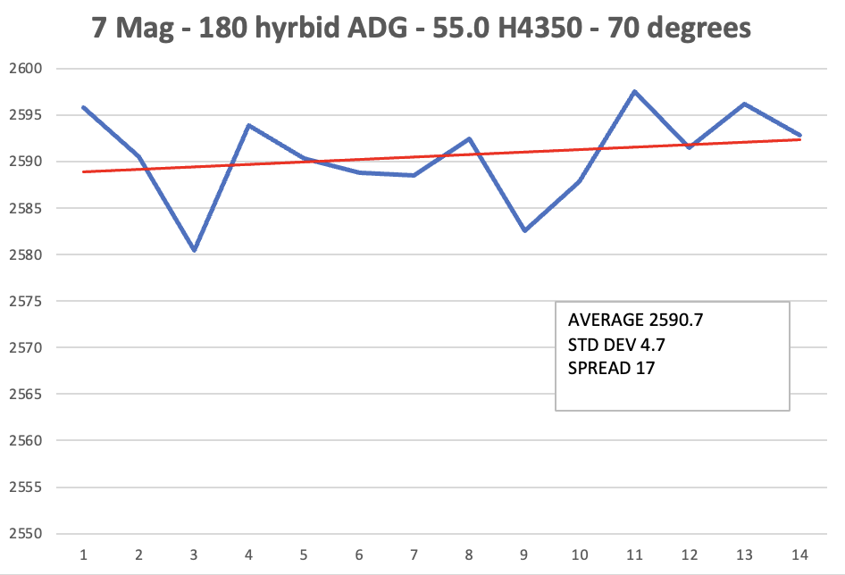

In case you have been dissuaded by any myths, here is the 6x fired Lapua I shot on my last outing - never annealed.

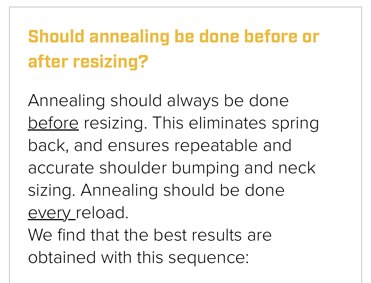

Also, you might consider annealing after you size. I think I read on amps website that sizing a piece of brass work hardens it more than firing it does. That way when you see your bullet it is in the annealed state. Not annelaed and then work hardened again.

If Benchrest accuracy is your goal then you go down the rabbit hole. If say 1 moa is good enough then load accordingly. Here’s a pic from the Amp website. I anneal every firing and keep Lapua brass sorted by lots. Then again I’m trying to put every bullet through the same hole. I didn’t buy the Amp for brass longevity . I bought it for consistency .
the only way someone might be able to understand their neck tension is with an AMP mate or a hydro in-line. There is no data to correlate those seating pressures to sd/es. if it is that much of an improvement to anneal, we should see lots of people regularly shooting SD/ ES lower than mine, yet you rarely see 7+ round groups below 3-4 SD.
This all leads me to say that you will do more harm than good by annealing for 90% of people - however I agree that use of an AMP annealer will extend brass life by some margin (debate if that's actually a good thing)
How would automatically feeding your AMP help you know anything about your neck tension?
If Benchrest accuracy is your goal then you go down the rabbit hole. If say 1 moa is good enough then load accordingly. Here’s a pic from the Amp website. I anneal every firing and keep Lapua brass sorted by lots. Then again I’m trying to put every bullet through the same hole. I didn’t buy the Amp for brass longevity . I bought it for consistency . View attachment 8386518
See. Now you have to anneal before and after sizing, lol.
But seriously. I think you could neck that assumption down a little bit. I don't think you need to anneal every firing to shoot 3/8 in groups. Much less moa
FWIW, brushing the necks after annealing is generally all that's needed to alleviate the cooked carbon issue. Some people even advocate for just brushing before annealing.
