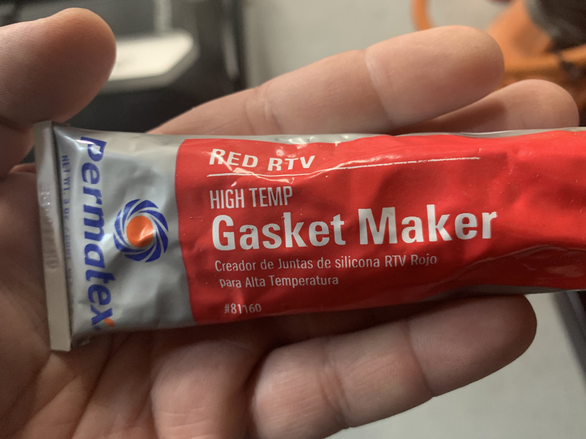

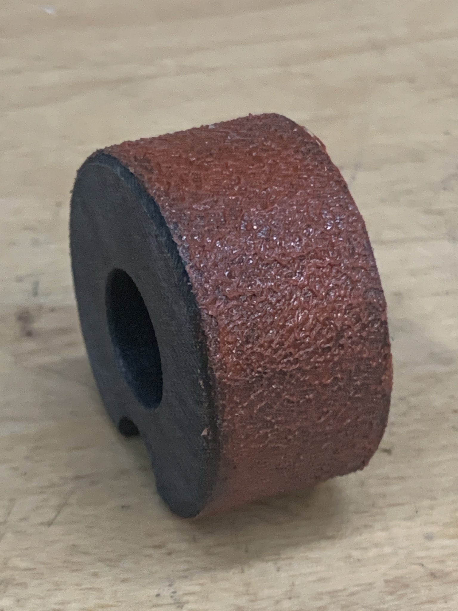

I had the same problem.
Peel all the thin blue garbage they put on there from the factory and clean with rubbing alcohol.
Head over to your tool box and grab some high temp Permatex and apply a very thin layer. Once you have it spread out, tap over the material with your finger (touch and lift without rubbing across the material) so little ridges are left to give it texture for gripping.

Looks just like mine.
