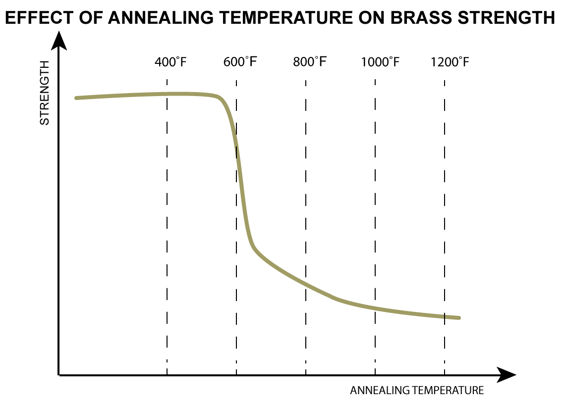

Get it above 600 and the stresses will start to relieve. Use the 750 tempilaq like everyone says to and you’ll guarantee that you hit that dip in hardness with anything above that, within reason, you’ll be fine. Just don’t go where the tensile strength is less than the hardness.
When you can crush a case mouth and it doesn’t spring back too far you’ve over annealed. We don’t make it dead soft, we just relieve a little strain in the grain. We need interference fit between the brass and bullet which is referred to as bullet grip. If the brass isn’t gripping the bullet it’s not going to work as well as it could.

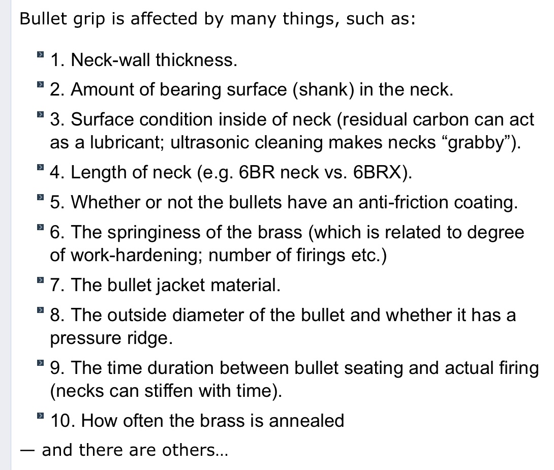

We should stop calling it neck tension and instead refer to it as bullet grip.
And yet the most emphasis is put on annealing and neck tension.
What is the rockwell hardness of your brass at the case neck and what is the coefficient of friction between your bullet and case neck?
Exactly. As you stated, brass tension is simply one measurement of the whole, effecting the friction or resistance of the bullet to leave the case.

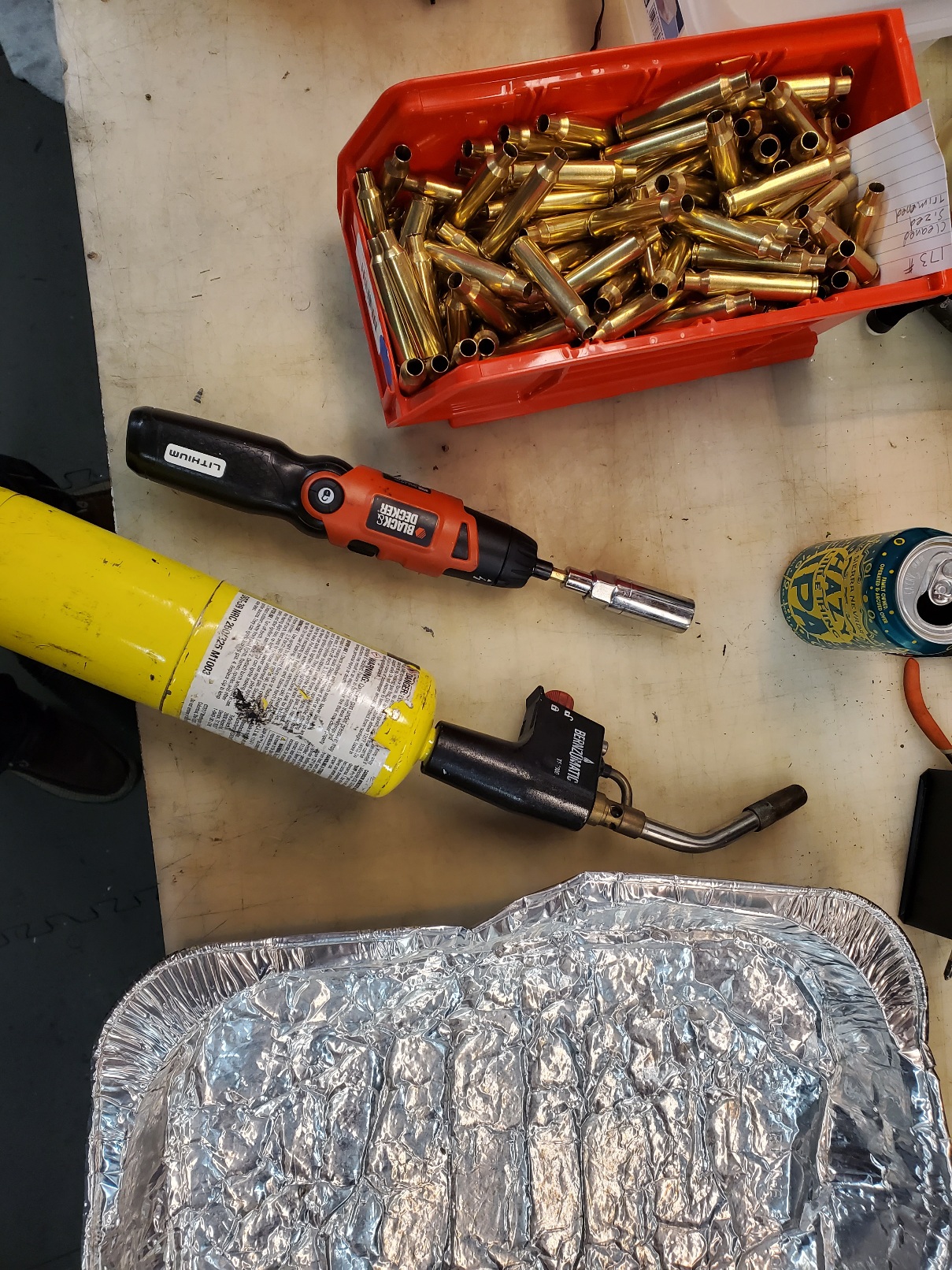

Chuck up a socket, drop the case into the socket, run the drill while you hold the case neck in a flame, tip the case out at some poorly defined moment. Repeat.
hhah thats what im trying to figure out
Its takes skill to be able to get it perfectly annealed using a drill. The key is a dark room and you want the color between crimson and cherry red. Thats between 650°F and 850°F and that puts you between 60 and 80 on the rockwell hardness scale.
