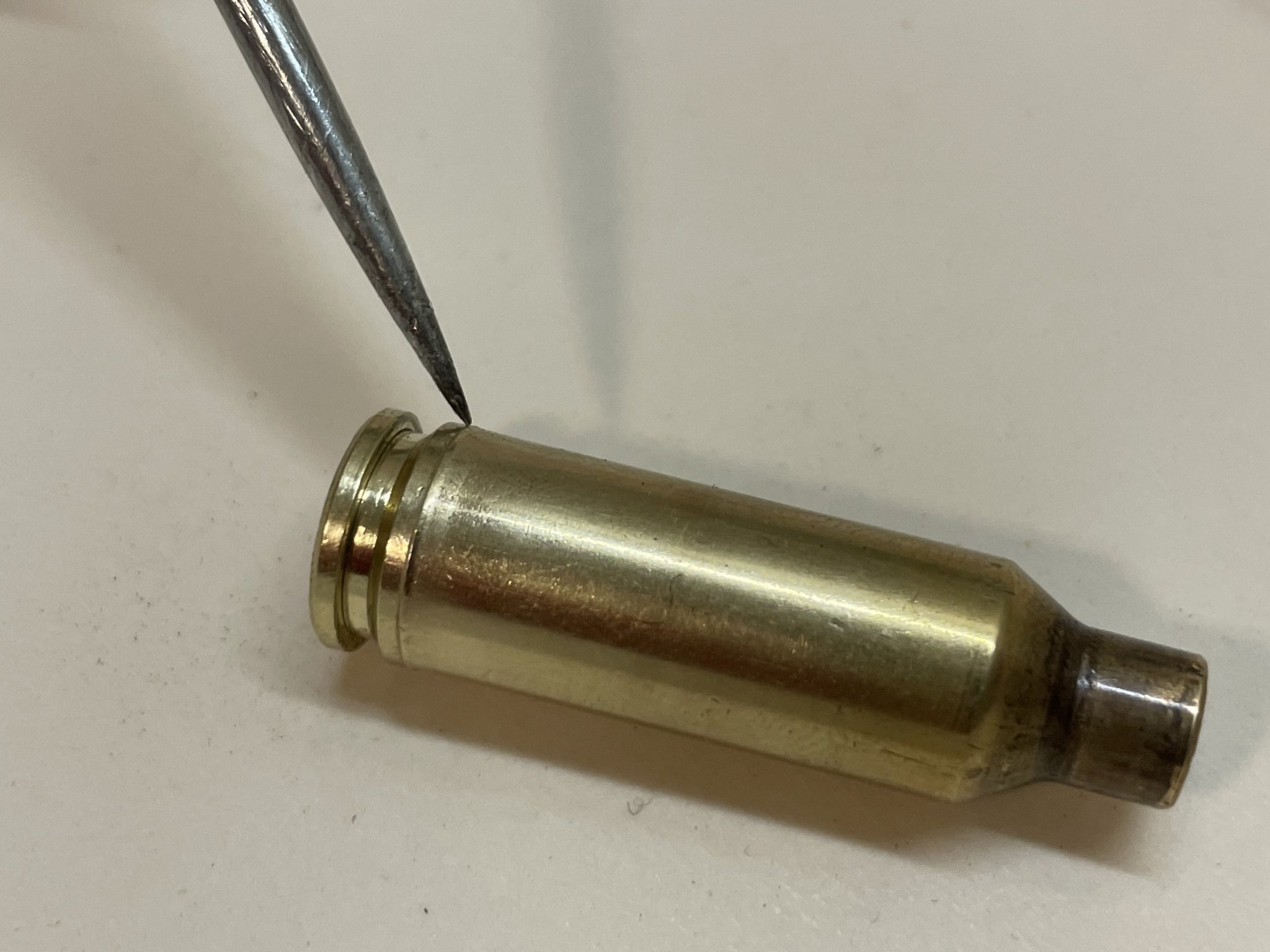

This is Hornady 3x fired 6mm arc brass fire from a gas gun.
Can someone help me with where I went wrong? This ridge wasn’t there before sizing. Not all brass does it. Is it because this piece was overpressured or am I doing something while sizing to cause this? Annealing heat getting too close to the head?
what is your load / powder / bullet weight? I would guess over pressure. Measure a case at case head and about half inch towards neck from case head on new and your 3x fired.
Check and clean your die, make sure you are using enough resizing lube.
What die and what lube are you using?
I have had that before on my 222 it was the die, only did it on certain brands of brass. Sent it back
to hornady and they either fixed or replaced the die.
Reactions: Ravenworks

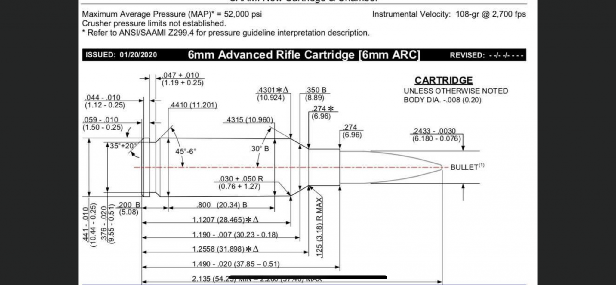

You need to measure the case at the web. Looks like your die squeezed the case wall below the OD of the web, which could indeed mean that the case head stretched. I’d expect you to have loose primer pockets as well if that’s the case.
Compare the case web OD to the cartridge spec, if it’s too big you stretched it. If not, you have a die problem, although I’m not sure what. Too much lube typically manifests as dimples in the shoulder, not your thing. If the die was undersized, I’d expect almost all your brass to exhibit the problem.

I just measured some first fired factory ammo brass (Hornady) and it’s slightly larger than new factory ammo but still within the cartridge specs.
I’ve heard someone somewhere say to see how easy the cases crush with pliers vs cases without the issue… the problem cases were pinched slightly easier. I’m leaning towards case body/head overheated.
Which means all of these cases with the issue are junk right?
What are the measurements/dimensions?
Problem cases are now 1-2 thou over the .441” at the head.
I have some that are partially to fully bulged larger than spec but still successfully full length sized now. The tough ones to size never fully bumped the shoulder either probably because the ridge prevented the die from going down any further.
Then yeah, I’d say just toss ‘em.

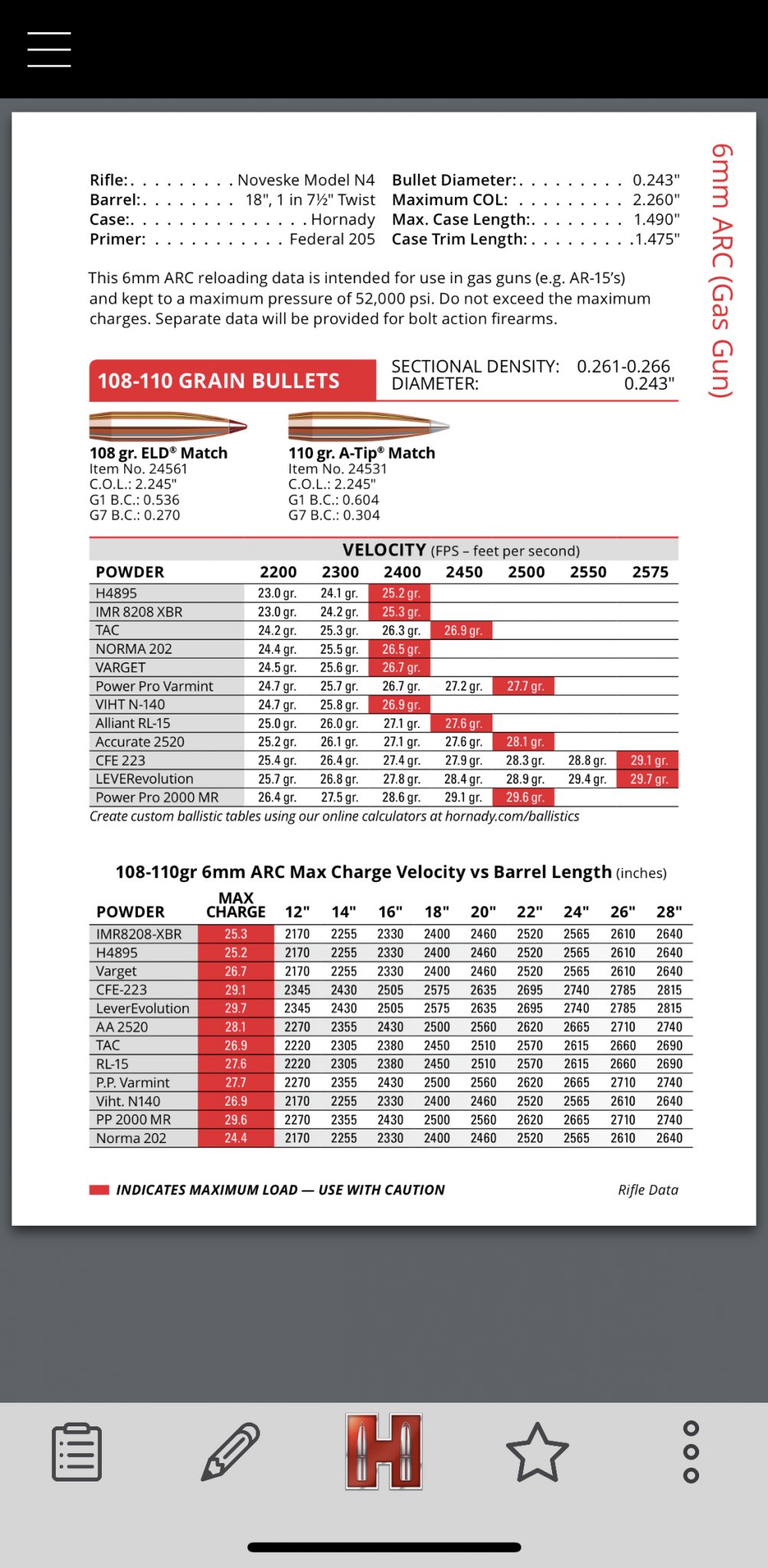

Lately it’s been 29.4 gr LeverEvolution 108 eldm but some of the 2nd firing had up to 30.0 gr. It looked good this spring but summer time it got hot and I’ve been learning a lot about everything from gas systems, cleaning, temp instability, and brass prep the hard way for the past 6 months! Lol

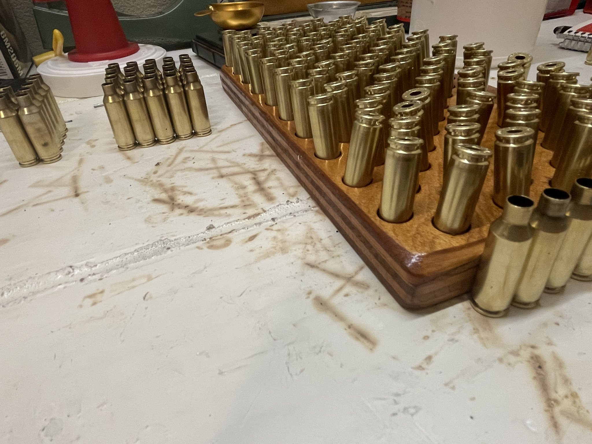

Of the ~145 cases I annealed, here’s where they checked out:
8 never fully resized, immediately put aside. Clearly out of spec.
25 fully resized but show a slight ridge. Barely out of spec but otherwise would’ve been loaded if I didn’t just check for it.
107 show no signs and I didn’t find any of these out of spec at the head either.

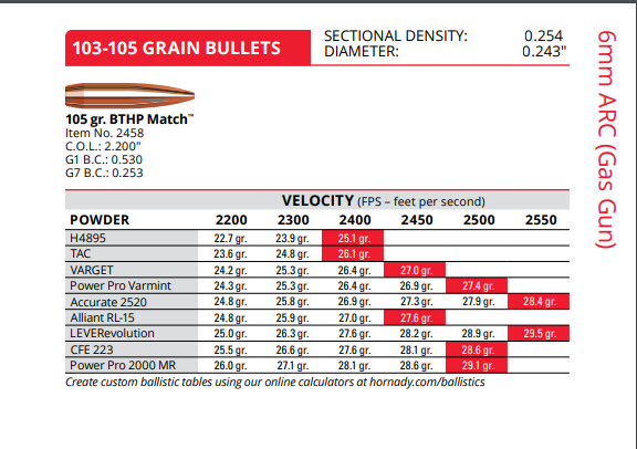

I hear of folks running 29.8 for the 103, 105, and 108’s without any pressure signs.
keep in mind just because it works for other ppl does not mean it will work for you...for instance i know and shoot with @Gwian...he just had a barrel that was causing pressure issues...same brand..same smith..same reamer..same loading components..same action everything the same as a few other barrels prior but this barrel was a no go.
agreed. I’ve seen the majority of folks getting good results between 29.4 and 29.8 gr with the same barrel so it helps me manage my own expectations. But I’ve got a bundle of issues going on plus learning the basics of reloading still obviously! so now that I’ll have the annealing not jacking up my brass, my load development 500 rounds into the barrel should start becoming valuable! Lol
