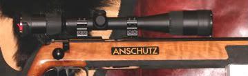

I need to pick up a new mount to go with a new scope that's coming soon. Tube is 30mm and the receiver is a 54 Match.
I don't know if I should pick up something like the BKL mount and use the Annie's built in rail, or get an adapter from MWerks and some rings from Kelbly. I'm itching for those Kelblys but if I don't need them, I don't need them.
Re: Annie 54 bases and rings
Mac1 airgun makes drop compensated rings that will fit your Annie's
dovetail. I use them on my 54:18 msr.
http://www.mac1airgun.com/droopers.html
