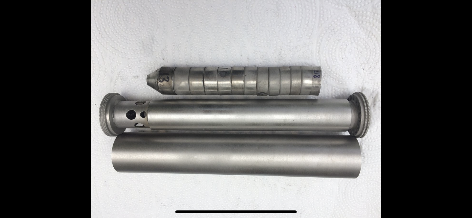

I got approved for one, now I just need to get it built. Going to be 2.5”-3” in diameter and 18” long. It is going on a 24” barreled rifle.
I’ve built all of my silencers.
I might do a bigger version of this one. E625DBCA-E13D-4822-A356-5B810FA56254.png
The inner tube is stainless tube that is 1.25” in diameter and holds the 13 cone baffles made of 17-4. The outer tube is 1.5” and the end caps screw into the inner tube to compress the 1.5” outer tube made of .035” titanium. The holes in the blast chamber vent into the space between the inner and outer tubes. It is a 30 caliber can and is as quiet as any commercial can I have shot with it. Supers are really good sounding but subsonic loads out of my 300 Blackout Encore are magical. Using super fast pistol powders you can hear the bullet flying through the air.
