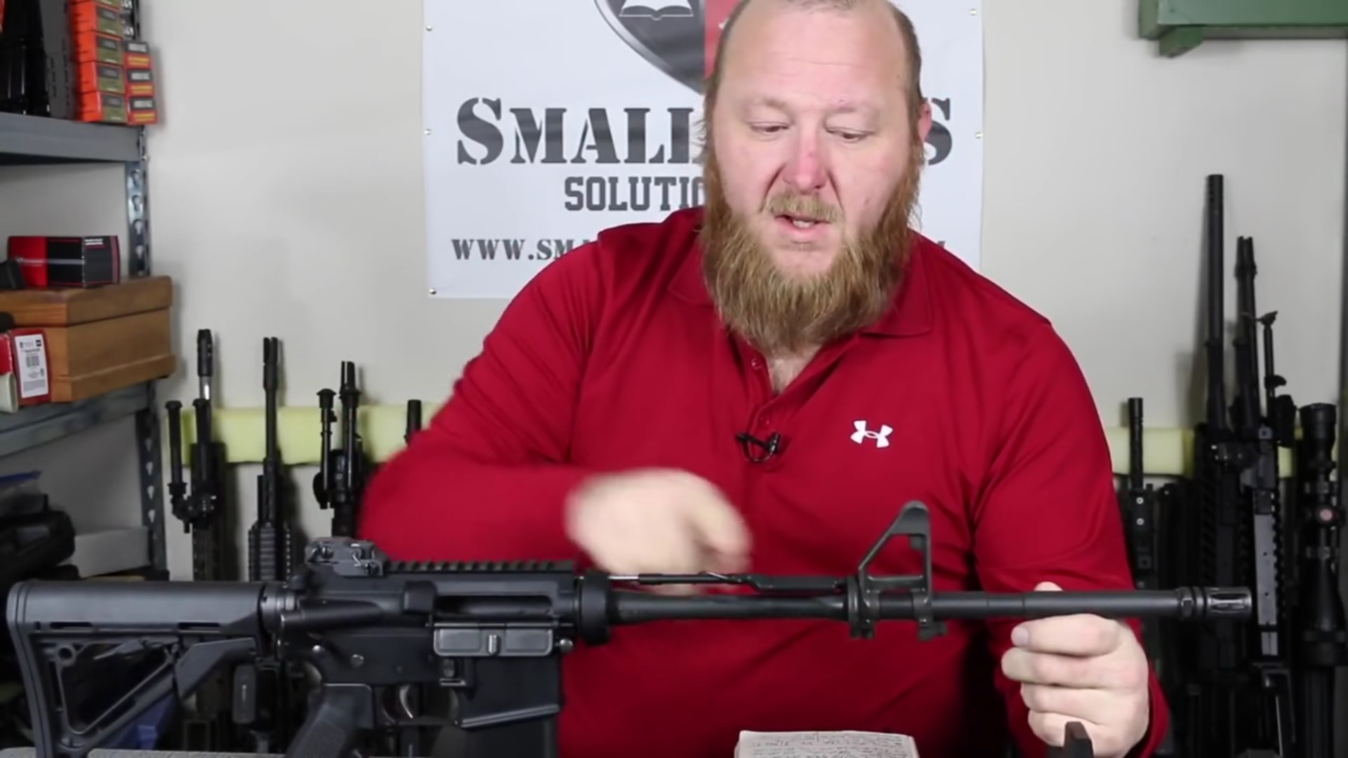

If anyone has a Osprey Defense piston kit installed, how long is the stroke on your operating rod before it contacts your barrel nut?

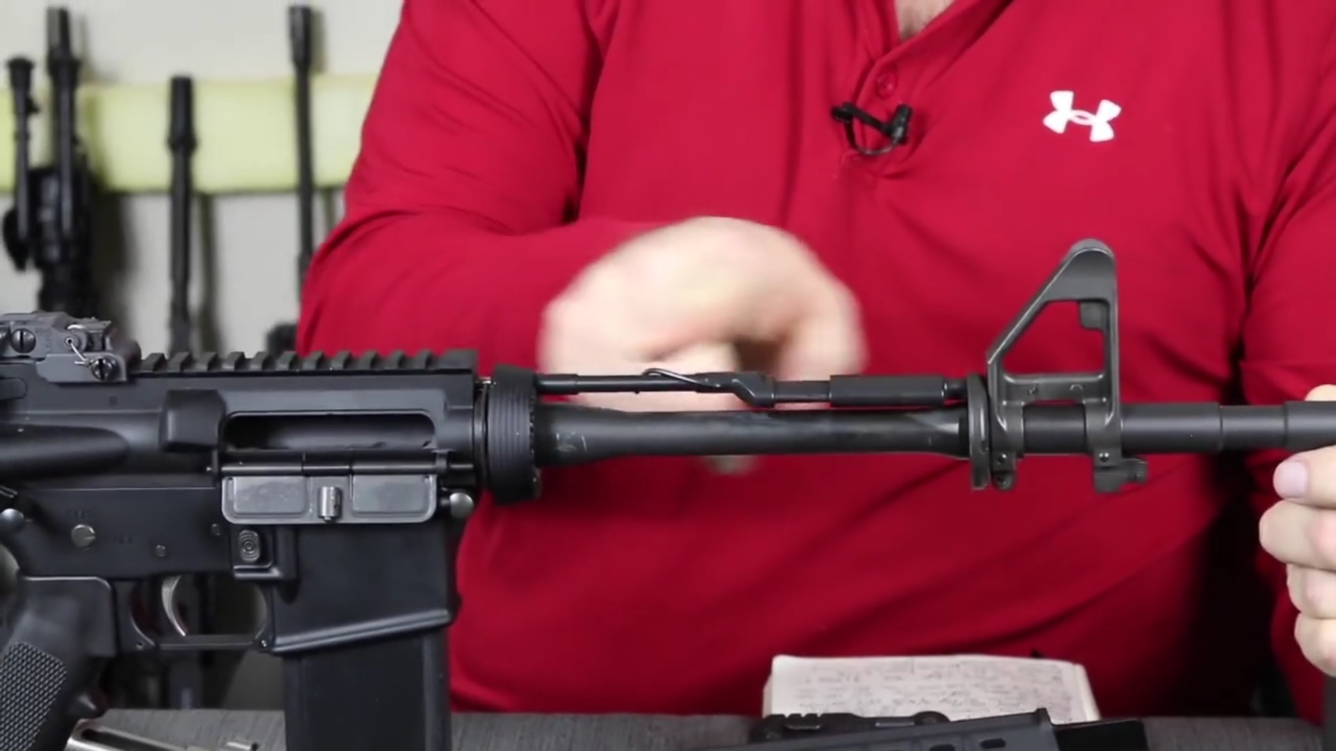

Small Arms Review did a video on the Osprey 416 piston conversion (https://www.full30.com/video/8fc064a60bfdc6a1c67c67ca622d4839). I don't know if this is the current version. In the vid, the op rod looks to move less than an inch before making contact with the GI barrel nut.
Op rod full forward:
Op rod fully rearward:
You folks are great! Actually, that video is perfect. Looks like it moves until the swell at the head of the piston is still just inside the chamber. That will let me measure. Time to get the endmill spun up!
