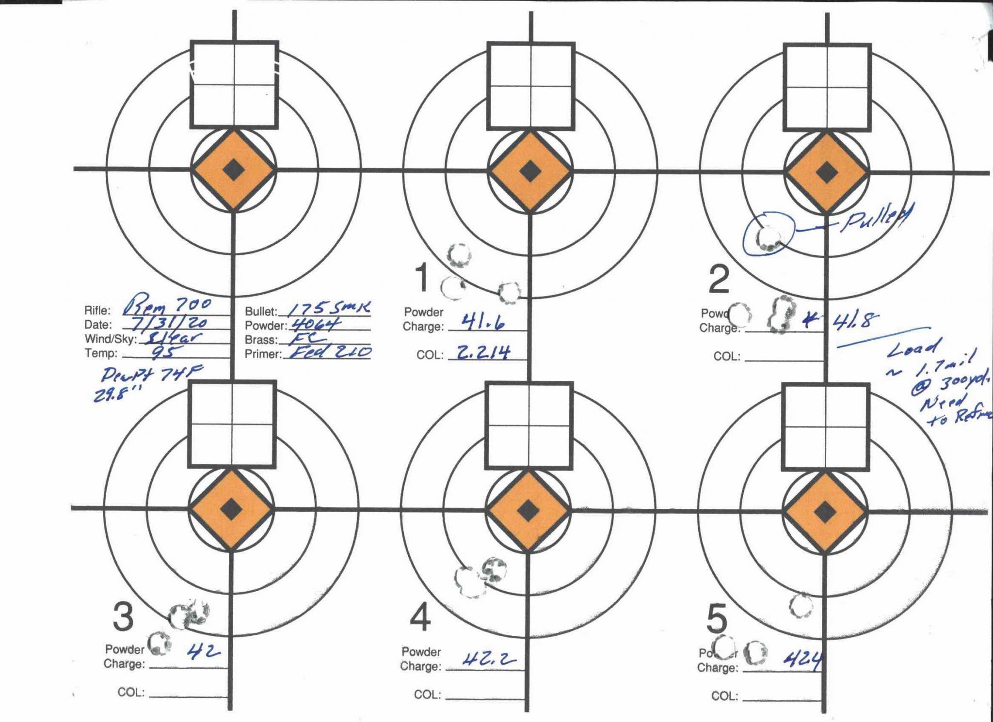

Depending on the lot, you may need more than 41.8 grains of 4064 to reach the accuracy node, regardless of observed velocity. There is more to accuracy than velocity. Also, play with the coal. Sometimes 2.795” does the trick.
I worked up this combination in my SPS Tac (1 in 12) and found accuracy at about 42-42.2 gr of 4064. I didn't record COAL but I believe its about the 2.795 mentioned above. Not real comfortable on the POI shift but I was looking for the FGMM node. My 168 node is quite a bit wider.

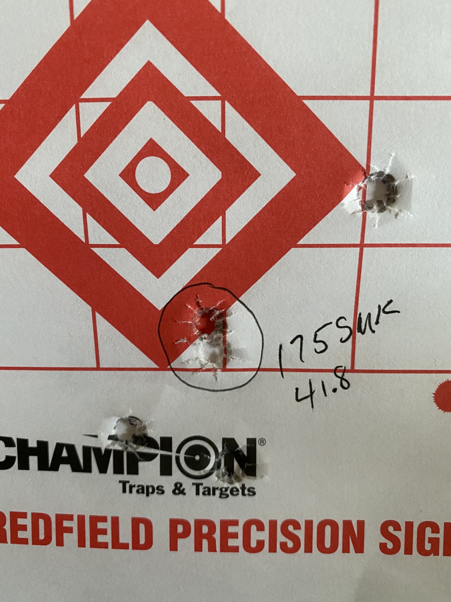

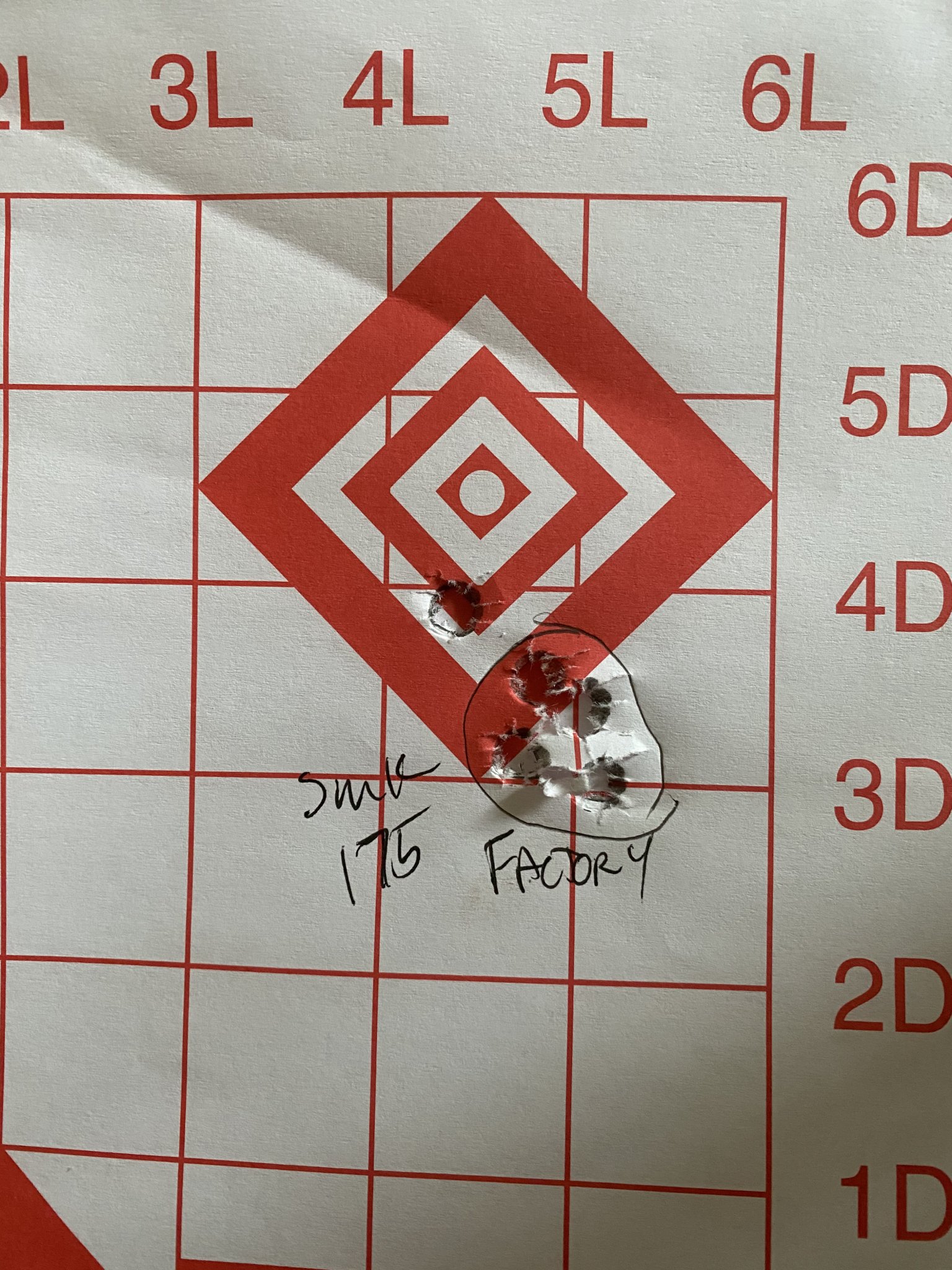

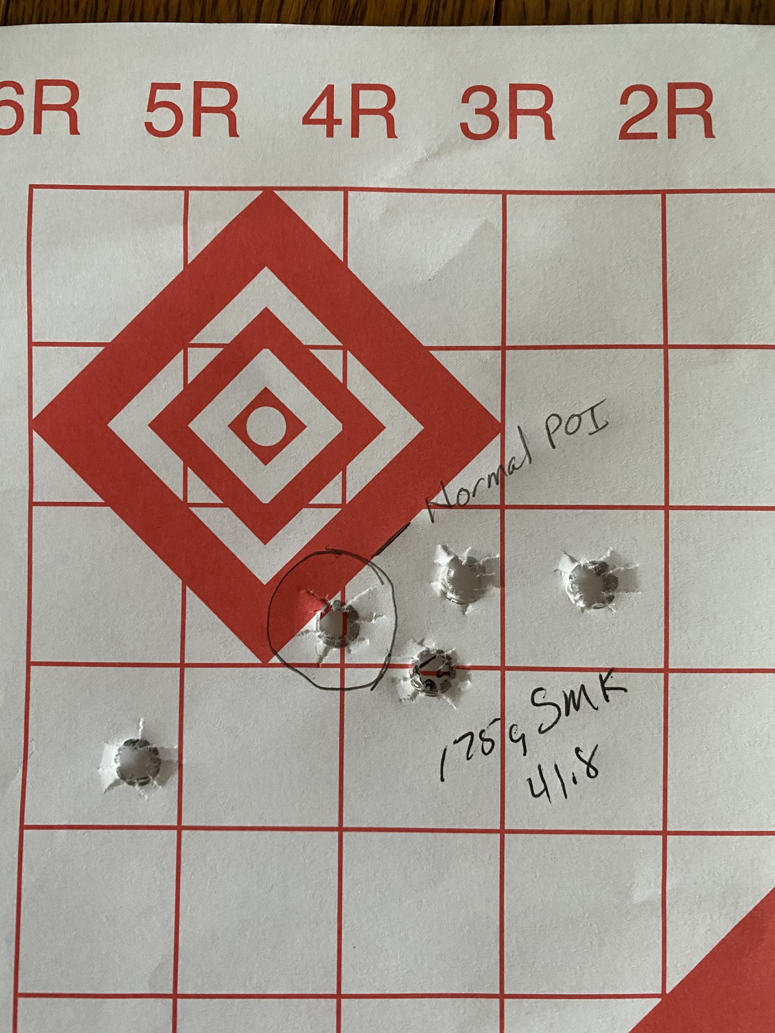

Ok, I went back and reviewed the targets I could find. I did work up to 42.2 at one point but not seeing much accuracy improvement in the one group I could find. I settled on 41.8 as it seemed to be the "most" accurate. What I did notice though is that my 41.8 gr reloads have shots that group in the same location as the Factory loads, but there are "flyers" that open up the groups. Could be me, but I don't feel that I am throwing the shots and my groups with Factory loads and 168 hand loads group very well. Is there anything with the brass that could throw a shot off by and inch or two from what is a consistant POI?
View attachment 7467934View attachment 7467935View attachment 7467936
Then play with the coal, go up and down in .005” increments measuring the seater stem, not the bullet tip.

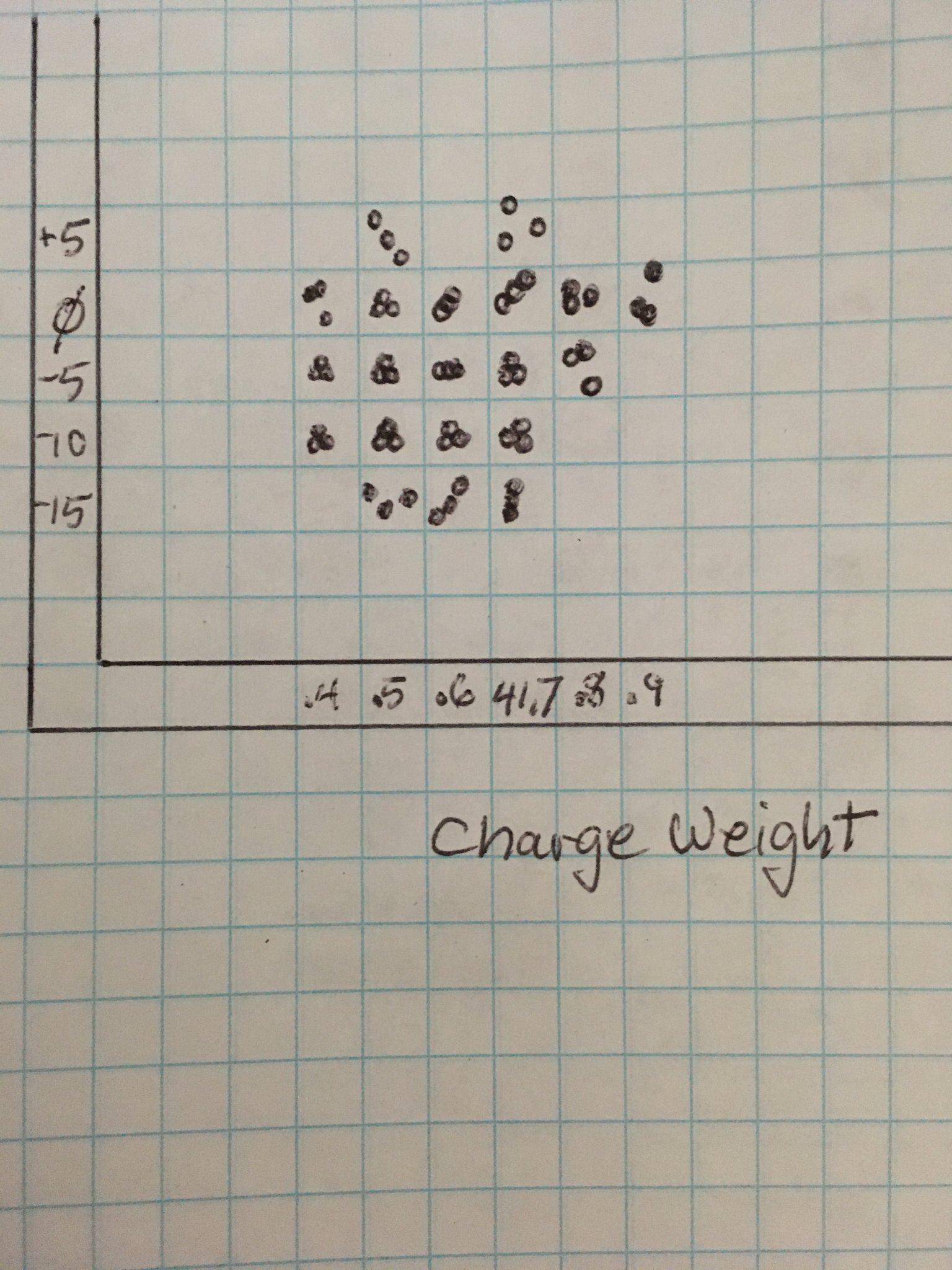

Plot coal vs charge weight otherwise you’ll never get it. This is what I do:

Looking at the targets I’ve seen this issue before. Tried to blame it on .... but the real problem was the trigger operator. I can’t say that’s the issue here but I doubt its a powder issue. I will say that brass prep may be a contributing factor and I would address that.
It could be me but every time I shoot factory loads my groups are significantly better, so I’m leaning toward reloading process. Many people seem to have had good results with 41.8ish of 4064. I have considered neck tension and resizing in the past, and tried to manually anneal but wasn’t comfortable that I was doing it consistently. I broke down and ordered a machine and I have started collecting once fired brass and separating it. I will see if this helps.
