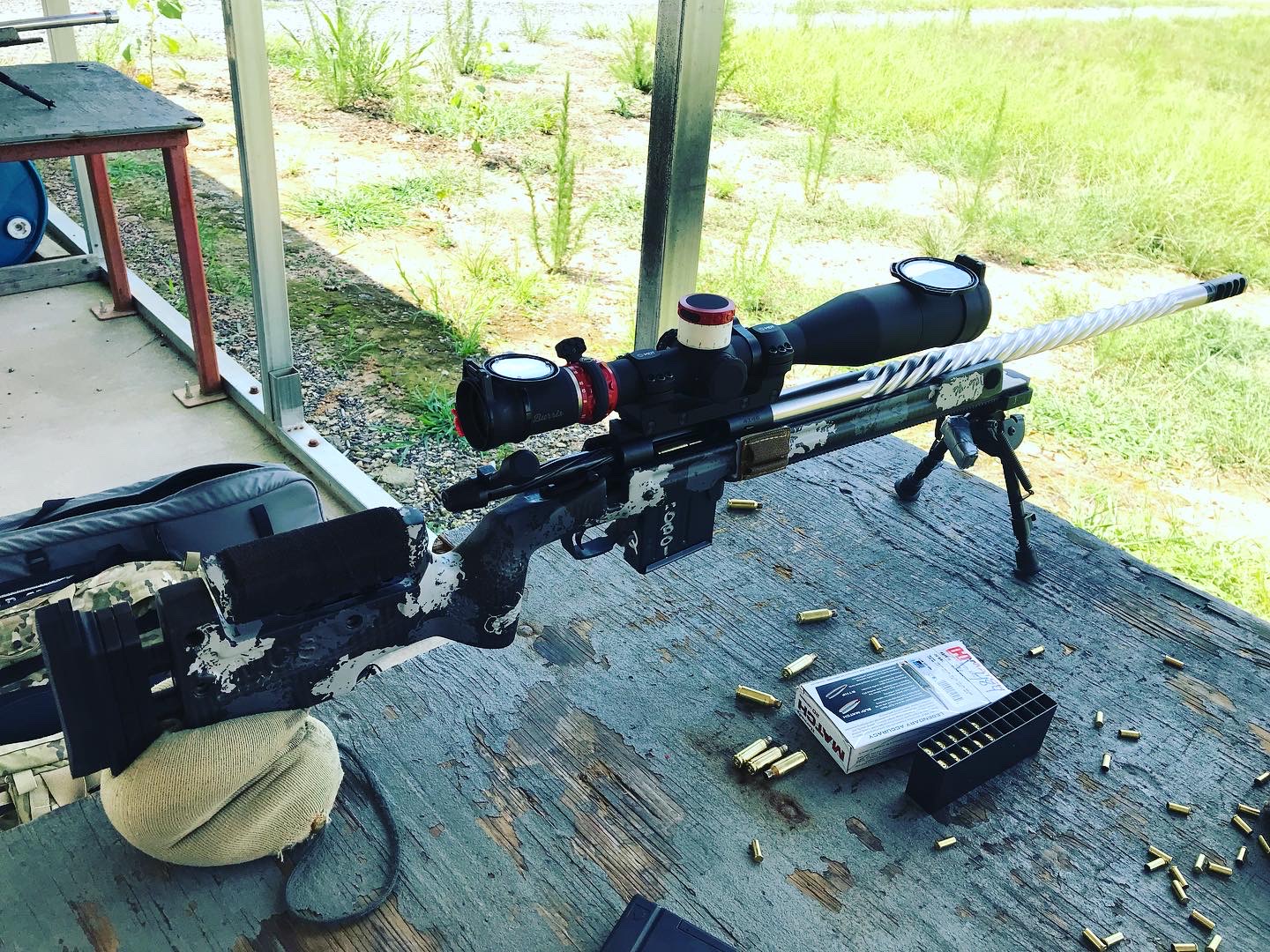

You can do whatever you like. I think it just drops into M24 as a default. And yeah you can do flutes. I did the spiral on my latest 6mm ARC.
Action wrench will just be a Zermatt/Bighorn and there are a bunch of different barrel vises like the one below. No need to spend hundreds on them. Anything that can be tightened to hold the barrel will work. I have mine mounted to the leg of my bench.

What chasis is that?

That’s a Manners TCS stock.
Barrel contour comes down to weight. How heavy you want it? That one in the pic above is the Comp Contour which is pretty heavy which I like. M24 is about the lightest I would go for a match rifle.
