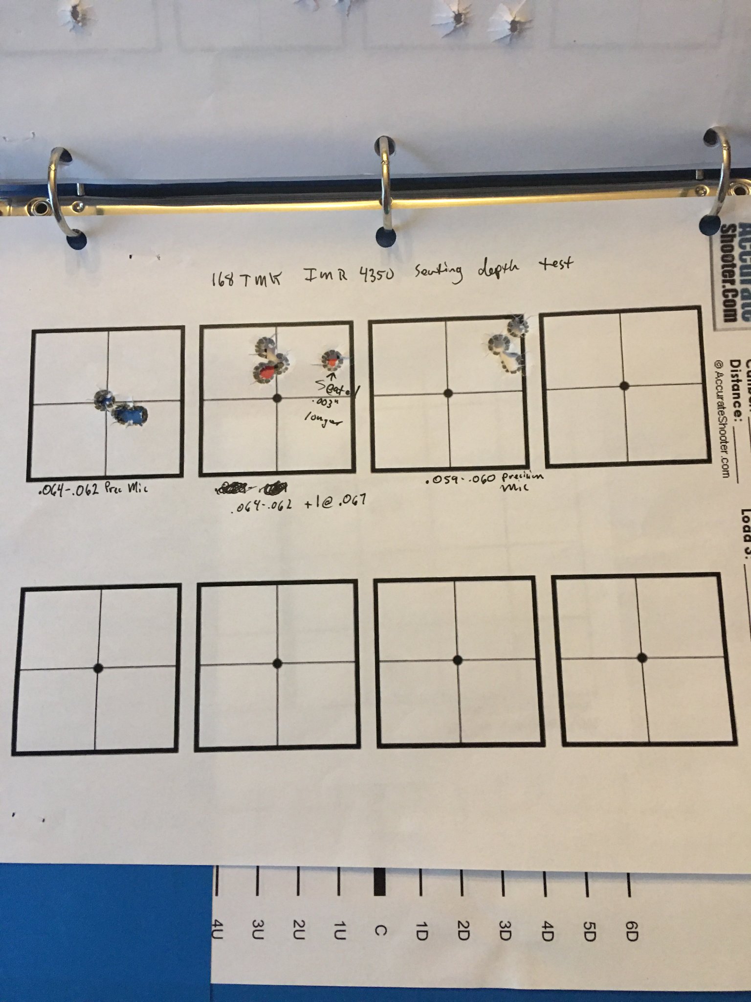

I included a target I shot this morning doing some seating depth experimenting. All shots taken with bipod in the straps of the mat. Far left group, rifle shifted slightly left, had to reposition slightly. Next 4, better focus, and the muzzle finished slightly raised (1moa). The shot out of the group was a different seating depth, seeing how forgiving my load was. Right 3 shots were .003” further from lands. Muzzle ended up slightly raised, similar to 2nd string. Interesting that velocity of the first three shots was 26fps slower avg than the following 7, which had SD of 6fps. Small sample I know.
Any diagnosis from these pictures and description? Any way to post videos without using You ube?

1 MOA vertical is not bad.
Here's the thing, .30-06 is just a fast recoiling sumbitch! Bet you're loaded with a whole lot of H-4350. The burn rate is quick enough that it donkey kicks you. I have a private 800 yard range. I have an 07 FFL. I am fortunate enough to have people hire me for their load development and make their ammo. As well as teach private one on one shooting lessons. I get to shoot all kinds of rifles, and all kinds of different cartridges. .30-06 is probably my least favorite thing to shoot. And that's why. The quick burn rate makes a quick recoil. I seriously would rather shoot a .300 Win Mag with a full house load of H-1000 or H-Retumbo, and a 200+ gr bullet. Those powders are a slower shove, and easier to manage recoil.

Thanks for the input. Yes, it’s a full case of actually IMR 4350. It thumps pretty good. I feel better about things knowing that no more shift than that is acceptable for most. And I agree, except for the fact that I can’t manage it that well unless the rifle is trapped. I get the point that loading it hard is the way to go, but I know that’s not always practical. Due to the fact that it still seems to be “sliding down the ramp” of my collar bone, I know I’ve still got some kinks to work out. To the point that I look too tense, I would agree. If I could post the videos it would allow you to see the whole system in motion. To me, it looks like I’m absorbing the recoil, but I don’t have any other video of myself to differentiate doing it right vs doing it wrong.
