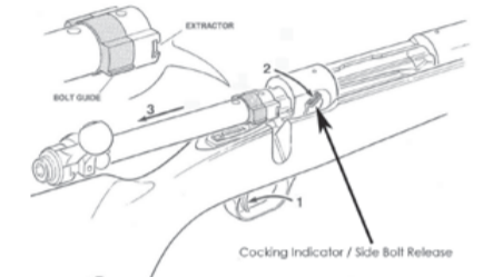

My savages are older, 2 pre accutrigger, 1 accutrigger but still older. I am not familiar with the cocking indicator, is the design similar enough to the older stuff to replace the bolt assembly screw (rear allen screw) and go with a bolt lift kit?

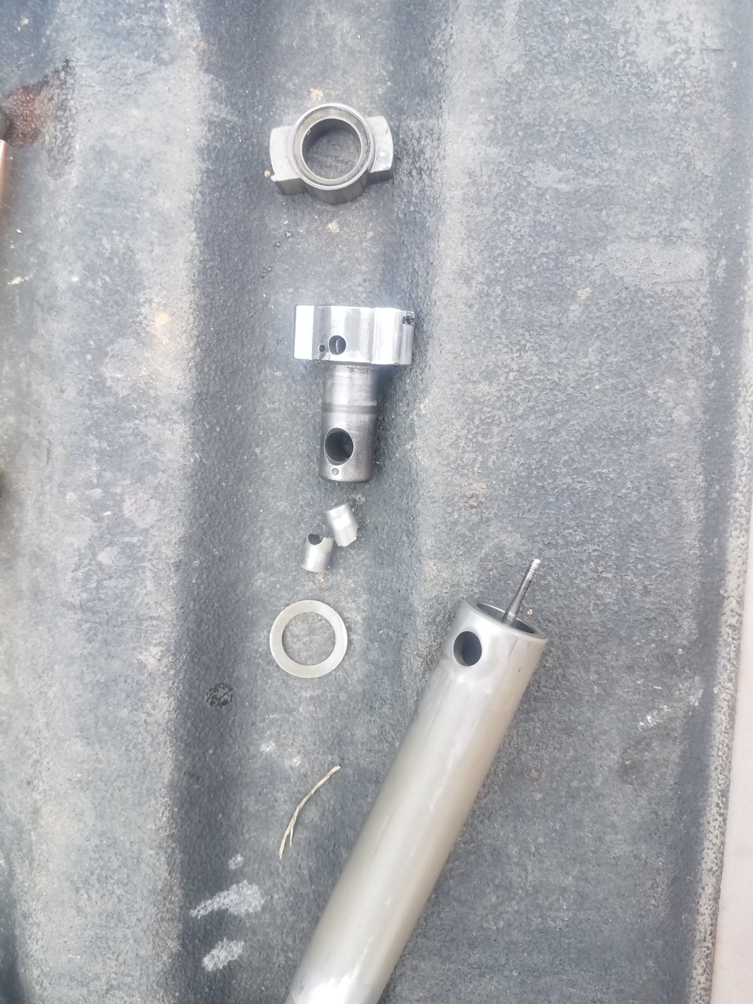

Have three savages and ready to move on to customs. They've all been good if you don't mind tweaking everything.
My first one had the primary extraction issue that despite being sent back twice to savage they didn't diagnose. It took me 4 months and 150 dollars of gunsmithing fees to fix.
Then tweaked the ejection issue with a larger ball bearing
Then fixed the bolt lift issue with a kit.
Then today after 4-5k rounds I had the bolt head retaining pin break on me.
I'm ready for my Archimedes to get here. They were great to start with, but IME novice experience, if you can afford it, I'd try to upgrade.
