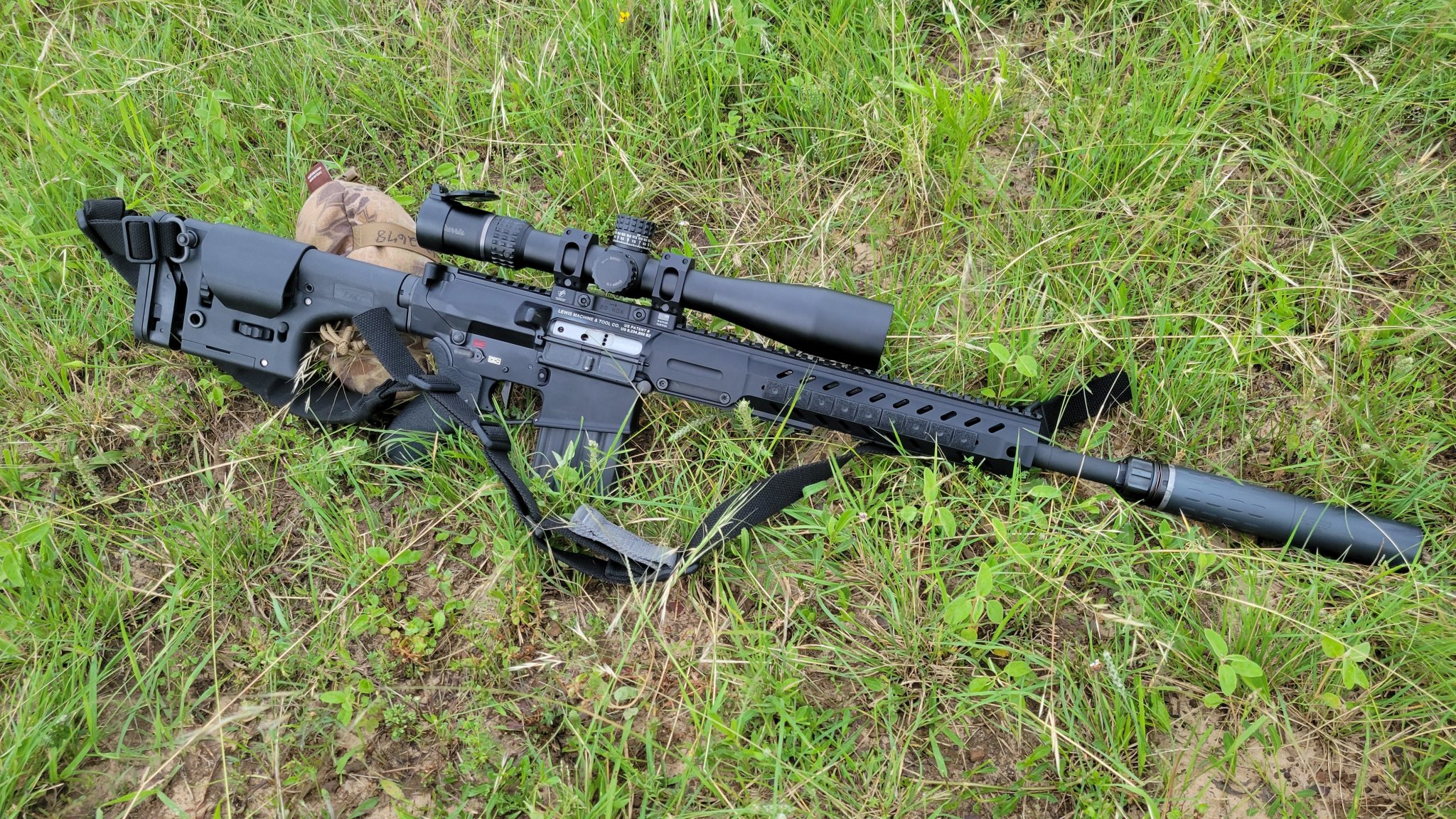

Currently on my 6.5 creed has gun I’m running a SWFA 4-20x50. Also currently running a one piece vortex mount. As it sits right now there is roughly 5/8” between objective and full length top rail. And I have to raise my head up off the stock to get sight picture with my sopmod. I’m looking for rings over a one piece mount. Do not want or need quicktach. Also do not want to spend $300 on a set of rings. So let’s say $150 max. So what do you guys use for 50mm objectives.

Honestly I'd tend to agree with newmexicokid above, you could try a riser or adj. comb setup. Other than that Seekins makes quality rings but idk if theyre really in stock anywhere right now. For ar10s you gain a lot from the one piece mount, but what is the current ring height? I thought the standard vortex 1 piece was pretty low. Here's a 50mm xtr2 5-25x in an ADM 20 moa mount from another rifle and it barely clears the rail. In fact its too close for a scope cap or sun shade.
You could post a pic of your current mount and that might help.

its Really not that hard to find rings and determine what size you want. If you know the height of your current setup and there is 5/8” gap between objective and rail, just figure out how much you want and subtract that from current ring height to get new ring height. My guess is somewhere around 1.3” like this From badger
