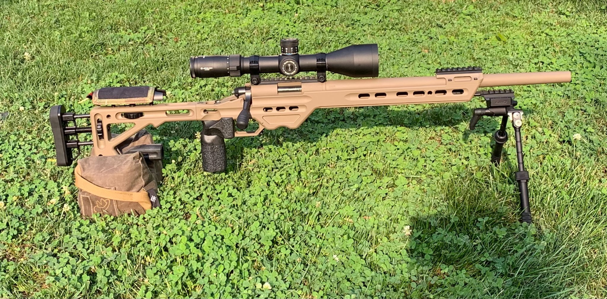

Mine is in an MPA BA Comp chassis, with 20" MTU barrel, all FDE bought it as a complete rifle from VGW, then just put scope and rings on it when I got it home. It's been great. Balances about 1/2" in front of the mag well (on a kitchen chair) with Atlas CAL bipod on the ARCA rail legs folded forward.

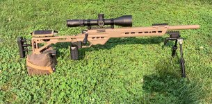

If you're leaning toward the MPA BA chassis, order it as a "complete rifle" from VGW, you can have the whole thing cerakoted what ever color you want...there are 5 or 6 standard colors that don't cost extra. Here's mine in FDE.
Edit add: I don't have the 419 on my Atlas anymore (that pic was the day I brought it home and mounted the scope), changed it out to a Gray Ops with cam lever...moar betta.

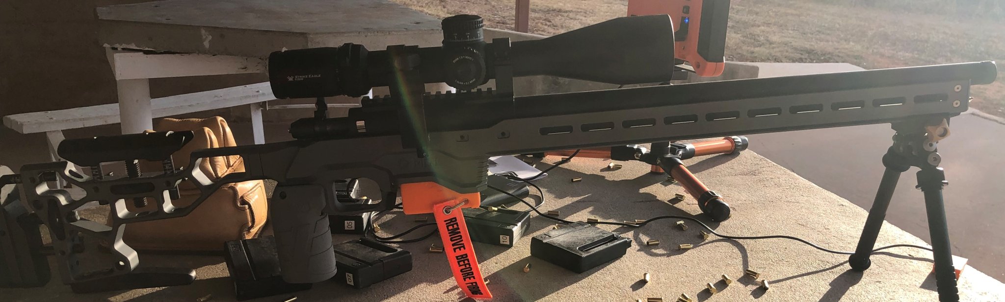

Here's my 20" MTU in an MDT ACC chassis that I really enjoyed shooting. I've just received a tuner that I want to try but I can't use it with the MDT ACC because the barrel is so short. I put it back in the KRG Bravo to try the tuner the next time I'm at the range.
The MDT ACC balances better than the MPA BA. Just swap the buttstock buttplate piece with their aluminum version to cut .75lbs off the rear. Everyone here is running ACC's with 22" barrels.
