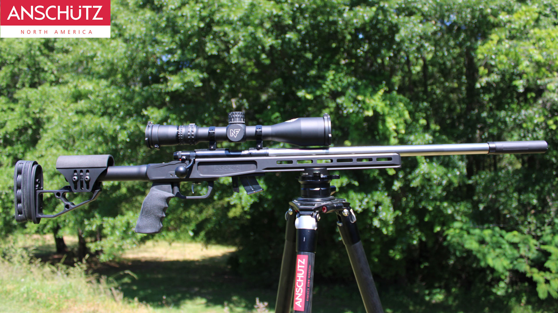

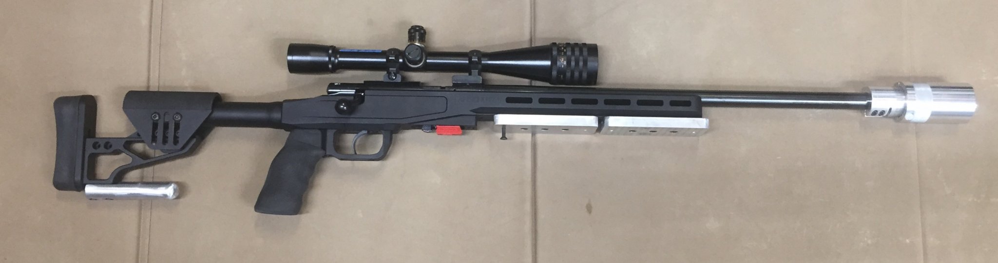

Im thinking about a 22... I want it to be the new whizbang gadget as Ive already got a pile of old 22s from the prior century but I also still want to be able to do some old school things with it.
Im part of the oldest continuous shooting club in the nation and we are a 22lr paper schuetzen verein at 100 yards and either scope/ironsight and rest/off hand but in either case its standing up with the rifles weight on you and "for safety" they dictate that the bullets be fed one at a time. So its basically a bunch of dudes shooting old benchrest sorts of rifles standing up. As such being able to single feed the bullets by hand into the chamber is of major importance to me. But I also want it to be a repeater because I feel I have too many single shot 22s.
I know the rimx doesnt allow single feed, it has to be fed from the mag only to slide under the extractor for crf.
I know the vudoo supposedly can push feed one at a time with out being mag fed but I couldnt for the life of me get my fingers in the little port to feed it when I tried and the one time I did get the bullet in it had extraction issues. Its a one off experience I know, dont flame me.
So that brings me to the anschutz comp xlr with its open top that should allow my to single feed and start the bullet into the chamber by hand much easier.
Anyone have any experience with the 1710 action? Ive got an old 54 solid bottom thats groovy but Ive never fiddled in depth with an anschutz repeater. Looks like the port is open and with the single feed mag insert should be easy to start into the chamber by hand just like my 54?
I also like that it has an aschutz rail in the forend so I can throw a palm shelf on it for off hand in addition to the rrs dovetail.
So anyone have any issues with the rifle they can think of?

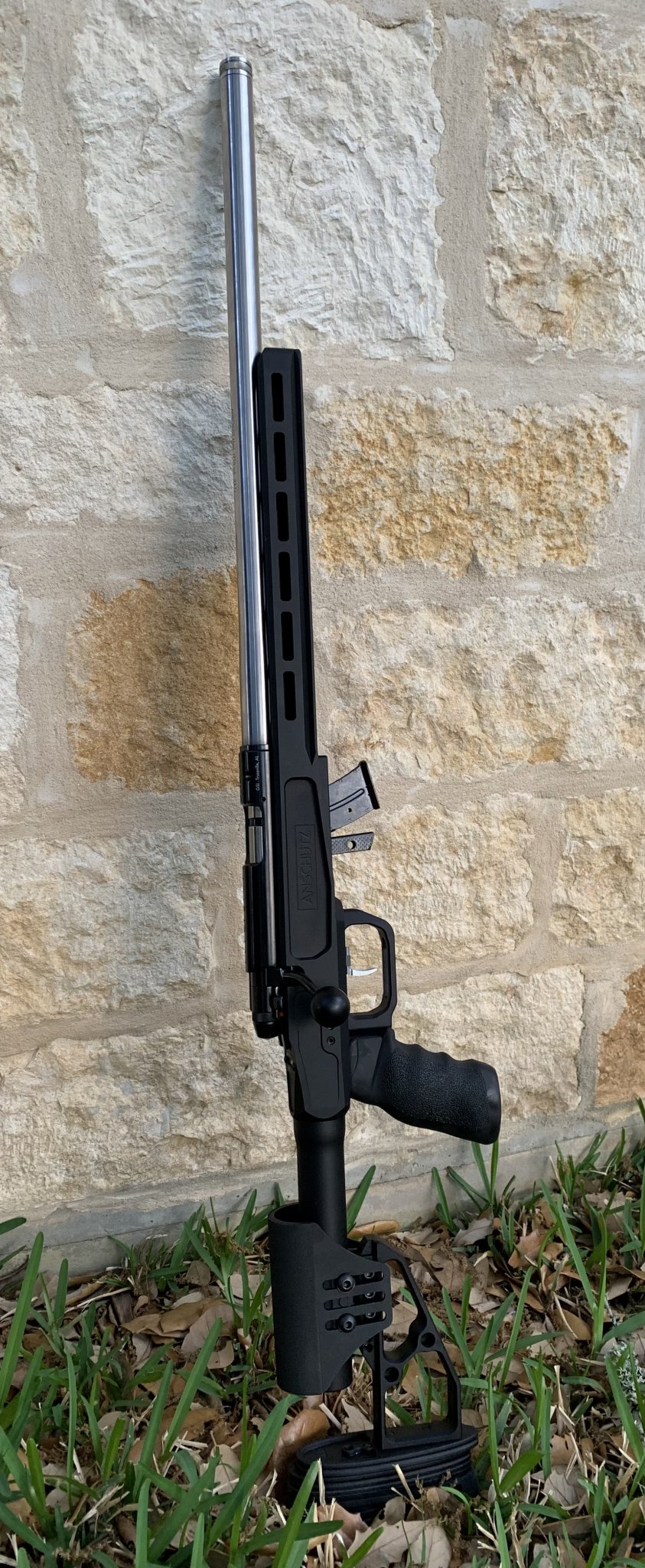

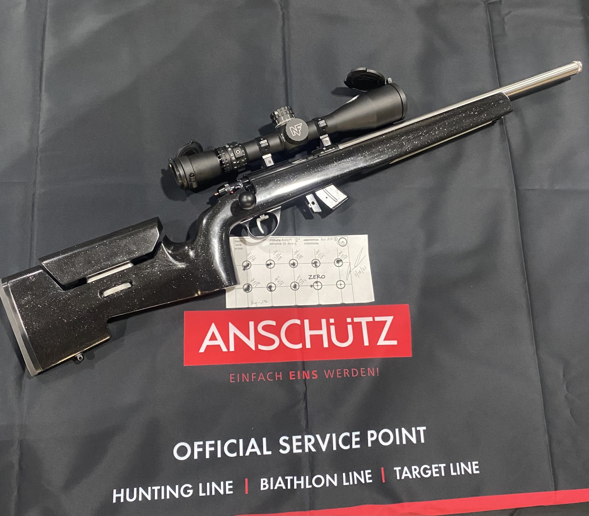

I spec’d that gun to Germany for them to build so I think I may be able to help
What would you like to know? If you go look at the 6x5 thread I shot one brand new out of the box not lot tested and w/out looking the average group size was .175ish.

Im mostly just wanting to confirm that while standing holding the rifle in your hands, you can easily feed a round into the chamber without scuffing it up, right?

Yes you can. It would be far easier with the single shot adapter though.

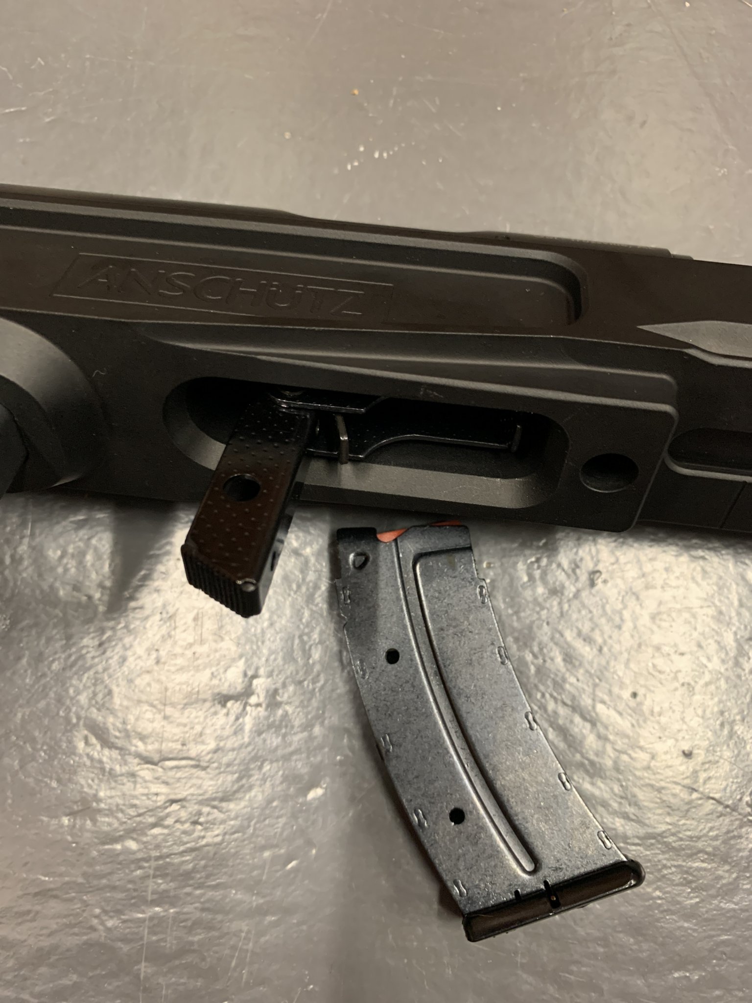

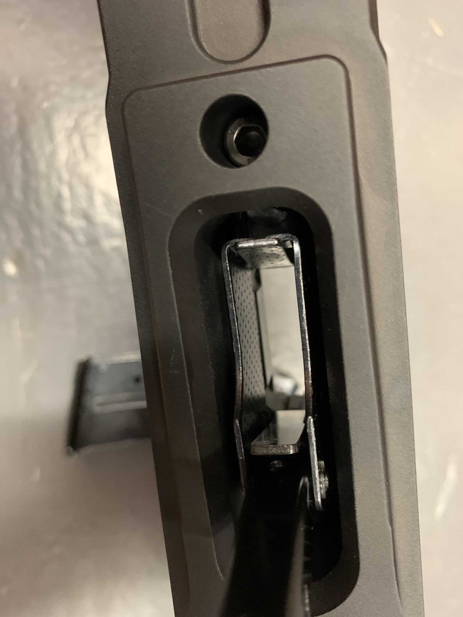

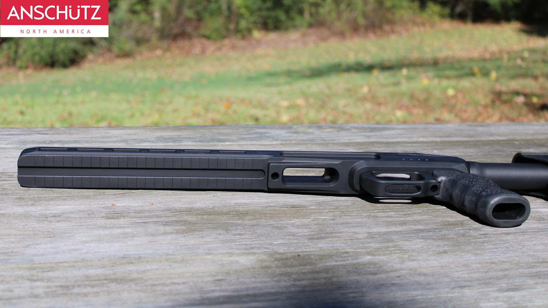

The Anschutz mag release system is ridiculous. Hard to find and even harder to release. They offer a mag release extension which resembles a small piece of angle iron hanging below the stock. Why they refuse to change this I don't understand! I've never heard anyone say they liked the Anschutz mag system. Just the opposite.
As on the rifle in the first post, there's an extended magazine release lever, shown on the 1710 below, that makes magazine changing effortless, But with a single shot adapter, shown at bottom, magazine changes are unnecessary.
This model I want has the long hang down release behind the mag. I’d probably put a 419 arca block on it just to protest the mag when I put it on a game changer.
I've never had a bit or trouble or worry about the magazine release?

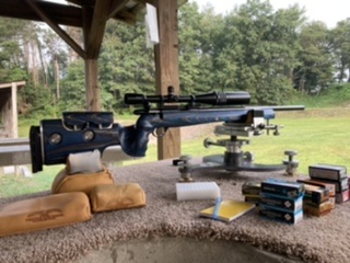

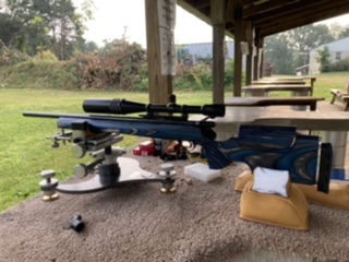

I've owned two Anschutz 2013's, still own a 1827 biathlon, and a 1710 in the excellent GRS stock. The 2013's were good shooters, but never shot with the consistency of my H&R model 12 (Mark Penrod build), and I'm not a huge single shot fan. The 1827 and 1710 are wonderful rifles, with excellent (1827) and really good (1710) triggers. I shoot almost exclusively at 100-250 yards with my .22's. I'm sure the 2013's would have been the winners at 50 yards, but I'm not into single shots as much as I am repeaters. That's why I've kept the 1827, 5 mags and irons makes a nice all around package that supports the 1710 with the extra mags.
Accuracy, I'll try and post some pictures later, but with the 1710 I've been able to hold 10 shots inside of 4" at 250 yards (yes calm winds). Here's a quick 250 yard snapshot; (note, 200-250 yard groups were shot prone with a bipod and rear bag)

The GRS stock is a great stock for the 1710, balances well and is very stable off the ground (or bench) with a bipod. I'm not impressed with the MDT type chassis. I had one on a 1416 HB, and it was skittish and difficult to keep stable. If I were to buy another Anschutz, the 1710 in the GRS is an excellent choice and if you look around, you can find a used one. My only gripe with the 1710 is the mag release, the low profile factory release is hard to manipulate rapidly and the extended release looks horrible and fragile. I'm sure I'll buy it for the 1710 someday, but not just yet.
Final thought, I do own a Vudoo V22, gen 1. It's a fabulous rifle and every bit the equal of the 1710. I enjoy the 1710's bolt throw better than the Vudoo. If given the choice between the V22 with the 60 degree bolt and the 1710, it'd be a hard call. There's just so much aftermarket support for the 700 platform. I would love to see ANA continue to off the GRS stock and also team up with a top tier chassis manufacturer, Accuracy International, MPA, etc. Something with a direct correlation to the PRS crowd. An Anschutz 1710 in an AI AT-X would be amazing.

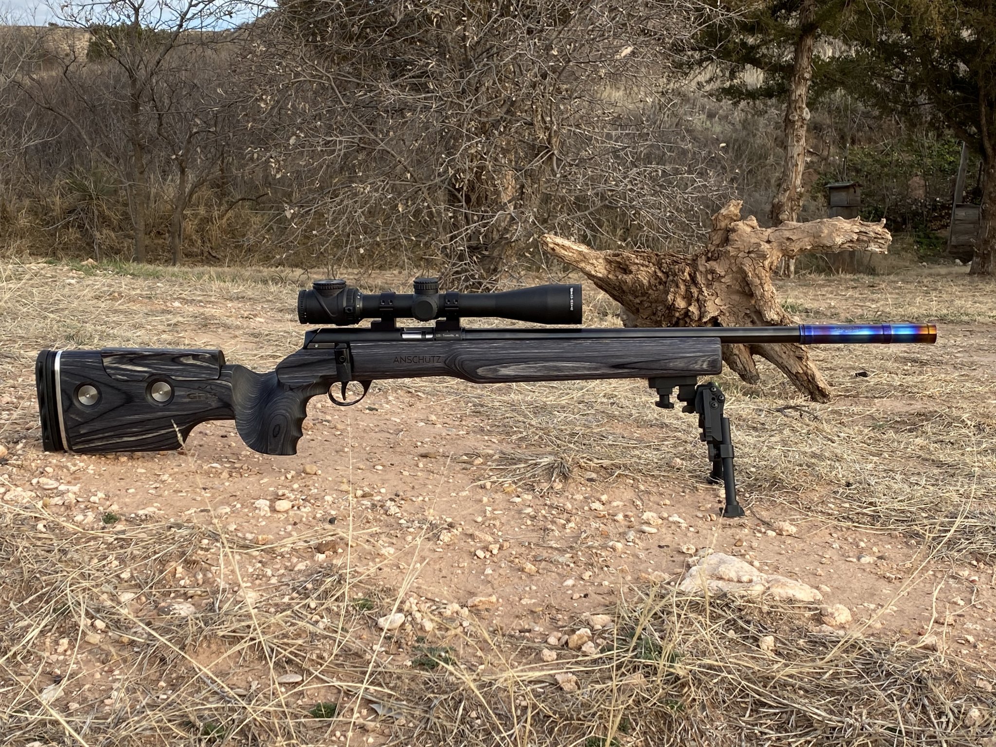

Anschütz 1710 HB in a GRS X EATER stock. I hand feed this gun with no problem using a single feed magazine adapter. I have never used the repeater magazine.
