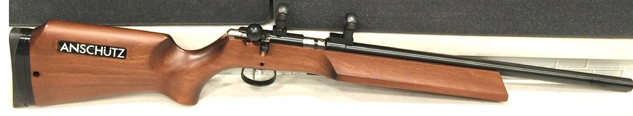

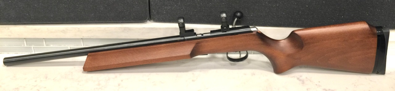

Ok, so full disclosure - newish to shooting In general, been having a blast shooting Tikka T3x in 308 but Cant afford to shoot that often because of price and availability of ammo. So I was looking around To find something 22lr and found a used Anschutz 64s for sale and then saw some videos where they were really shooting accurately. I can get this one used for around $850 But I wonder if better to get a tikka 1x for less if I can find one? Or Wait and spend some more money on a
Vudoo v-22 if I can find one? Again, I’m new so not a great shooter- I need to get my basics down and practice more which I love doing.

That Annie should be pretty nice but I've seen used 64's go for even less than $850 on the used market so I am not saying its a bad deal by any means but its probably not a fantastic deal that you can't pass up. They are nice and have nice triggers specially if it has the two-stage trigger in it but the single stage is nice too. I think you'd be quite happy with the Annie though.

That rifle pictured looks like an anschutz SBR (short barrel, benchrest stock). Anschutz north america usa sold out of those 64 action rifles about 4-5 years ago with a msrp of roughly $1100. It is the lighter 64 action, not the arguably more desirable 54 action that is heavier and retails about 50% higher. Also, anschutz is no longer making the 64 action, replacing that line with the 1761s that are completely different. Anschutz can be a bitch for spares on non current production rifles.
That rifle is designed for 50 yard benchrest competition shot off a one or two piece rest. Can’t remember if it has a magazine or is a single shot feed. Getting another stock is a very expensive proposition and 64 and 54 action inlets are not interchangeable. Anschutz mags are extremely expensive, dated stamped steel design, and suck ass for quick changes during competition. Anschutz makes fantastic squirrel and silhouette rifles. For other competition there is probably a better fit from another brand.

That rifle is a 64 SBR and is magazine fed. It has very nice trigger that can be set at just at a few OZs.
It will likely be very accurate (more accurate than a Tikka) at 50 and 100Y.
$850 is a good price.

The 64 Anschutz shown in the pictures is an Anschutz 64 SBR, a 64 action benchrest model. It will have a BR-type forestock at 3" wide. It will have some cast in the butt stock and so is different in that regard from true BR stocks.
If you are shooting from the bench and have a front rest on which a 3" wide front bag can be used, this is a very good off-the-shelf rifle, improved on only by the much more expensive 54 action Anschutz BR rifles. While even the 54's will be unlikely to be competitive at serious levels, they remain the best option short of buying on the used market a custom made BR rifle known to shoot.
The Anschutz 64 SBR model is less commonly seen than the much more ubiquitous Anschutz 64 MPR. The SBR is designed specifically for use from the bench, while MPR is quite literally a Multi Purpose Repeater (MPR). Except for differences in the stock configuration (and perhaps barrel length), there's no reason for one to be more accurate than the other, except, as always, for luck of the draw in barrels.

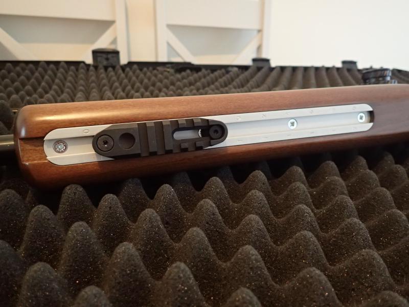

I am writing to ask if anyone can recommend a bipod that fits in the accessory rail of my 64 MPR. I am looking for equipment to set the rifle up for NRL22 competition...any suggestions??
I have a 1761 MPR, basically uses the same stock as the 64 MPR. What I did was use a BT15 Picatinny rail and a couple of their AFAR rail nuts. This rail has a QD attachmnet for my sling and I mount a standard Atlas CAL bipod to it. There's a kit called the AFAR rail kit that comes ready to go if you don't need the sling attachment point - but I think it's handy to have the option of attaching the sling if I was to make a recommendation.
https://www.accu-shot.com/catalog_new/50-1913-picatinny-rails-and-adaptors?id_category=50&n=23
Thank you so much for your reply! This looks like the solution that I need. I too like the having the QD sling connection available. Thanks again!!
