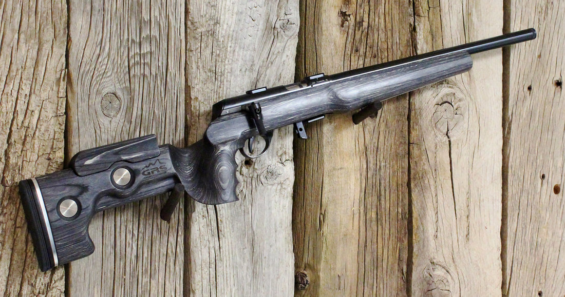

After the Sako Quad, I have commenced work on a new rifle, based on the Anschutz - Fortner 1727F Action and I would like your input. The rifle will be used 90% for PRS22 or NRL-style competition, but there will also be some Rimfire Long-Range (up to 270m), classical prone shooting with bipod and maybe BR once or twice a year. I would like the rifle to be lighter than my Quad was. Rifle will be equipped with handpicked 23" heavy barrel with threaded muzzle, 5020-1 Match trigger, chambered in 22LR. I will be purchasing barreled action only. I have never shot PRS / NRL matches and I would greatly appreciate your input.
  1. As the AI Chassis is unavailable yet for me, and I do not know if it ever will, I have been basically left with two choices, that is GRS Sporter or GRS Hybrid stock. The latter is no longer available (I was told by GRS) but I have the opportunity to grab one, unfortunately only in orange color. My GS however tells me that the Hybrid is a monstrosity for 22LR rifle, that it is too large and the Sporter will be a better choice for me. On the other side, one of PRS shooters from neighbouring country in fact has a 1727F in the Hybrid stock and he seems to be very happy with his choice. What is the local opinion? Will the Sporter be good for my intentions? Can it be fitted with ARCA rail ? Anyways, the stock will get a glass & pillar bedding just like my Quad has. One more thing, if the lenght of pull on the GRS will be short for me even at the maximum setting, can the buttplate be extended somehow?
  2. Scope mount. I am thinking about Murphy Precision 1727 rail + SPUHR single piece. What total MOA cant should i go for? If you have any objections to this, please, let me know.
  3. Bipod. Thinking about going up the ladder from Harris to Atlas this time. I need a bipod that can dig into the ground with spikes, Fortmeier is a no-no.
  4. Scope. I would like something on the lighter side yet durable, FFP, 0.05 MRAD clicks would be great - I have Delta Stryker with 0.05 MRAD adjustment and it is perfect, but sadly SFP only. Not willing to pay $6000 for S&B and similar.
  5. Any other stuff that you reccomend?
Thanks for your replies.

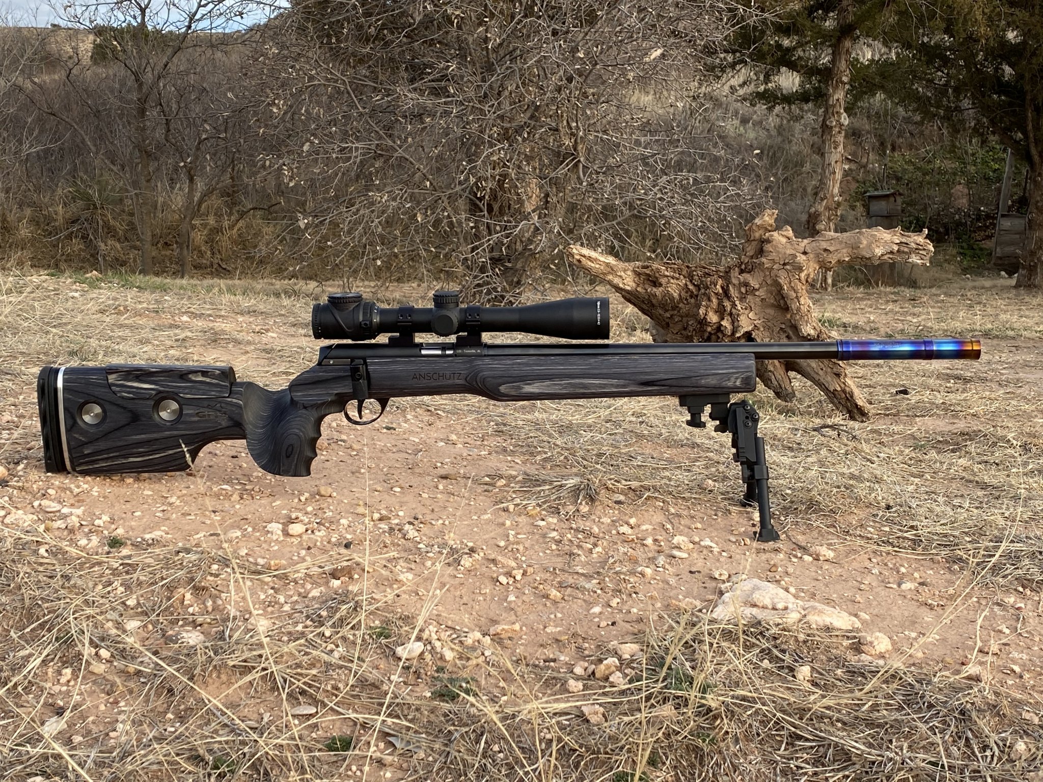

Good looking rig😁. I love my hybrid as it gives me the flat beavertail fore end with t rail for mounting bipod etc. I have since this pic was taken mounted a Vortex Gen 2 Razor 4.5-27 on the Murphy Precision moa+ rail and have been very pleased.
eta- I would also sugest the extended mag release.
