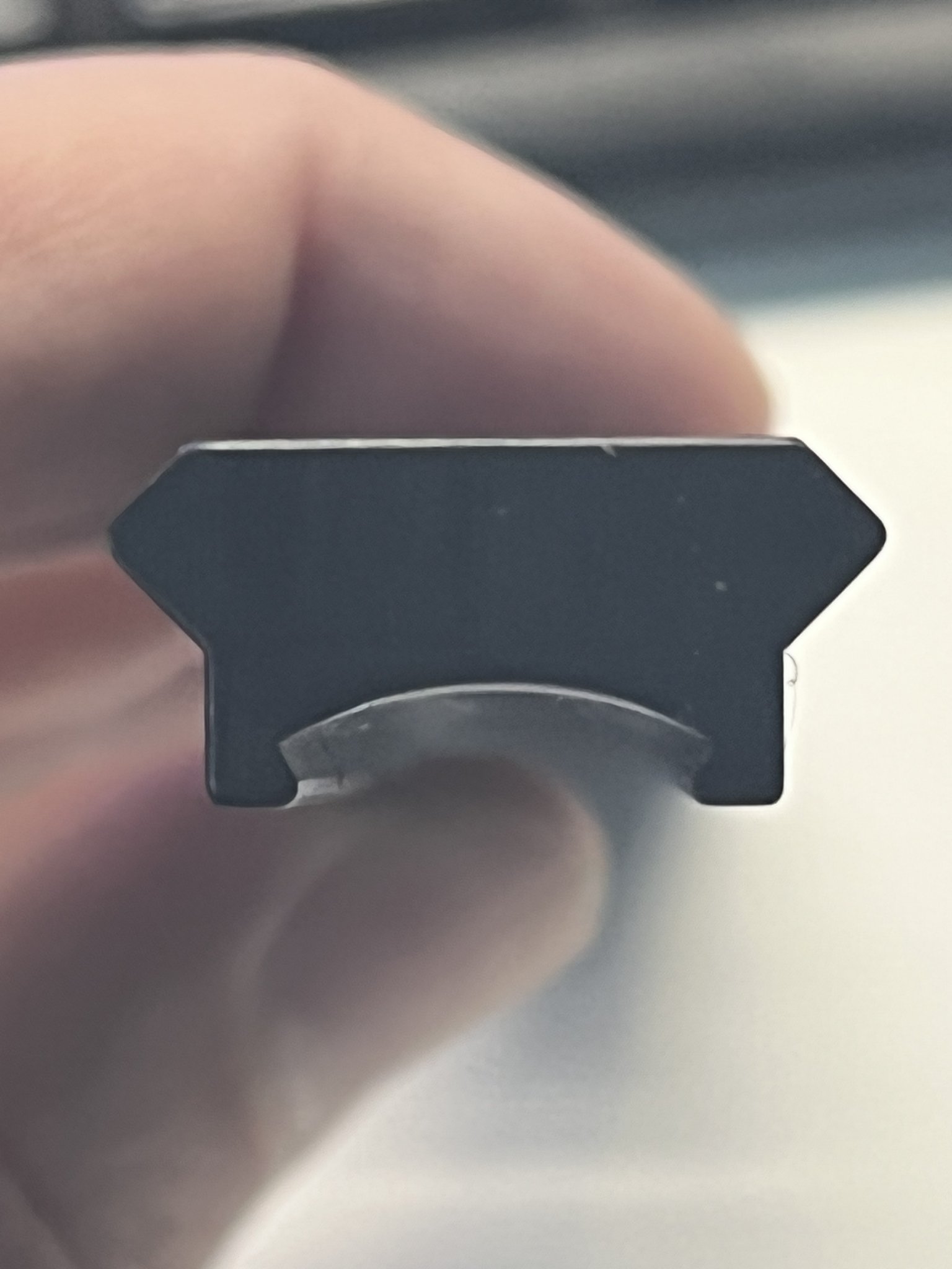

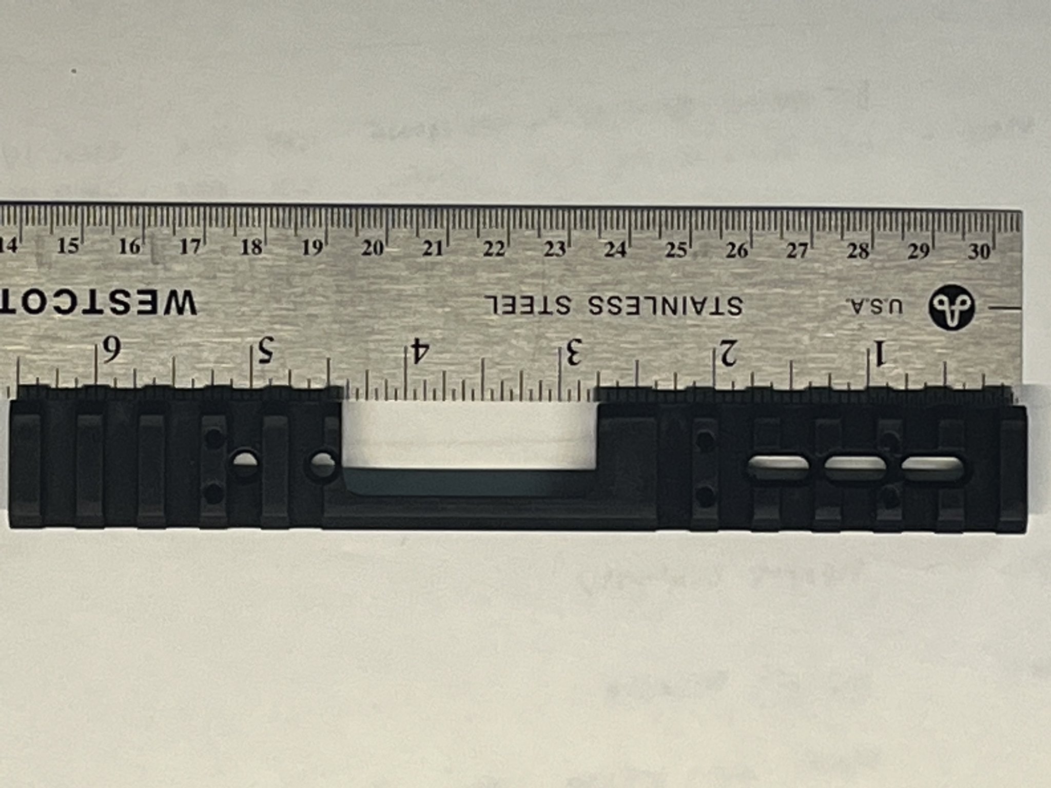

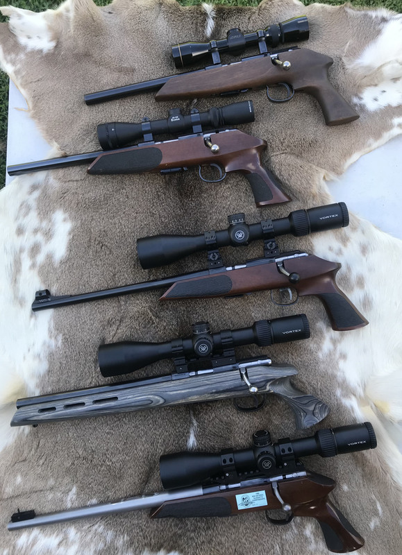

Looking for scope mounting options for a Calfee built Annie pistol. Have a 34mm vortex but not having much luck in getting it mounted. I ordered an Area 419 base for it and tried to make it work but it doesn’t fit this particular gun properly and it won’t eject rounds. Went to a pistol only shoot at Thunder Valley Precision and was told to order the BKL Technologies bases. I ordered 2 versions and they work with the 30mm Diamondbacks but I still haven’t worked on the Calfee gun yet. Three of these have 6-24 diamondbacks. The 17mach2 has a burris pistol and the short barreled 22 has a leupy pistol scope.
Just looking for suggestions.
Top to bottom
.22, calfee converted 17Mach2 (was a 17hmr), last run of 100 built 1416P .22, 17hmr, calfee built .22

The problem I’m running into is the top is ovate. I got an Area 419 base but it doesn’t go forward enough for the chamber cut to line up and won’t allow it to eject. I got two different talley scope rings I thought would work but they both were flat on the bottom and wouldn’t mate to the ovate receiver. The BKL seem to best fit so far. Just need to get some low 34mm rings so they don’t ride so high like the 30mm are now.
