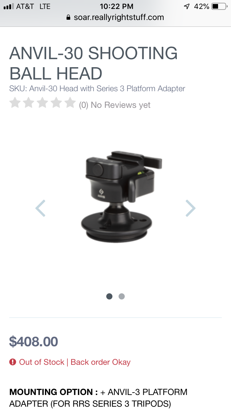

I currently have the TVC 33 Tripod. For those with more experience, any difference in stability going the Apex conversion route vs the Series 3 Platform adapter with the Anvil 30. The Apex conversion costs a bit more and folds up smaller but more concerned if there is any difference stability, Rifle being used is an AI AX 308. Any input is appreciated.
