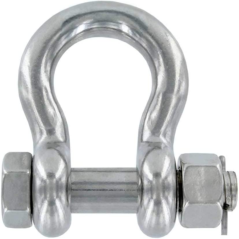

    I use these kinds of shackles myself. I thread it through the chain so the last link is on the rounded part and put the mouth of it over the hole and run the bolt through it. The ones without the retaining pin in the bolt also work very good but they can back out with a lot of use. I put a drop of locktite on the threads and it never came loose again.
