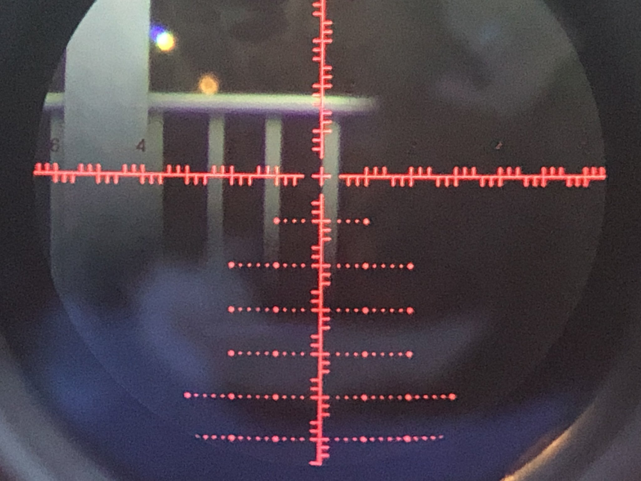

Despite the differences in the knobs and illumination. The key difference to me between these are the reticles. Athlon has 3 basic christmas-tree reticle designs with variations. In mil these are:
The APRL, which the Ares BTR and Talos BTR use, is a classic tree design with a floating cross. There are primary tick marks on elevation and windage evert 2 mil. These are further limited by 4 sub-tensions in one direction and 4 the other to delineate and reduce the granularity to .2 mil. The tree is made of dots at the mils and smaller dots at the .2 mil. Each branch of the tree is labeled.
The APMR, on the Helos, uses the full tick marks for every Mil and half ticks for every .5 mil. There is a traditional crosshair in the center with no floating indicator. The tree is similar with fewer elevation labels.
The APRS, on the TAC and ETR, uses the Full tick for every mil and half tick for every .5 scheme for the elevation and a full tick and small tick for every .2 across windage. The center has a floating dot. (The original Cronus APRS had a floating cross but is now offered with a floating dot as APRS1)
I have used all of these reticles except the Cronus and the APRS reticles are much less busy and easier to focus past than the Ares APRL. Also, reading the elevation can be difficult with the sub-tensions' direction being meaningful. I prefer the floating dot but your mileage may vary.
With the same glass, focal plane, tube size and erector quality, I would make sure that I consider which reticle I want to be staring through. Your preference may well be the APRL (my son prefers that and uses one on his CZ for NRL22). But, I would make sure you get a scope where the reticle fits your preference and not because the turret is more or less clicker.

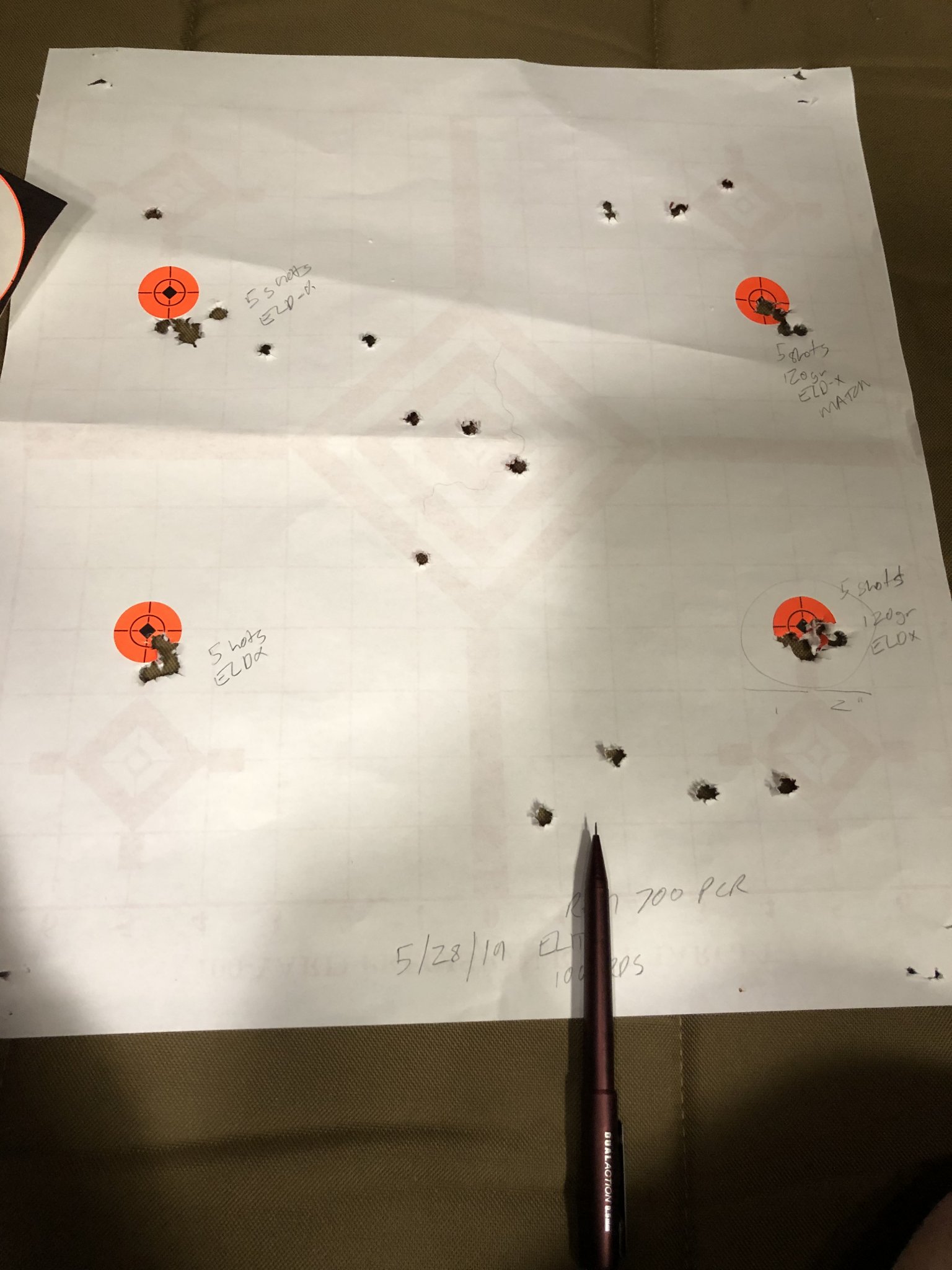

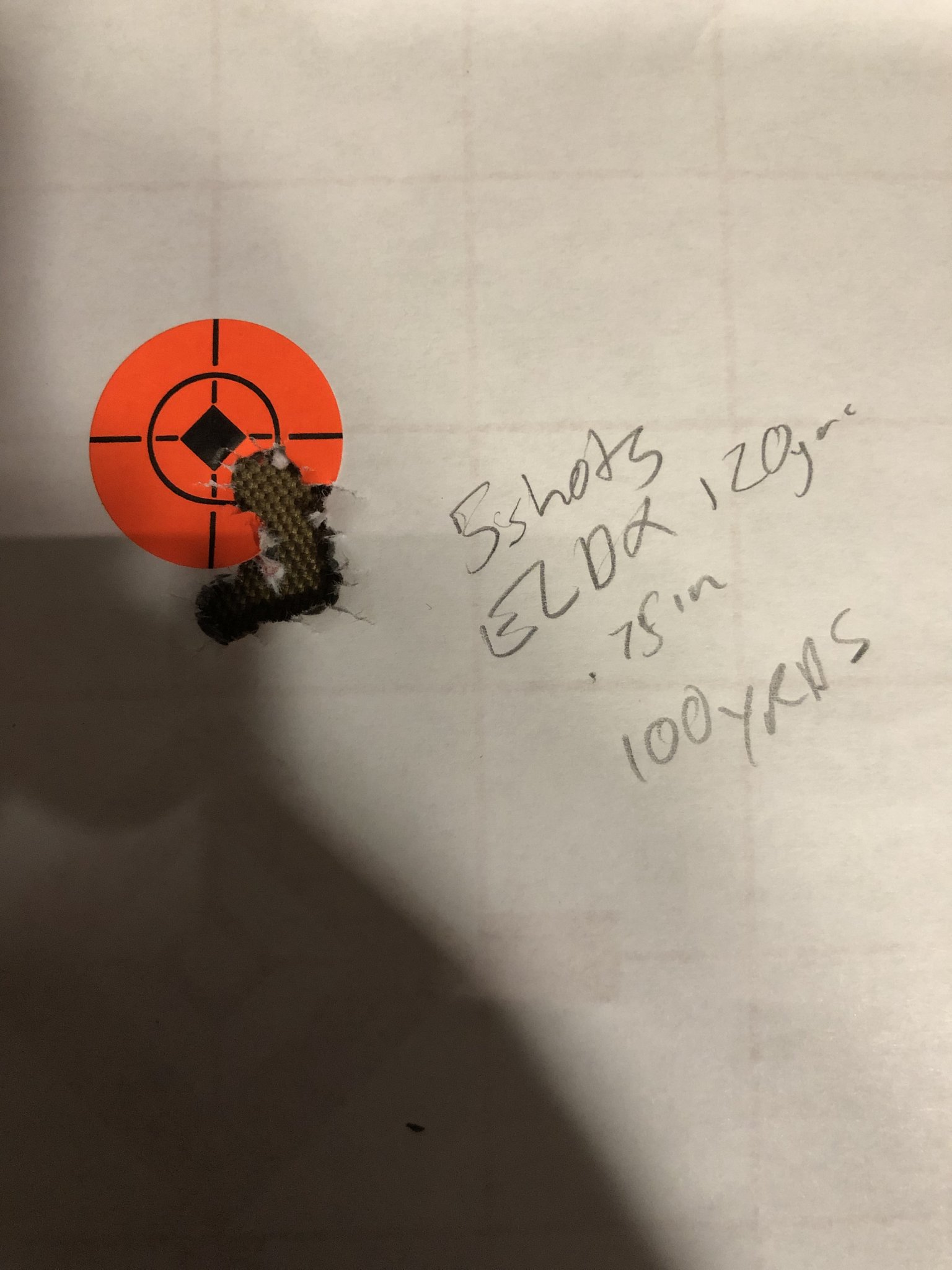

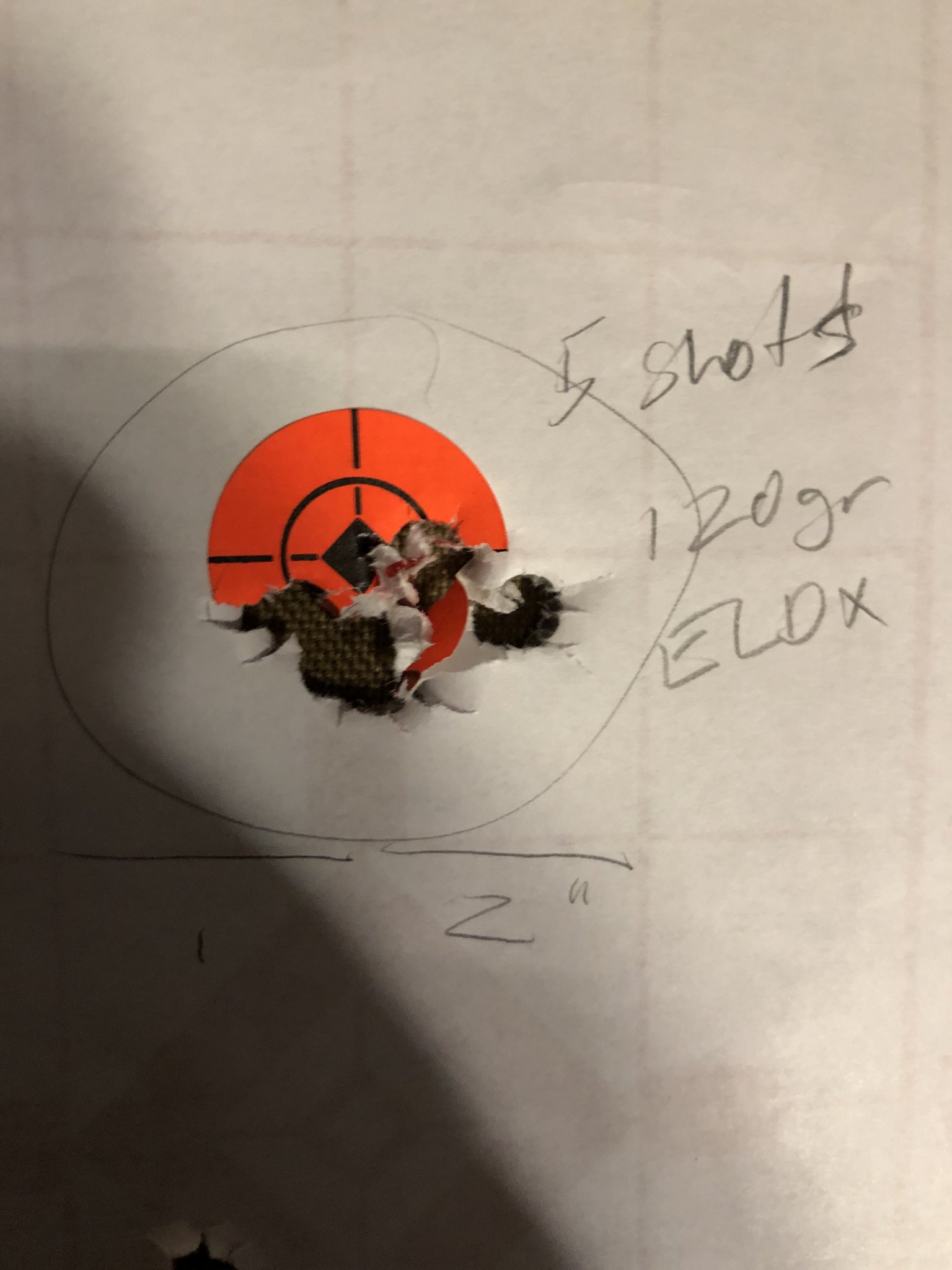

Becoming a bit of an Athlon believer these days, RPrim-Argos BTR,Savage 110 Tac in MDT Oryx -Ares BTR, Rem PCR-Cronus BTR. The Savage and the PCR or new setups, I'll have to upload some range reports in the next 2 weeks. Hopefully the Ares works well.

Oh and National Match build AR, with Argos 1-4. The rise 20" barrel and rifle length gas system are updates since last years 18" midlegth gun. I've tried Nikon and Weaver 1-4x's on this gun havent shot a match with the Argos yet but I have practiced seated and off Hand at 50 and 100, getting good results so far. I need to put it in a rest and see how it shoots static.
