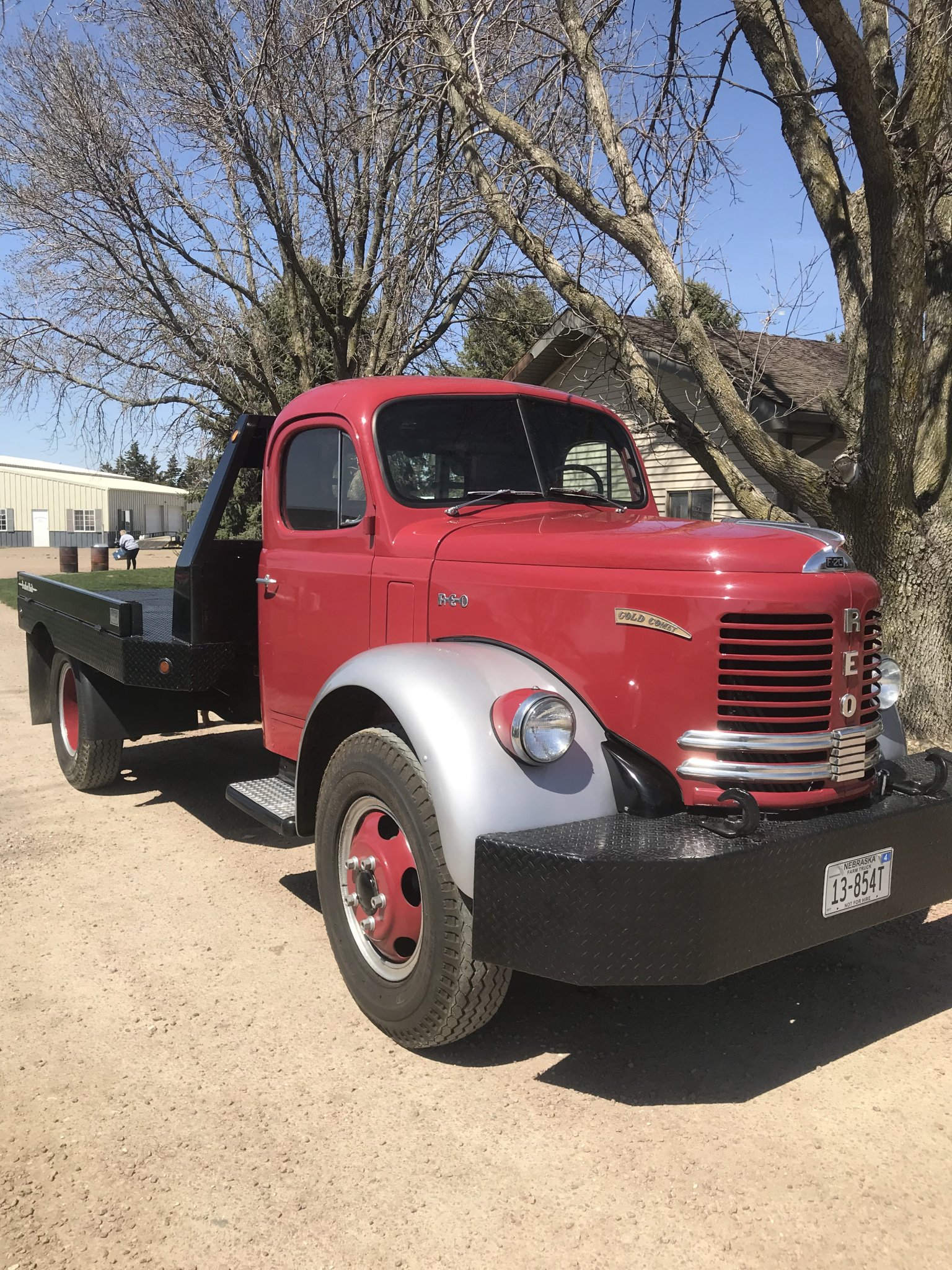

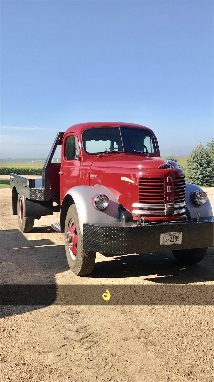

Pictures are of the REO cab/flatbed that will go on the school bus chassis.

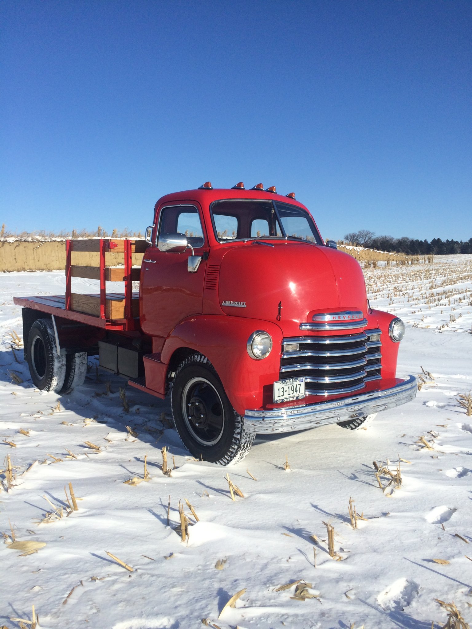

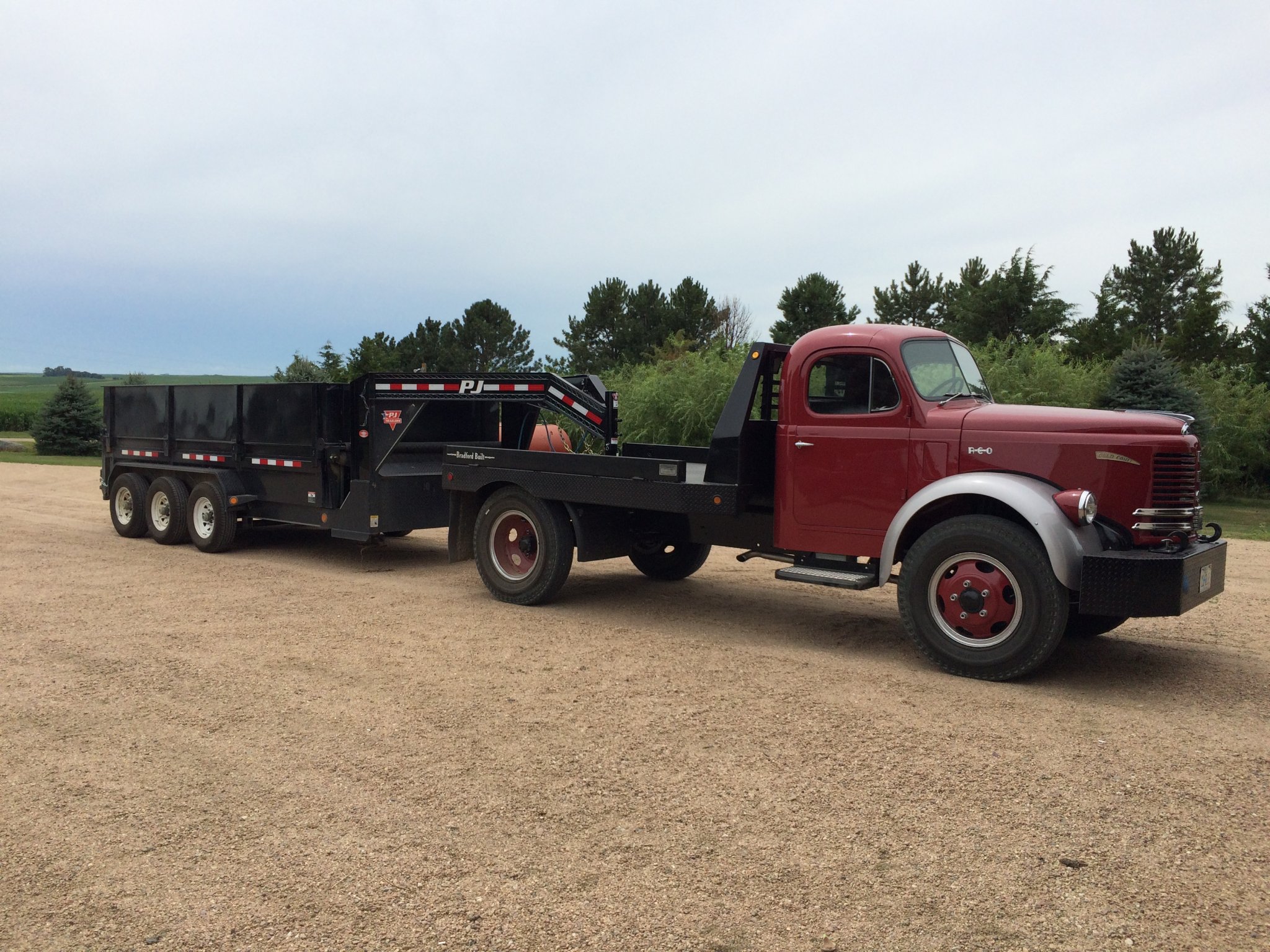

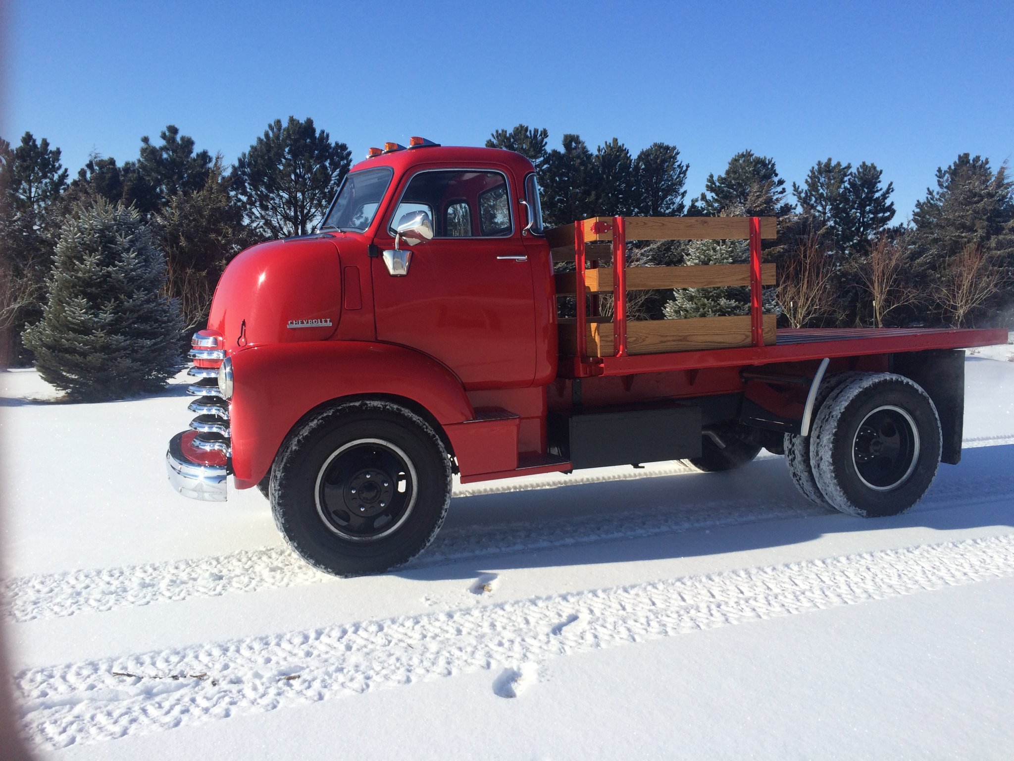

I’ll attach a few pictures of other projects I’ve done. I can’t take credit for the body work, but I’ve rebuilt engines/ driveline etc.
