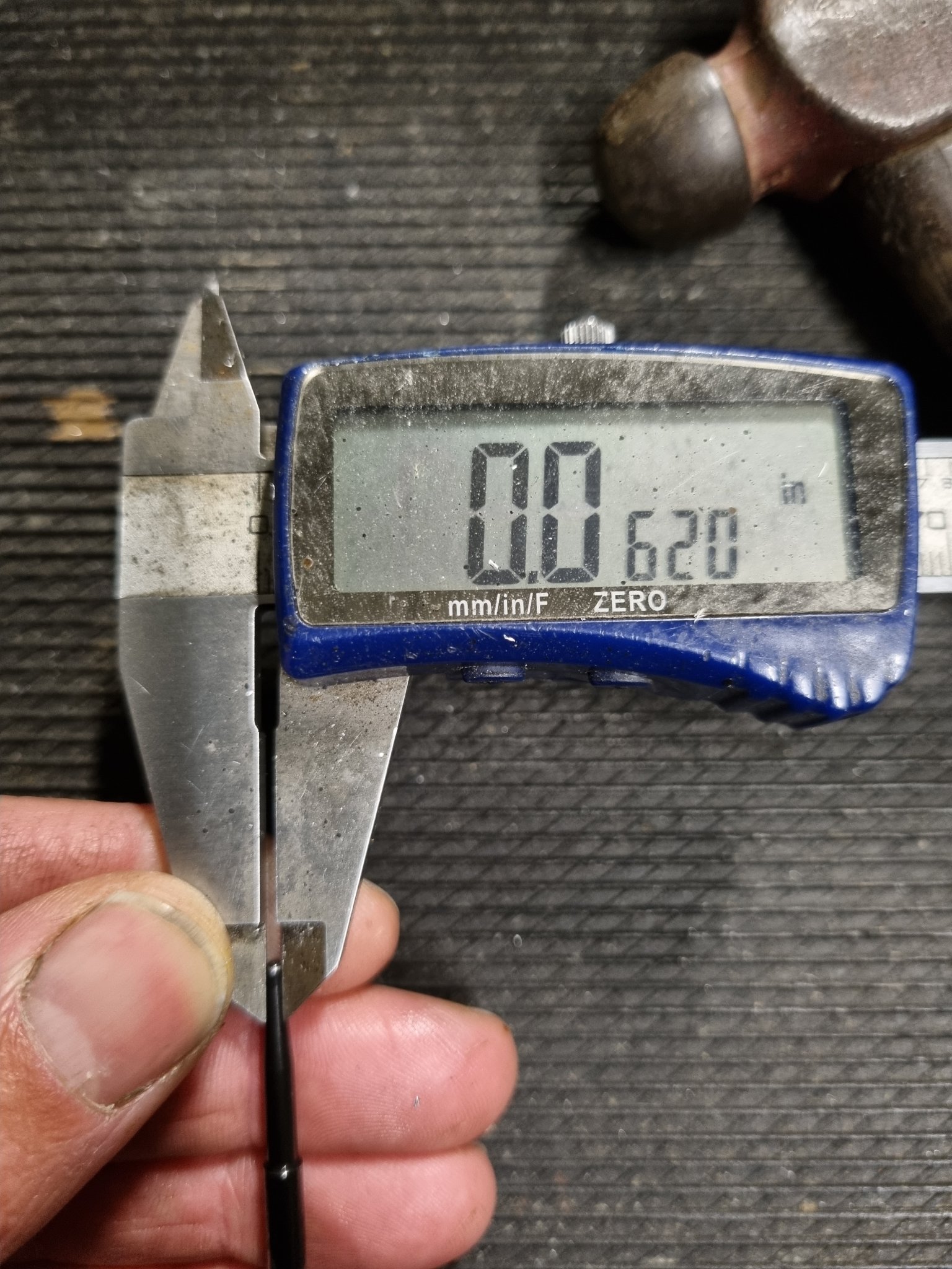

    What's the Firing Pin diameter on the DD5 V3/V4/V5???

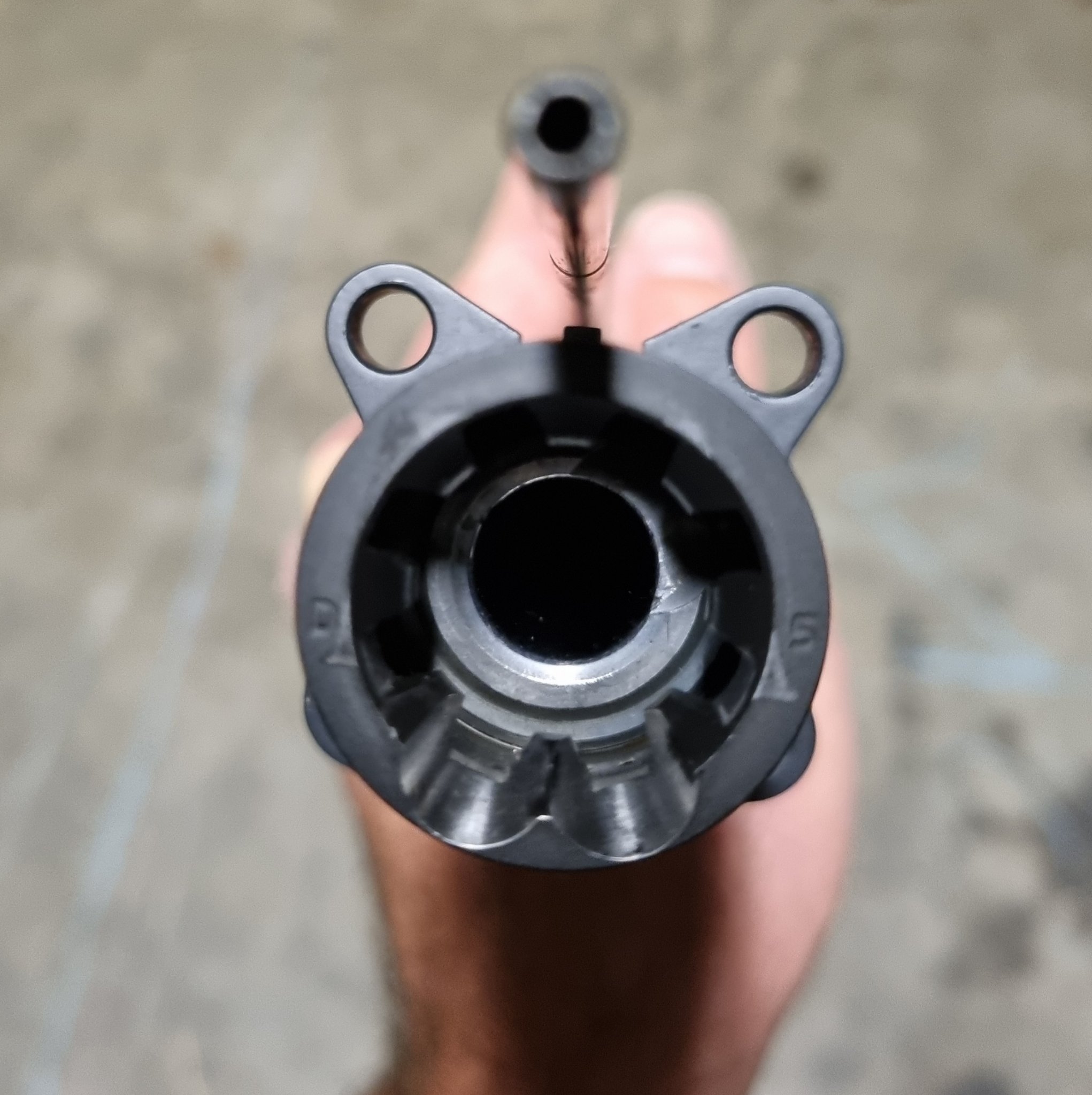

    Could you post a pick of the Feed Ramps/Chamber area?

    Firing Pin diameter

    Feed Ramp

    Thank you sir, That's exactly what I was looking for.

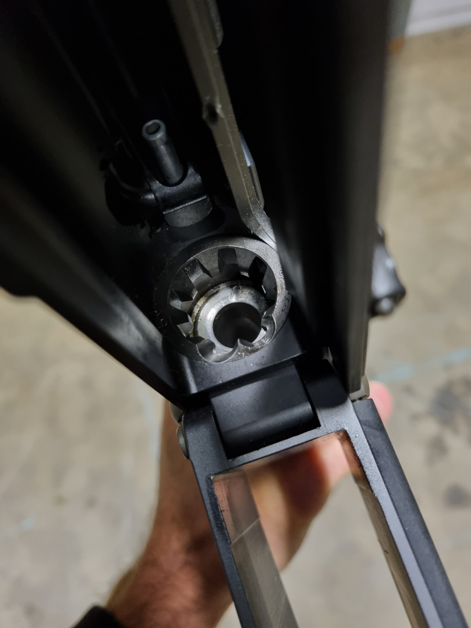

    Could you post a pic of the inside of the upper receiver where the barrel extension slides into.
    Sorry, I don't have a pic of the front of the upper. I took that pic of it broken down a couple of months ago when I fitted that 20" 6.5CM barrel.

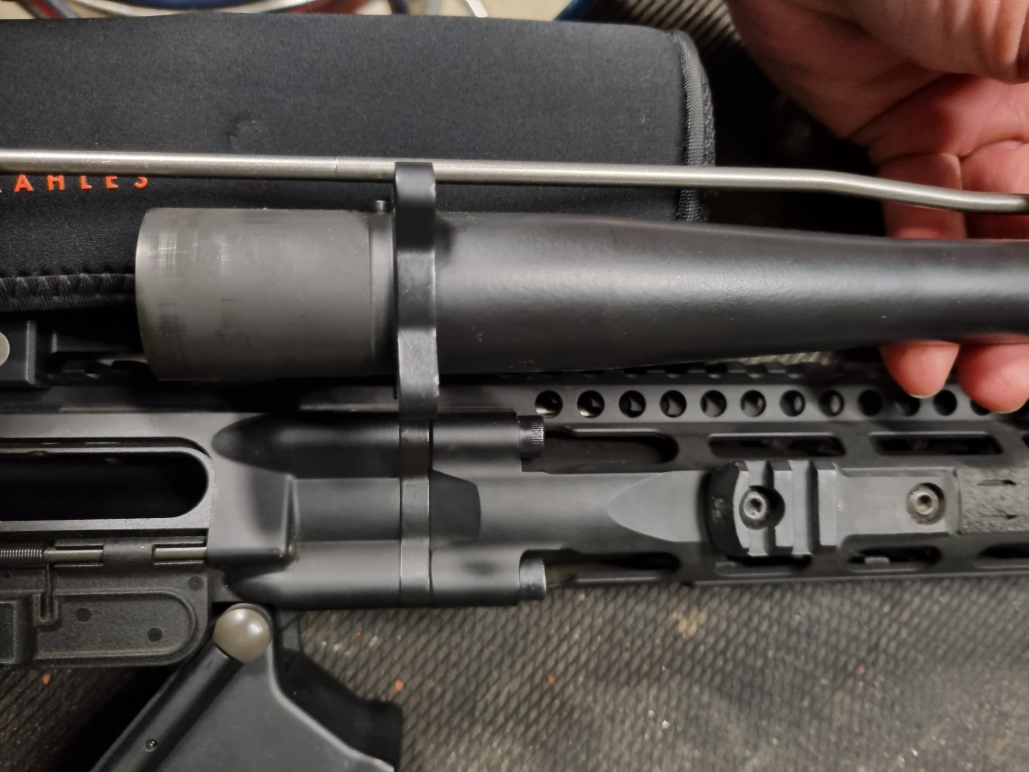

    Did you go with a rifle gas on the 20” 6.5cm? It looks like it. You probably won’t be happy with that if you did.
    Yes, rifle length gas. I couldn't get a longer length gas tube here in Aus.
    Roughly 100ish rounds of Hornady 140AG through it so far, no cycling issues and shooting MOA.
    What blank did you use for the 6.5CM and how the hell did you get one in Australia?
    I used a Lothar Walther parallel blank, profiled the same as the DD.
    Brought it in on an Import permit, I have plenty of gass guns.

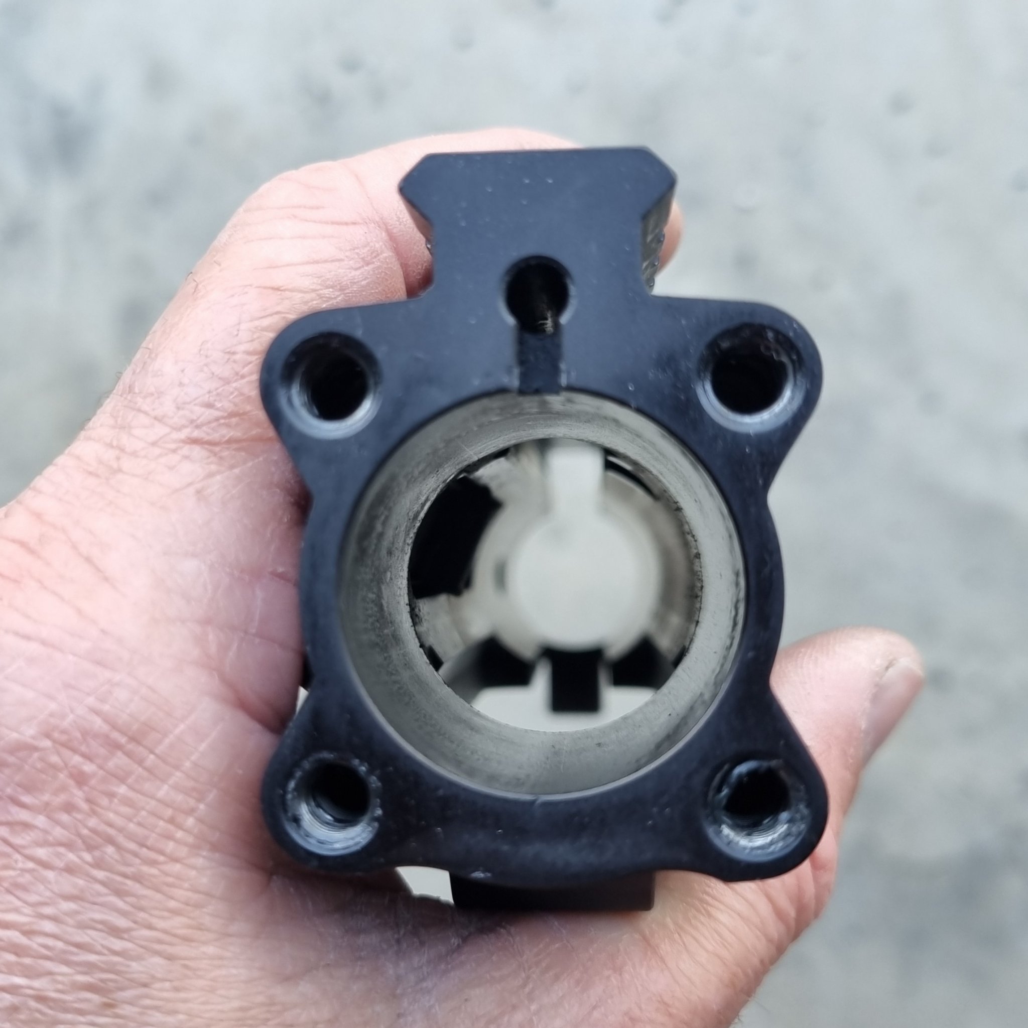

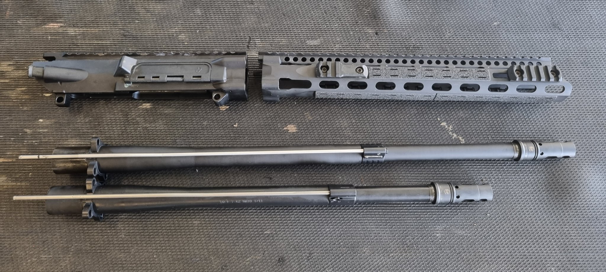

    Since the barrel is out, here's the front of the upper.
    Whist it's not a heat/press fit, there is no barrel wiggle with the barrel sitting in the upper freely.
    Thanks for the pics, I can't tell from the pics are those steel inserts threads in the upper or just directly tapped and threaded into the aluminum upper??
    What are your torquing those bolt down to?

    They look to be Helicoils, no idea on the correct torque spec.

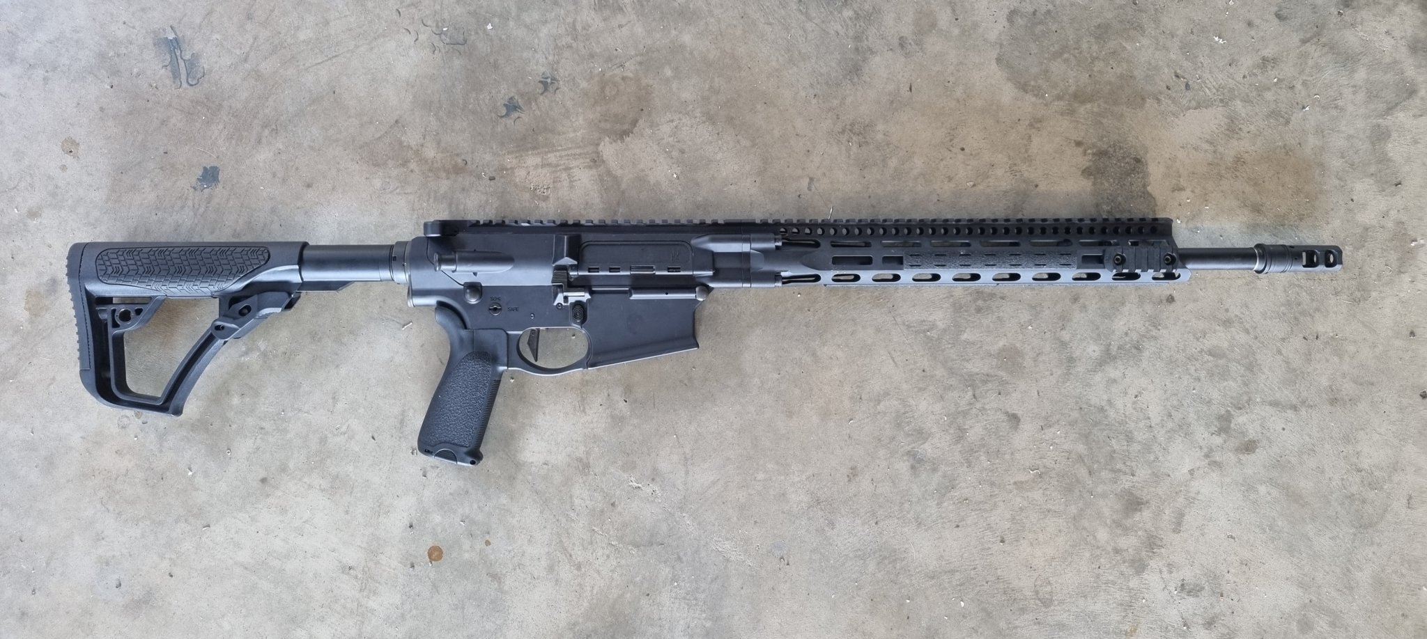

    She's now an 18"

    DD Tech said the 4 Screws are Torqued to 100 in./lb.
