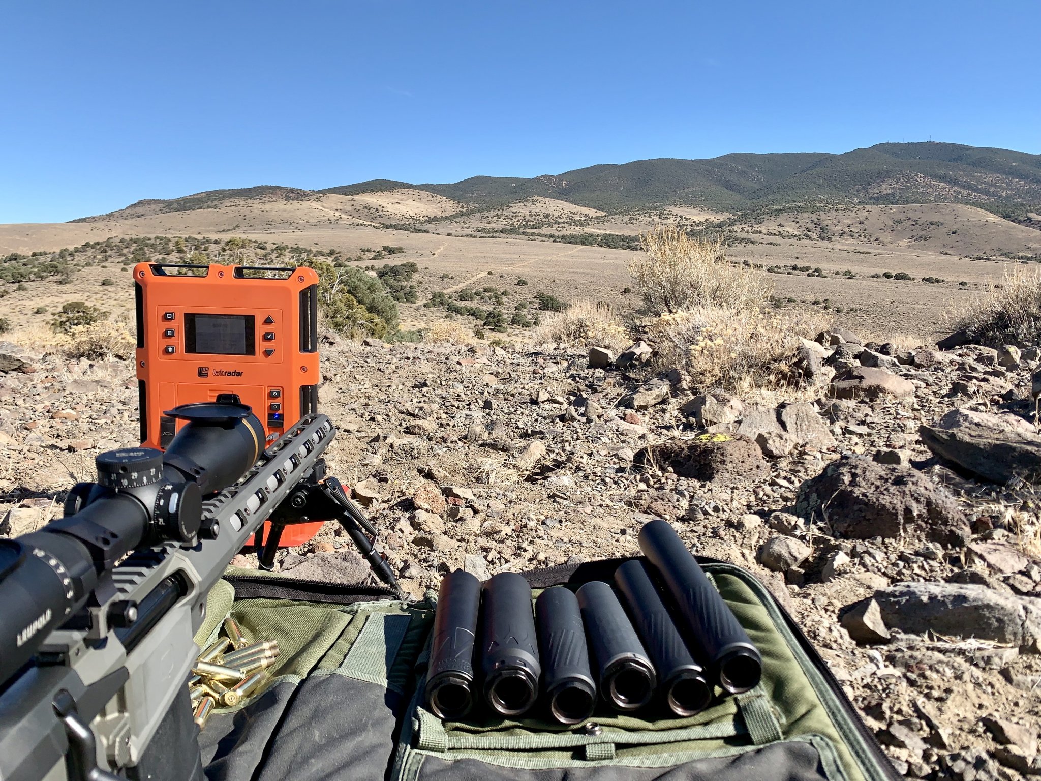

No catch, your intuition about them is spot on. I’m out the desert right now setting up to play musical suppressors on a couple of different rifles using the 419 system, just for giggles. The system is impressive on the rifles I’ve tested them on so far.

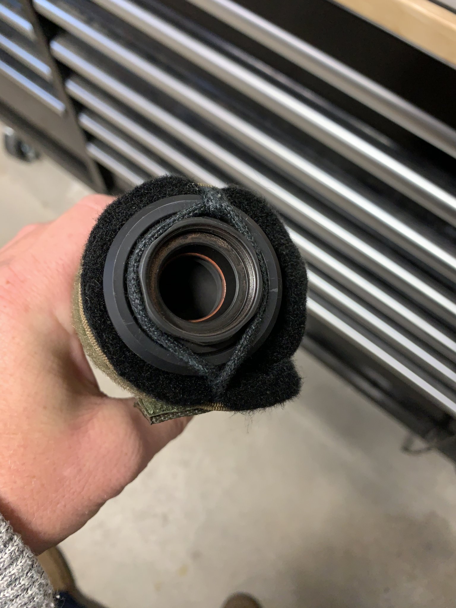

I haven’t seen that either. The 419 uses a high temp oring to keep the gasses from the taper, and the taper fit is perfect. Couple other things not mentioned. The can side adapter has a hex sticking out the back, so the supplied wrench is always an option. Also, if you use a suppressor cover with a retention cord, the hex gives you a place to tie it to. Without that you have to re-apply and tighten the cord every time you screw the can on.
