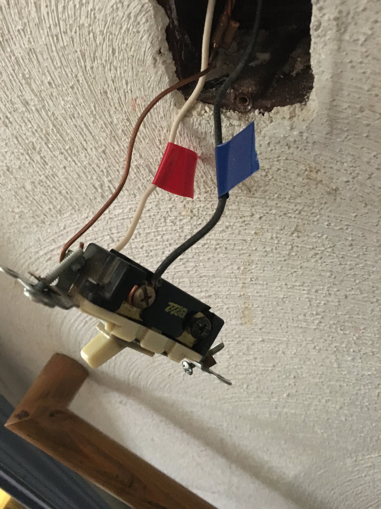

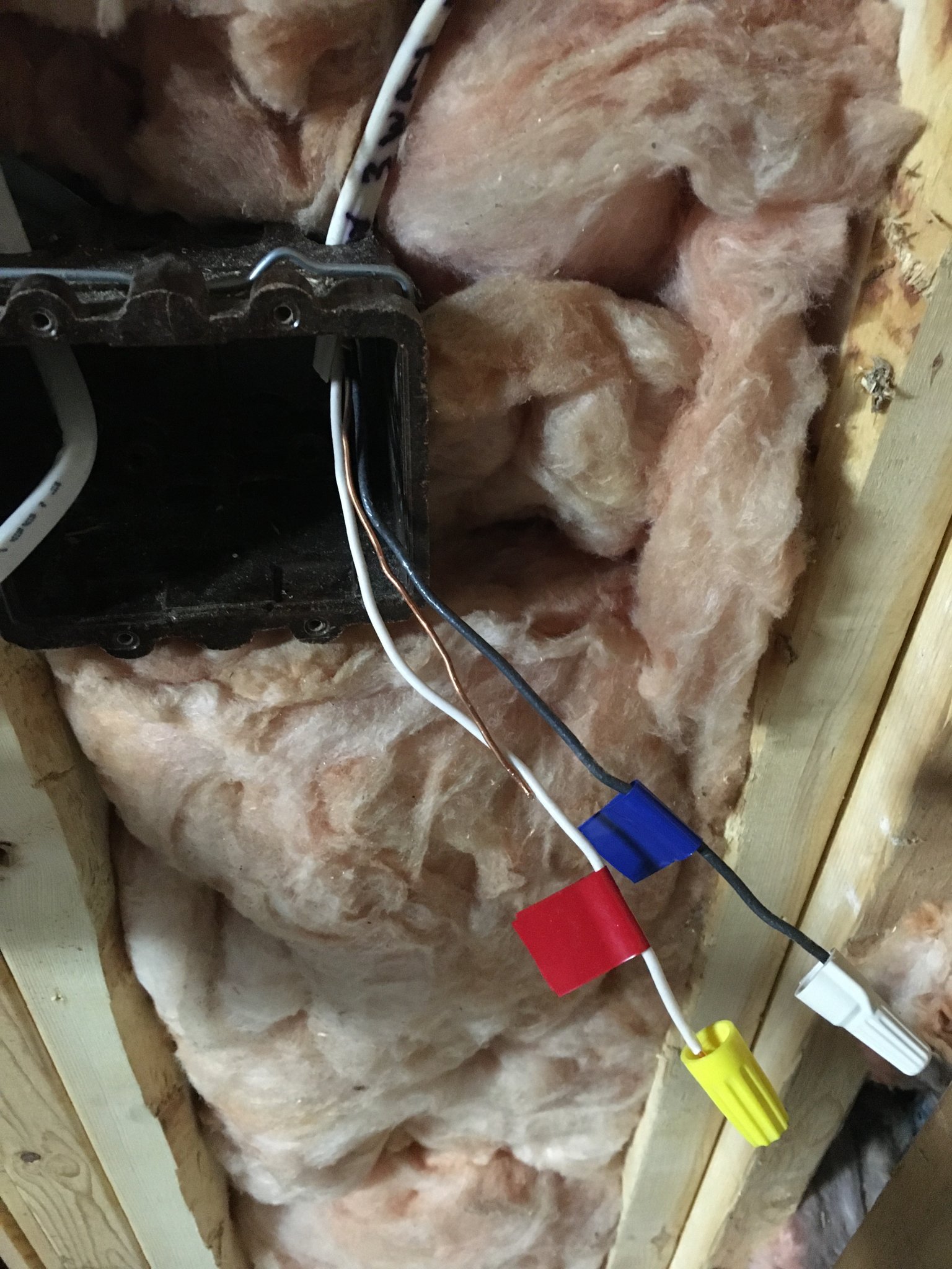

As you can see in the pictures the way it was/is setup is using a 14/2 NM wire for the "traveler" between the 2 switches. Everything I have read/looked at involving 3-way switches has it requiring the traveler be a 3 conductor (i.e. 14/3) so that the neutrals are taken care of. The way it was setup when I found it was the switch at top of stairs had a pigtail connecting to the common terminal on the bottom.
My current view on the situation is that for my new basement light circuit I'm going to have to run a new span of 14/3 between those 2 switches and cannot re-use the existing 14/2 that they were previously hooked up with. Is that correct or am I missing something?
Switch at top of stairs
Switch at basement exit

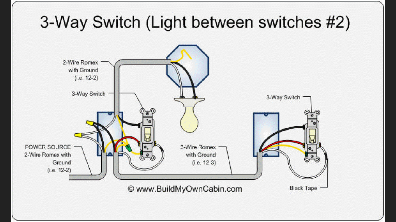

Actually you can have only two insulated wires between switches. If you power it at the top of the stairs and connect to the lights at the bottom of the stairs.
Switch at top
Black screw power
Two travelers.
Switch at bottom
Black screw to light fixtures
Two travelers .
More than likely you don't have a neutral at the switch box because there is a power feeding into the light box.

Here’s the easiest way to show you.
That's a dead end 3-way. Not legal unless you run 12/4 so you can carry a neutral to the dead end switch.
They also move all the wire fill to one box. Stupid idea when most people buy boxes that are too small in the first place.
Switch at top
Black screw power
Two travelers.
Switch at bottom
Two travelers .
What would i do with the neutral on the incoming power if using the 2 conductors as travelers? There would be now way for the neutral on the hot line to connect the entire circuit right?
Looks like what you have going on is the nuetral isn't in the three way and is likely grounded to the box(BX cable) or feeding back through another circuit, or someone has installed a 4 way at one time.
do both switches function as a 3 way should, or is one dependant on the position of the other, IE it won't work unless the other is in position x.....
The power is coming from a lighting box and you already have the neutral there.
From those pictures, they weren't working correctly unless there is something else you're not showing us.
I did a new run of 14/3 between the two switch boxes and got everything tied in, works great now
The old 14/2 being used as travelers i capped off with wirenuts and labeled it, keeping it in back of box. It's de-energized.
