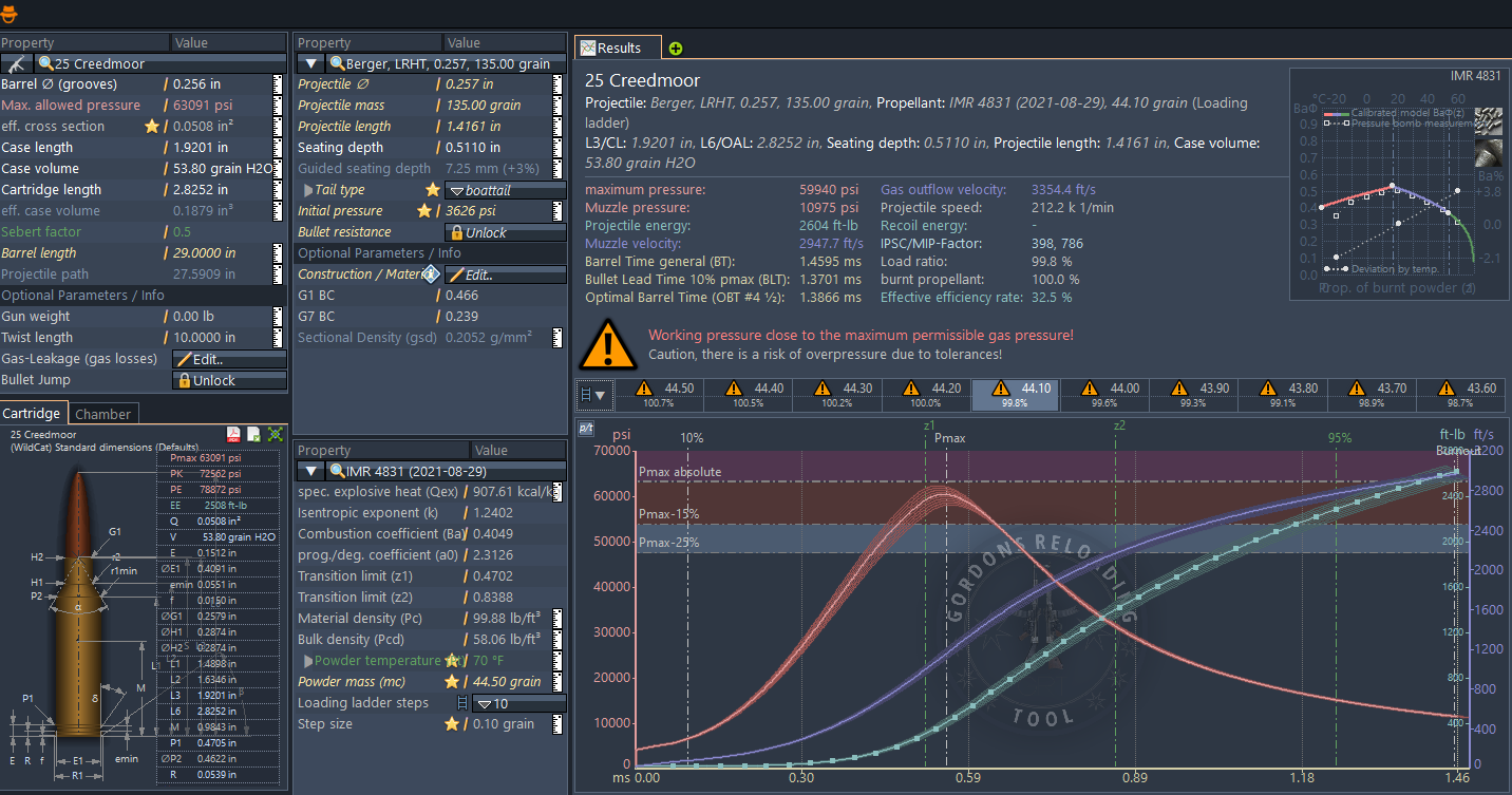

Have a barrel coming in soon in 25 creed. Picked up a pile of IMR 4831 pretty cheap as well as a few thousand 131 Ace's. Seeing as there is about jack all for data out there, wondering if anyone on here has tried this combo with any of the 130 class projo's. GRT is showing some pretty promising numbers but no 130gn data for 6.5 on the subject so kinda flying in the dark. Thinking on starting in the 40-4
1gn range and finding pressure, sound like a decent idea?
I don't have any data for a 25 Creed, but I will think it's a safe bet to say 6.5 Creed or 6 creed would be near identical. In both of those cases, IMR 4831 would have a low velocity because you would run out of case capacity before you can get to an optimum velocity
Gonna be a 29” barrel and shooting for 2850 on a light charge. Seems do-able on paper but figured I’d look for some more input on the situation
