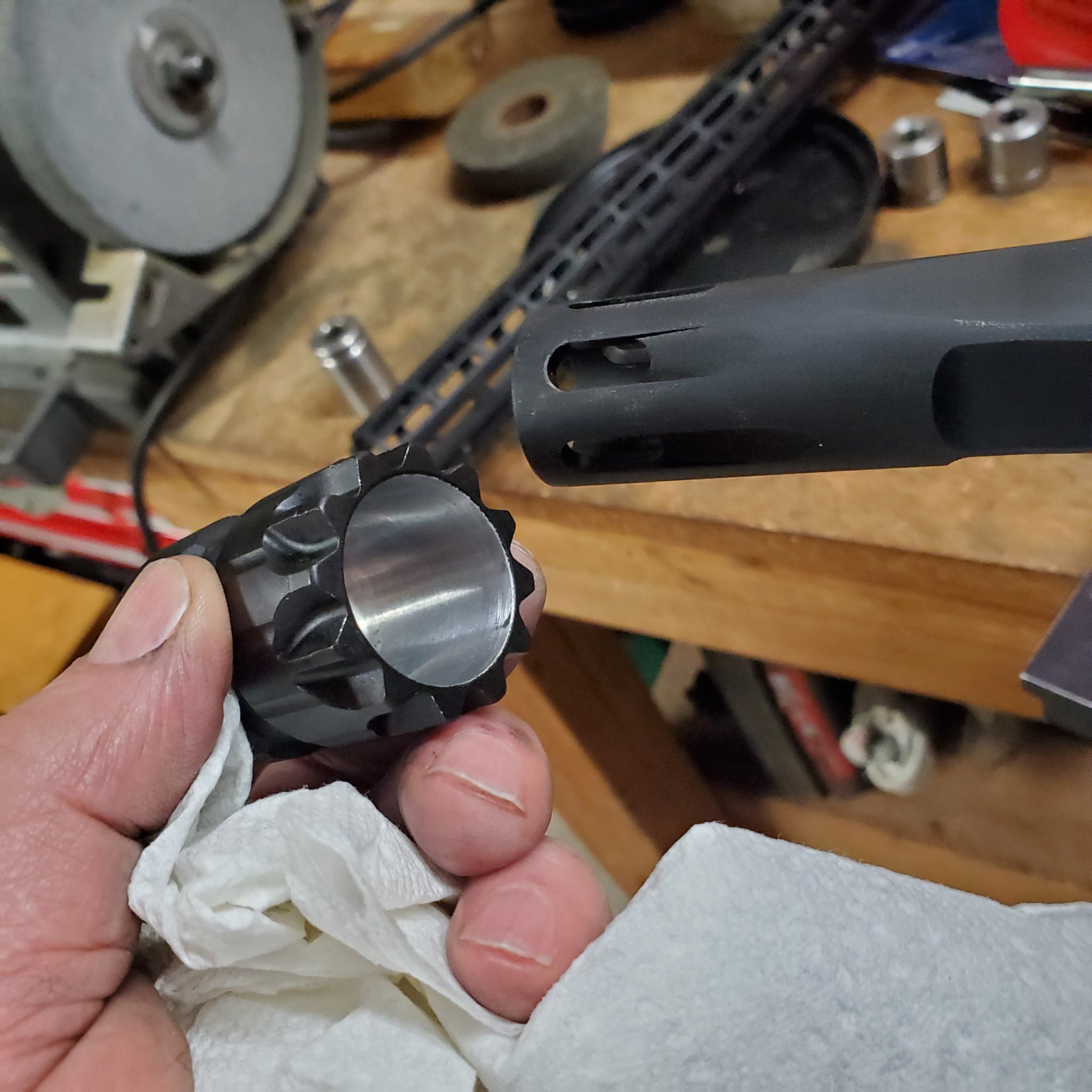

    I had an Odin barrel once... and only one...it was 9mm and would not chamber cartridges fully.
    The chamber reamer used was worn that much!
    The barrel OD was so large the barrel nut would not slide over the barrel, to assemble the rifle.
    Fixed it myself. Bored out the barrel nut. And ordered a finish 9mm reamer from Brownells, and rechambered the barrel.
    So no, I will definitely not recommend them, for anything.
    How could quality control let that garbage out the door?
    The average guy can not fix it.
    They will never get a chance to correct such a horrendous mistake, because it's obvious they do not, inspect and check their work...the so called machine operator, (he is no machinist) or the inspector...
    I would have been fired for that kind of machining, and inspection work. Everything must be in print.

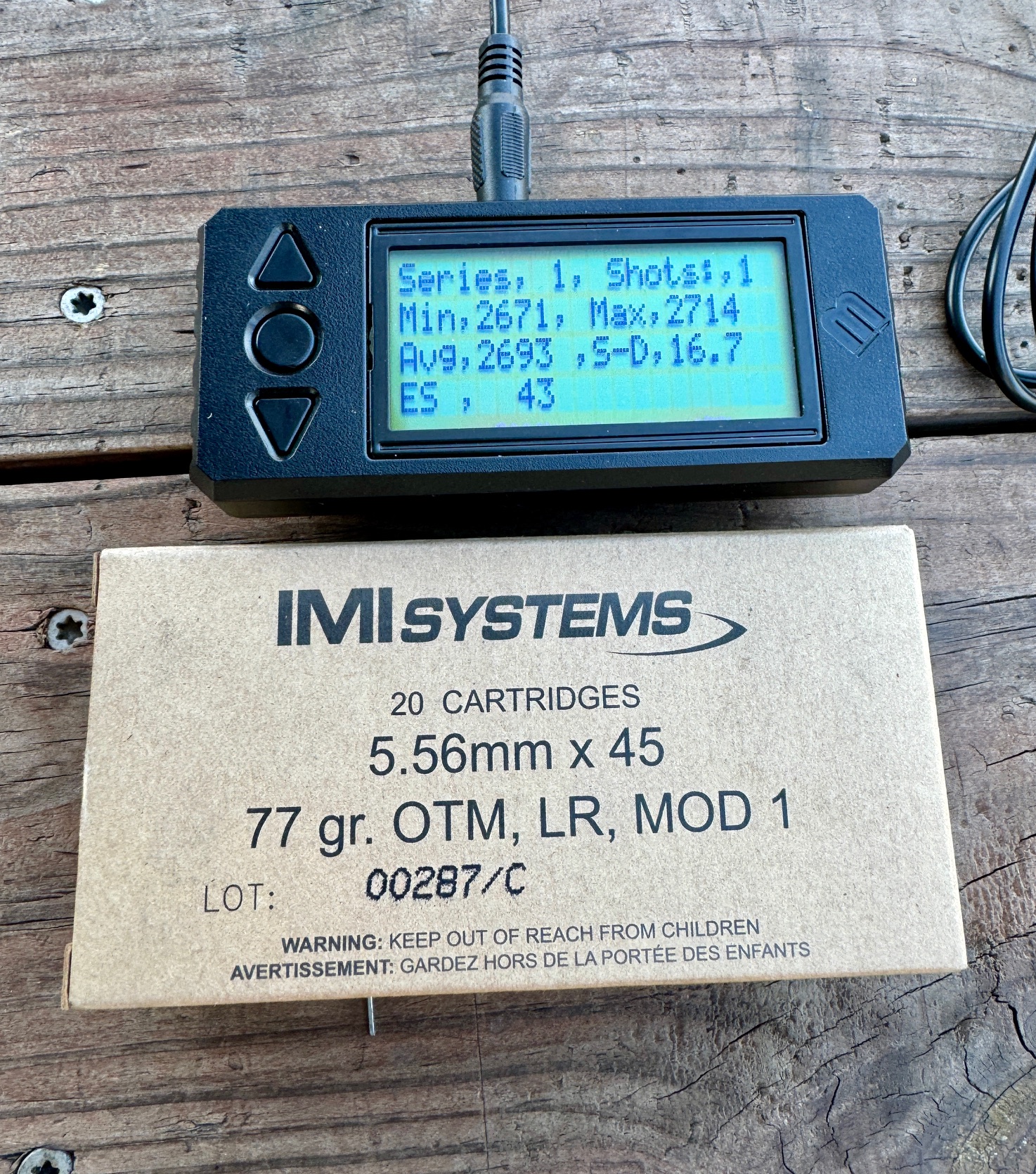

    This is how one lot of IMI chrono'ed for me in a 14.5" barrel with a 5.56 chamber. I've been having issues with this lot and was told this stuff generally doesn't like Wylde chambers.
    Appreciate the input sir- that's the first that I heard that the IMI doesn't like Wylde chambers but it certainly gives me a variable to explore. Thanks for the feedback!
