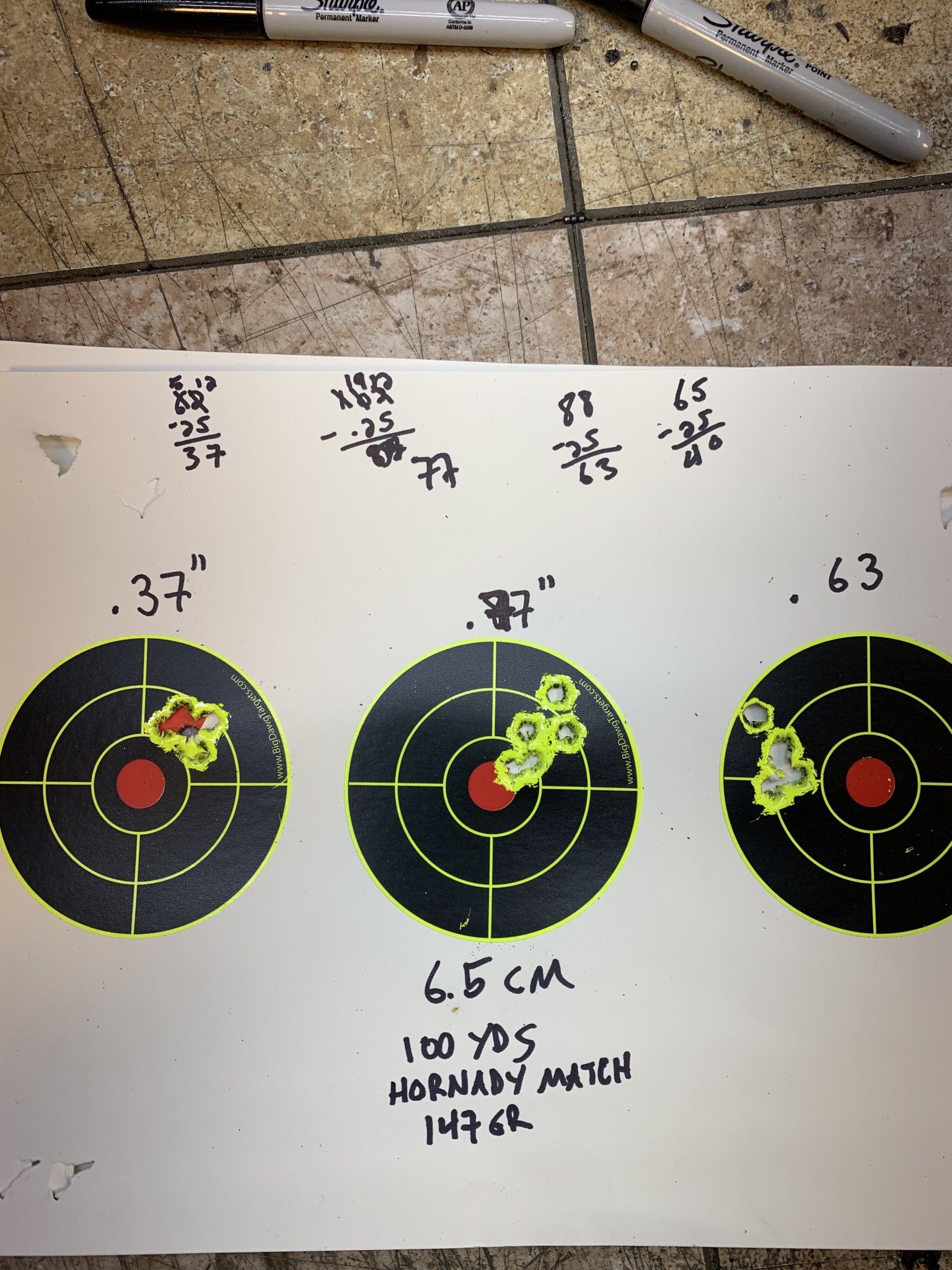

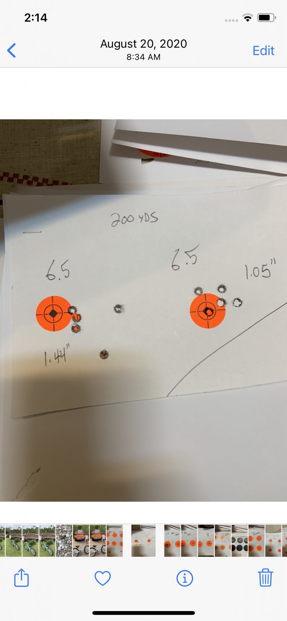

I got a 6.5 creedmoor a few months ago. Paid the expedited charge and got it in 3 weeks. 24” mtu contour prefit. Have only shot factory ammo and it really shoots good.
Reactions: 260284 and Clem

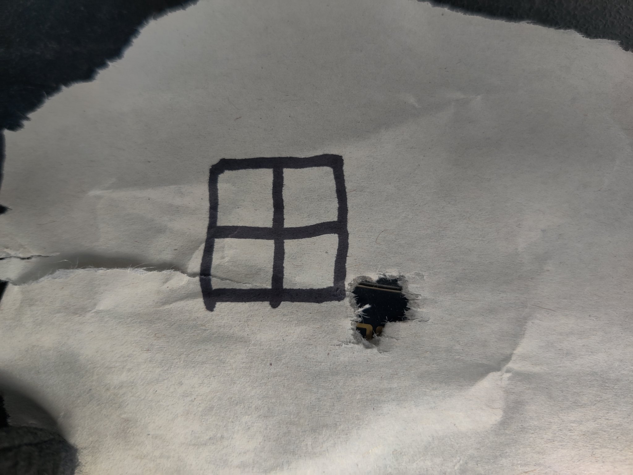

First shots after zeroing my scope on a .223 preferred barrel.
Not sure about their prefits, but this one got chambered by my Smith, and I have no qualms recommending their blanks.
