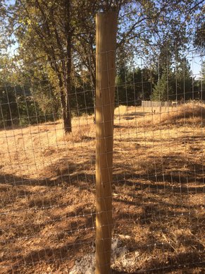

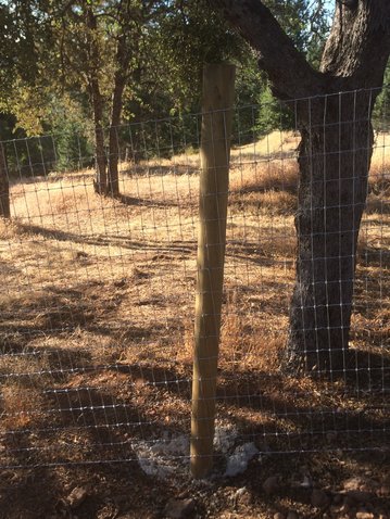

Posts are all plumb and look good. It just looks like crap in my opinion when the wire doesn't match.
You have to do little shorter sections to adapt to the contour. I have put up miles of no climb on my places. I have a love hate with it. Love how well it works when it's in and lasts a long time. Putting it in sucks. It doesn't stretch enough to roll with the contours. My new place is going to be terrible to fence. Lots of elevation change in a valley, and the creek going in and out.
That sounds like what I was afraid of.
Really difficult to get a picture.

I got lucky my current place is almost perfectly flat, new place is cool, but in a valley. You can run up/down a slope with a vertical post and the fence terminating at an angle. So the verticals will pretty much run perpendicular to the ground.
I don't know that wire and I'm not a fencing contractor. With wove wire (cattle wire), posts are plumb and wire follows contour of ground. Are they tying assemblies or is it just the wood post in concrete that keeps the fence tight? What keeps a high tensile fence (I don't know if this applies to your type of fence) looking good for years is the assemblies. This is especially important in rough terrain. Assemblies are needed not just on typical spacing, but also in contour transitions (top of hill, bottom of hill). If I'm using 6.5' 3.5" line posts, assemblies will be 8' 6" and tied with high tensile 9 ga wire.
