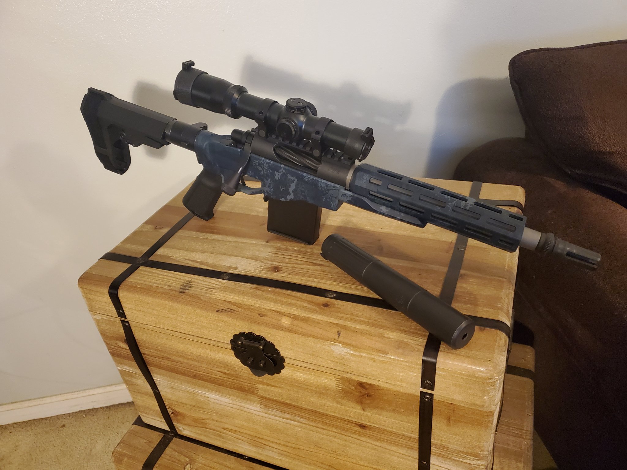

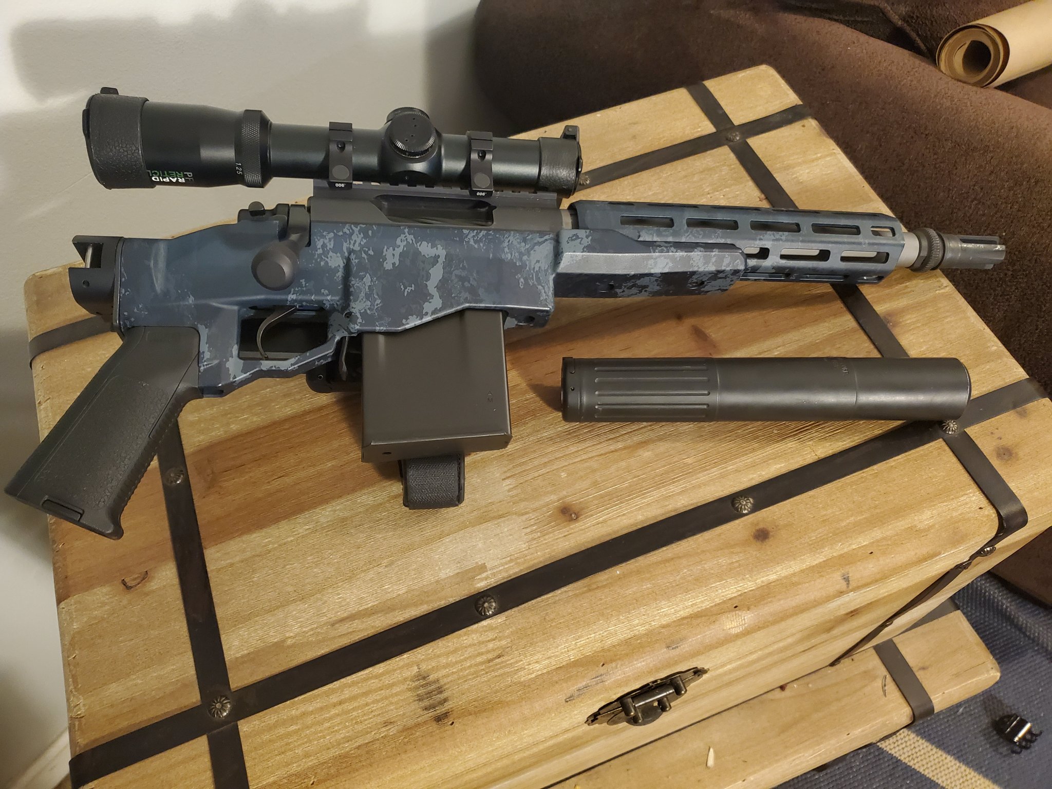

Any folding stock adapters that fold to the right?
Chingon
  • Apr 28, 2012
    1,080
    89
    47
    NOVA
    So I've got a bolty pistol rig and currently have a Hera folding adapter and I got to thinking, does or has anyone made a folding adapter that folds successfully to the right without any interference from the bolt lift? Has anyone modified one to do just so? I know Deadfoot makes an AR adapter that may work, but at 300 bones, would it work?

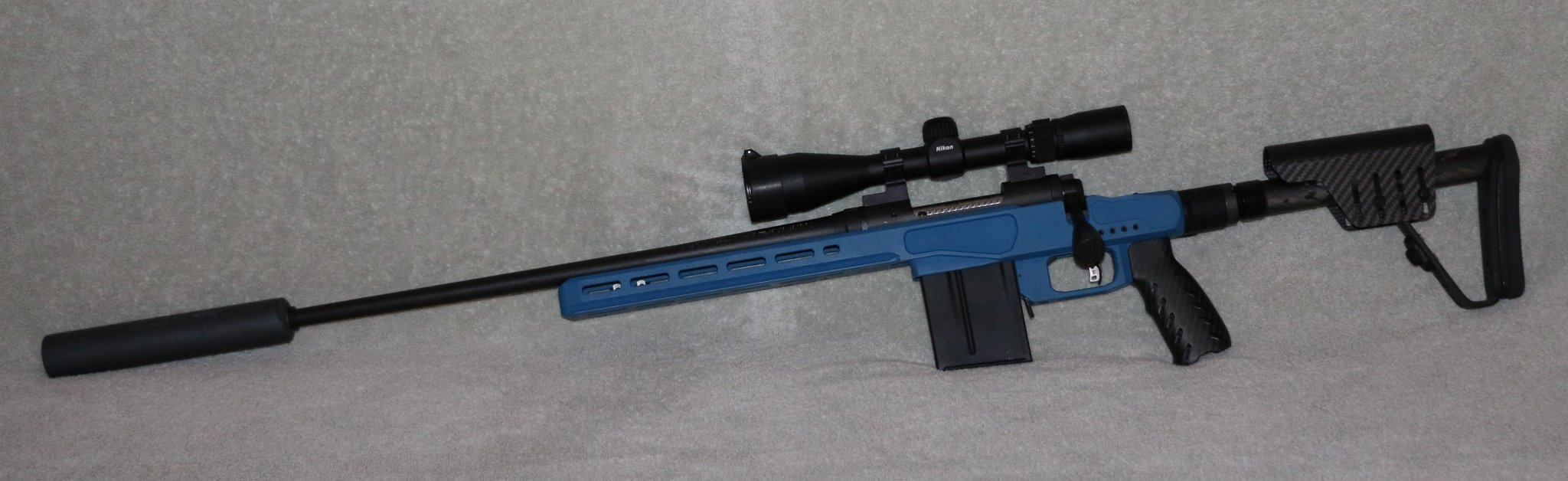

    Cool blaster! Yeah I don't think there is anything purpose built that you'll be able to know will fit without trying it yourself. You could try an MDT carbine to fixed adapter and then use their XTN interface folder which folds to the right and generally doesn't touch the bolt handle (at least not on any of my R700s and custom clones).
