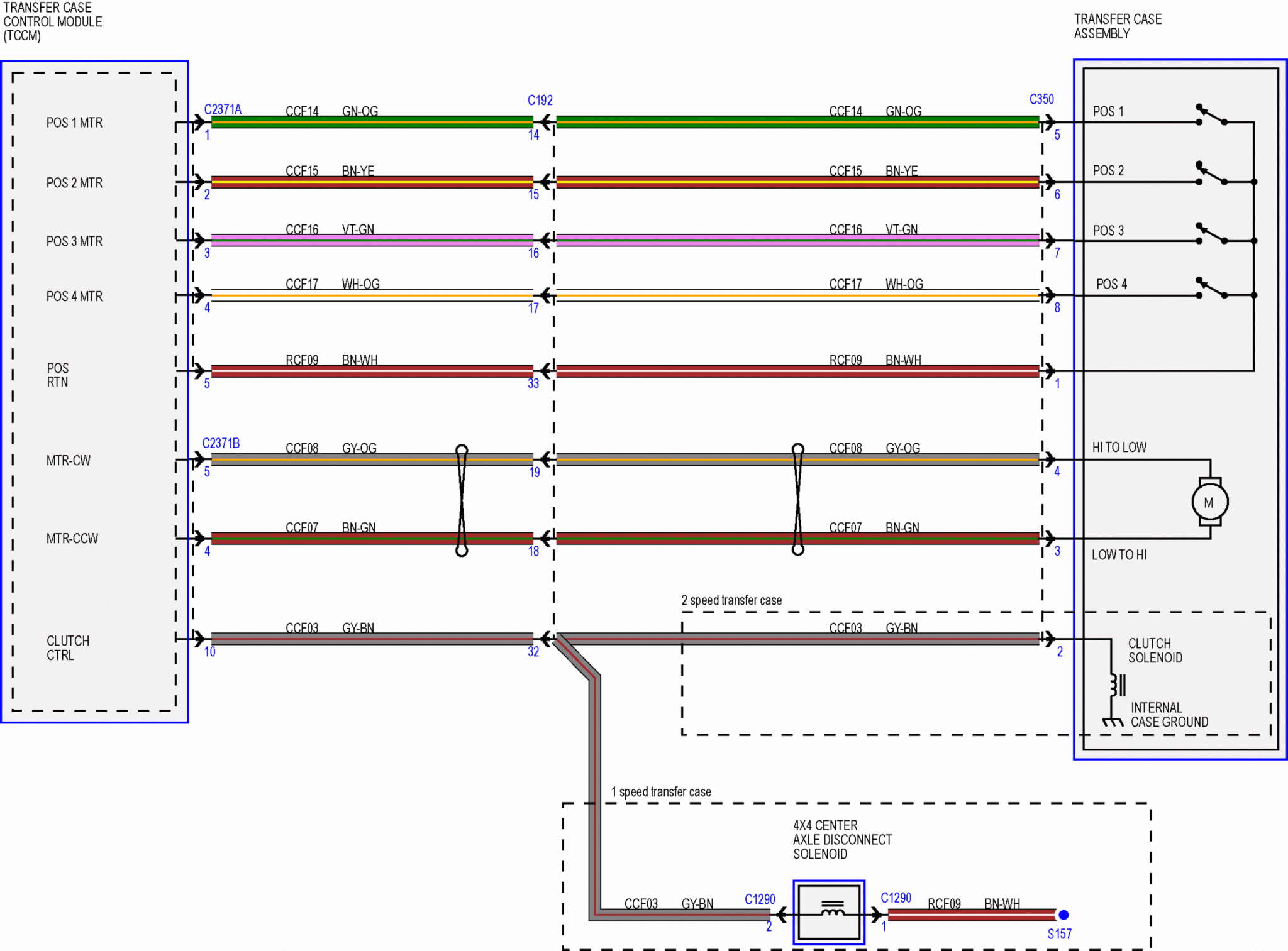

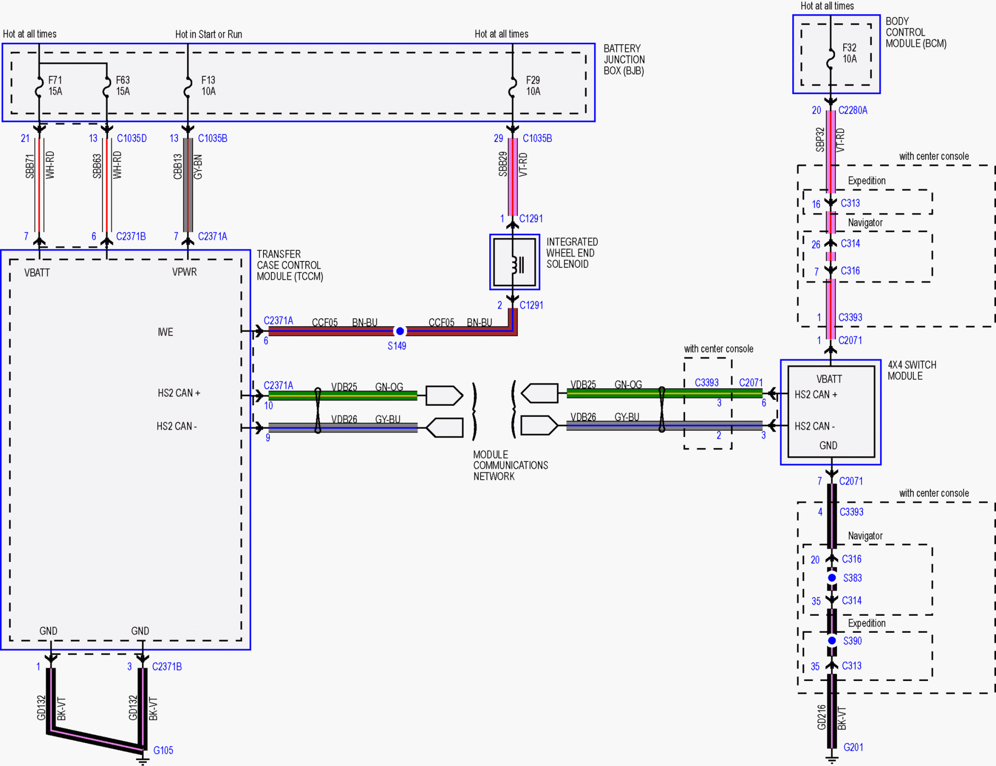

Do you have access to any wiring diagrams? Can you check connections at the 4wd switch and solenoid for corrosion, heat damage, or maybe even just a loose looking terminal in a plug. Do you have a multimeter and some back probes so you can hook it up to the solenoid and wiggle the harness and mess with the switch while everything is working?
The only wiring that I see related to the system is the plug that goes into the solenoid. I installed a new solenoid already and it didn’t remedy the problem. The wiring leaving the solenoid goes into a huge run of shrink tubing. Other than that I’m at a loss. The button to turn on my 4WD / 2WD is on my center console. There’s 4 push buttons there. Without cracking open that I don’t know how to get access to the back side of the switch
I do have a multimeter
Problems are usually not in the middle of a big harness. Its usually at a switch or plug, first place i would go is wiring diagram so I could check the wires on the switch. You are going to have to take it apart yourself or pay someone else to do it. You tube is your friend for getting unfamiliar plastic interiors apart without breaking stuff.
Lots of issues with the IWE solenoid. A quick YouTube search or Google will show you how to test it.
I put a brand new IWE solenoid in. And I still have the problem. The problem appears to be getting single to/from the solenoid. The plug for the solenoid appears clean with no corrosion. I have to figure out how to test the solenoid plug with a volt meter to see if the plug is transmitting to the solenoid properly

Just remembered this. If you remove the position switch from the dash and attempt to test it with an ohmmeter, it is NOT your std type switch. Each position will give a certain resistance reading like in the hundreds of ohms etc. I borrowed a Ford manual from one of the mechanics at my local dealer which gave me the different resistance values I should see, but I don't have that info anymore.
